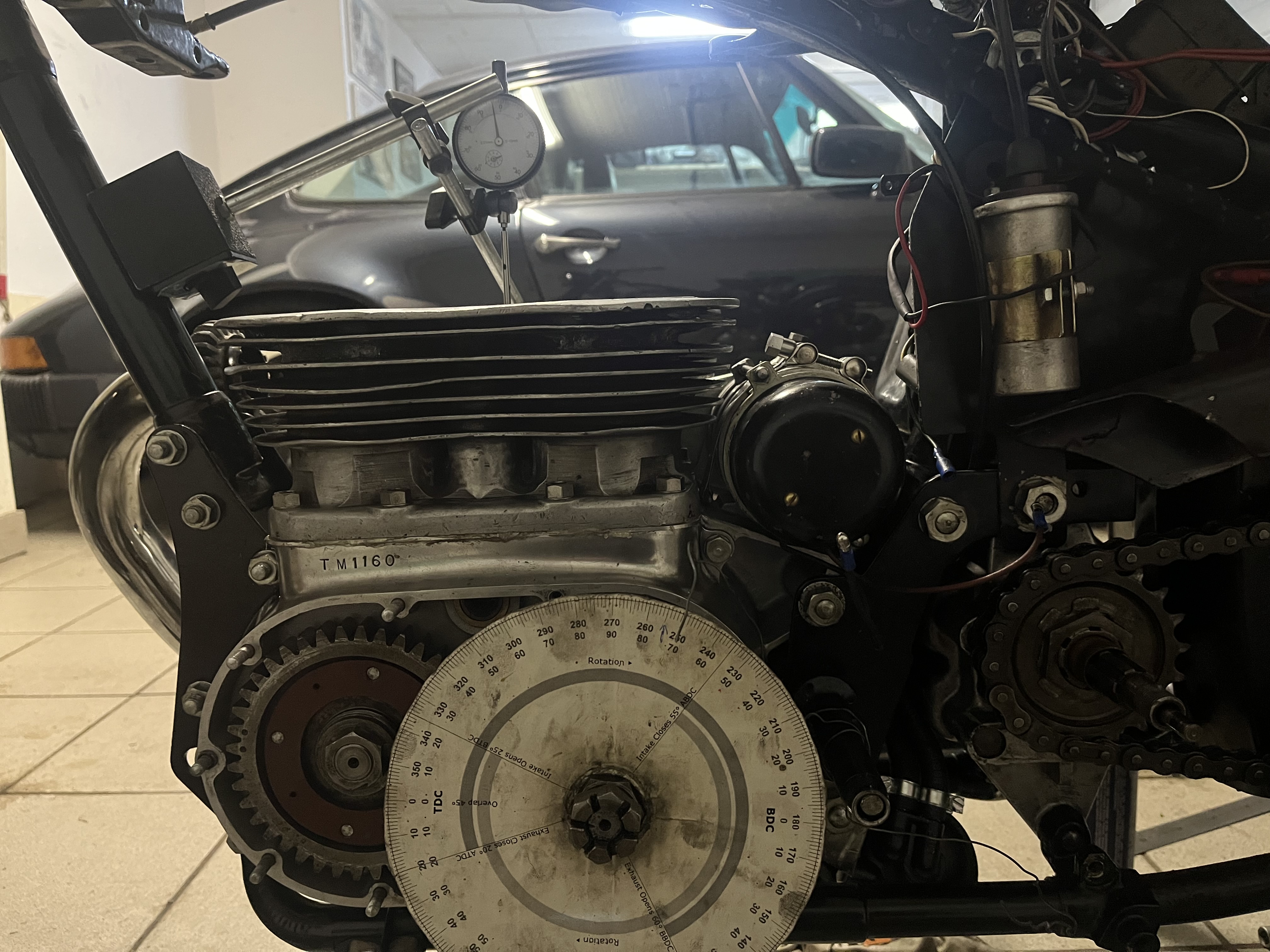

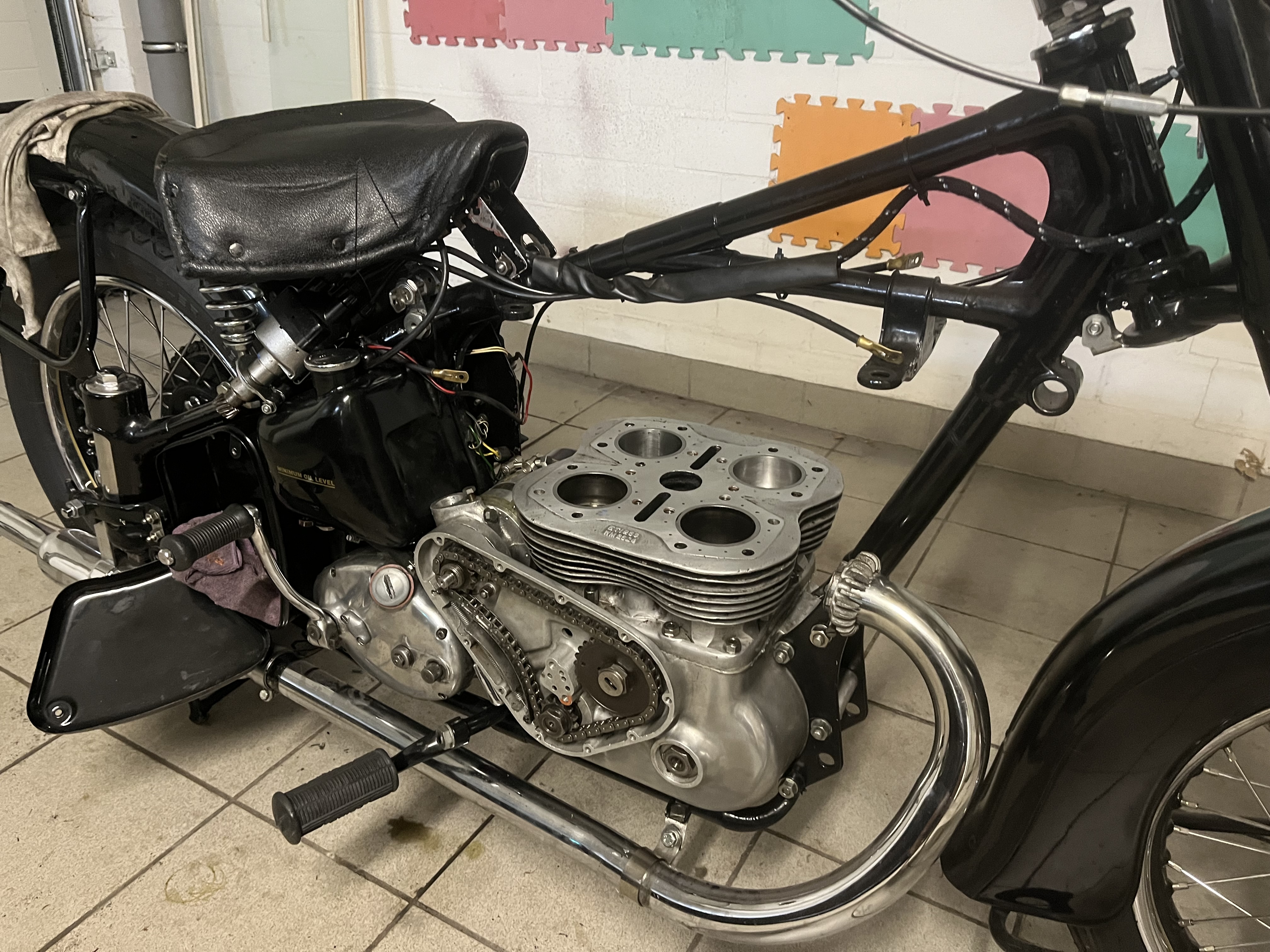

The bright side, if one can called it that, is that I just got so far as to bolt the case together and assembling the coupling gears… I’m currently still waiting for the barrel to come back from the shop. There is a picture of the current state a few posts back.

Reviving this thread to report on what I found and progress. It took me a while to get to it as I’ve haven’t had much time this year to work on my bike.
Anyway, as suspected the clearance between the plain bearings and the crankshafts were way beyond the maximum allowed. I had almost 0.5mm on the rear one! The front was better, but still above the max of 0.1mm (0.004”).
After getting new ones from Drags, I used the lathe to bore them out to give me just about 0.03mm clearance. I actually got a wonderful surface finish on the babbit which even surprised me.
After pressing them into the case, all the clearance was gone as they somewhat tightened, so out came the reamer. I reamed each one carefully until the required clearance was achieved, and in the end I have 0.03mm (0.0012”) on the front and 0.075mm (0,003”) on the rear. I was happy with the result as a hobby mechanic and with my available tools and measuring equipment.

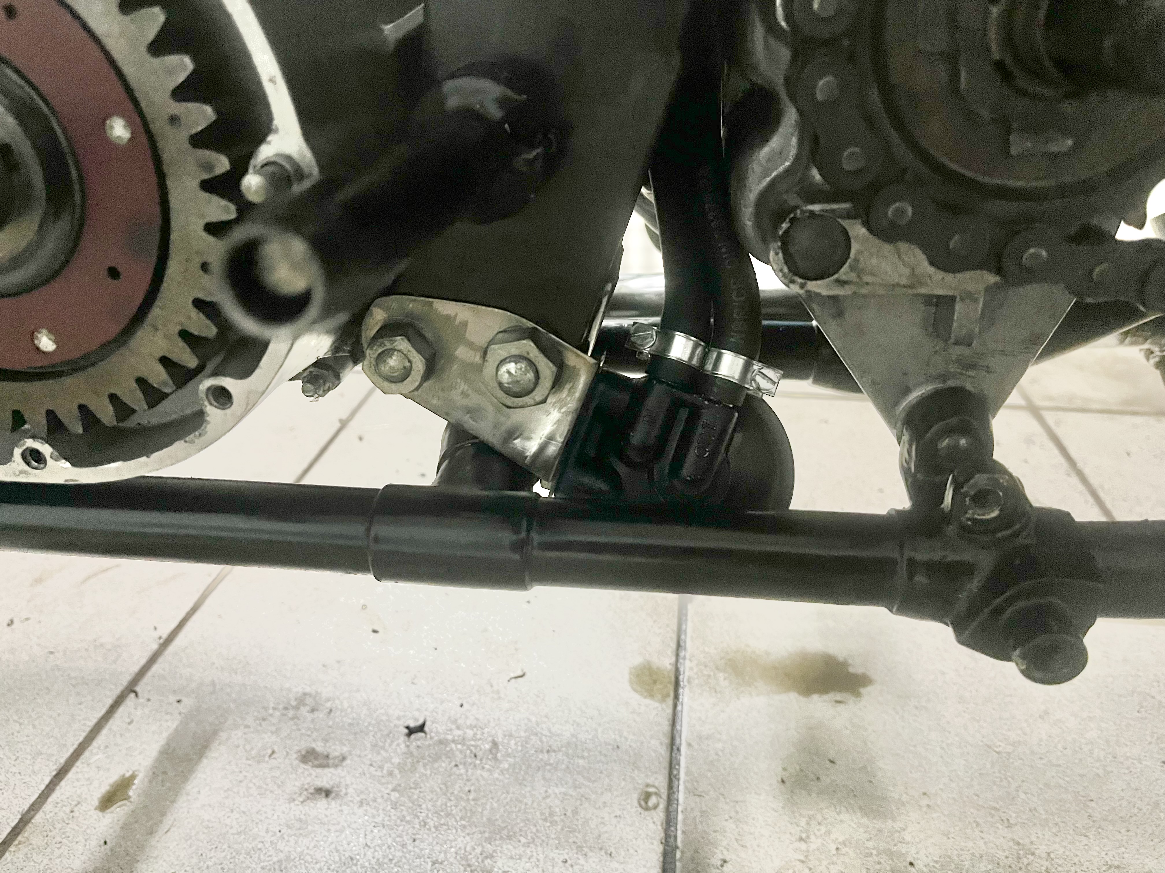

So now the bottom end is assembled and back in the frame. Took me two days to set up the valve timing which can twist anyone’s brain into mush, but also got that done. Also installed an oil filter, which I didn’t have before. Had to fabricate the bracket for it myself, and routing those thick hoses was a nightmare. There’s no space down there between gearbox, frame and engine!
So… coming along slowly.

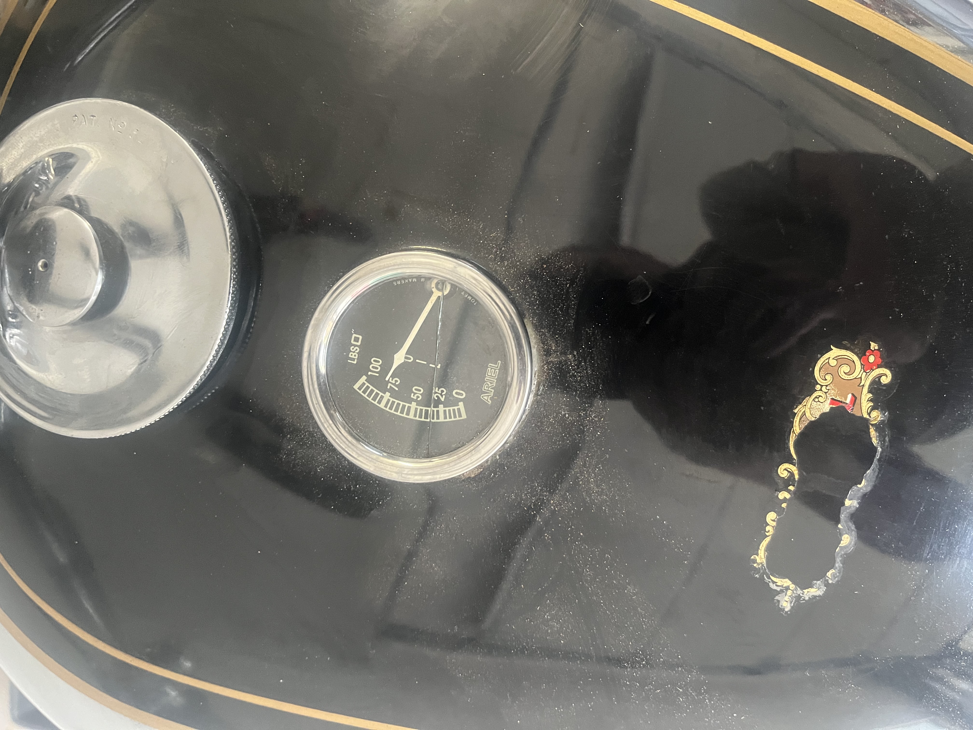

Well, the Sq4 roared back to life today. Unfortunately my joy was short lived as it seems all my efforts haven’t led anywhere.
I filled the oil tank with a run in oil 20w50. She started after a few kicks and settled quickly into a nice idle. I had one of the rocker box covers off to verify that oil was reaching the rockers, which it was. It was also coming back to the oil tank in a steady flow. The gauge showed an oil pressure of 80 psi, and so I waited for everything to get to temperature.
After some minutes the pressure started dropping slowly, but to my dismay once the engine was fully warmed up the gauge was showing 0 psi. It goes up of course if I rev the engine, but at idle it drops to 0. Also, the steady stream of oil into the tank continued, instead of reducing itself to bubbles and oil. So exactly the same symptoms I had before the engine blew.

From the videos, the pressure increases to 'reasonable' levels as you rev the engine. I wonder what engine speed corresponds to the better readings. I have often read (not specifically about Square Fours, mind,) that an oil pressure equating to 10 psi per thousand rpm when running is considered to be acceptable.
I would be tempted to run the engine on the stand in top gear and see what the oil pressure looks like. At least, by trying this, you're avoiding the possibility of a problem on the road.
This still doesn't answer the problem of a zero reading at tickover, of course.
