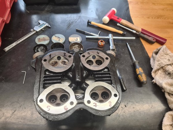

most valves seem to be fine. two seemed damaged to me, so I replaced them. I sand them with a paste and fold the upper divorce
- Karol Burger
- Posts: 1198
Re: Ariel 4F/600 - 1932 engine
I have ground the valve seats, assembled the springs and will wait for your advice on whether I can keep the camshaft bearing covered or whether it is necessary to remove the ball cover.
