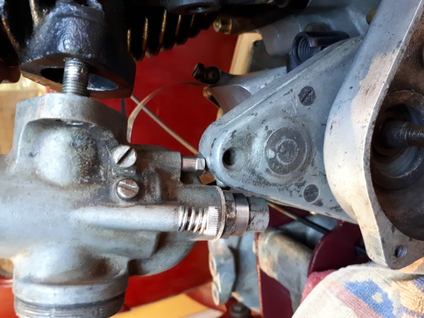

FITTING A MONOBLOC CARB
When I offer up my Monobloc carb to the VB barrel the cover nut for the pilot jet hits the top of the magneto and even if it was shorter, the cover nut for the main jet would still prevent the carb moving closer to the cylinder barrel so the carb retaining nuts could be fitted.
What's going on? I ran this VB with this carb for years using (I think) an ordinary gasket between the carb and cylinder barrel. I've got to be missing something very simple! Otherwise I'll have to make an extension piece like Steve Carter uses.
MikeN.
MikeN.

Re: A corner for VBs (and other sidevalves)
You will need a spacer for the carb,9 only the pre monoblock came with a long neck to clear the dynamo
Yes. I've come the same conclusion, Dave. But for the life of me I can't find the one I must have had (and can't even remember it) so I've a bit of pipe chucked in the Myford and I've hacksawed some bits of plate to drill and bore for the ends.
Hay ho, MikeN.
Hay ho, MikeN.
I had the same problem in finding an inlet tract for my VB I eventually made one up using two flanges that I found on eBay item number:174789689001 and I turned up a tube to separate them to suit the VB. The parts have been assembled with a high temperature epoxy that is recommended for use on exhaust maniolds.
