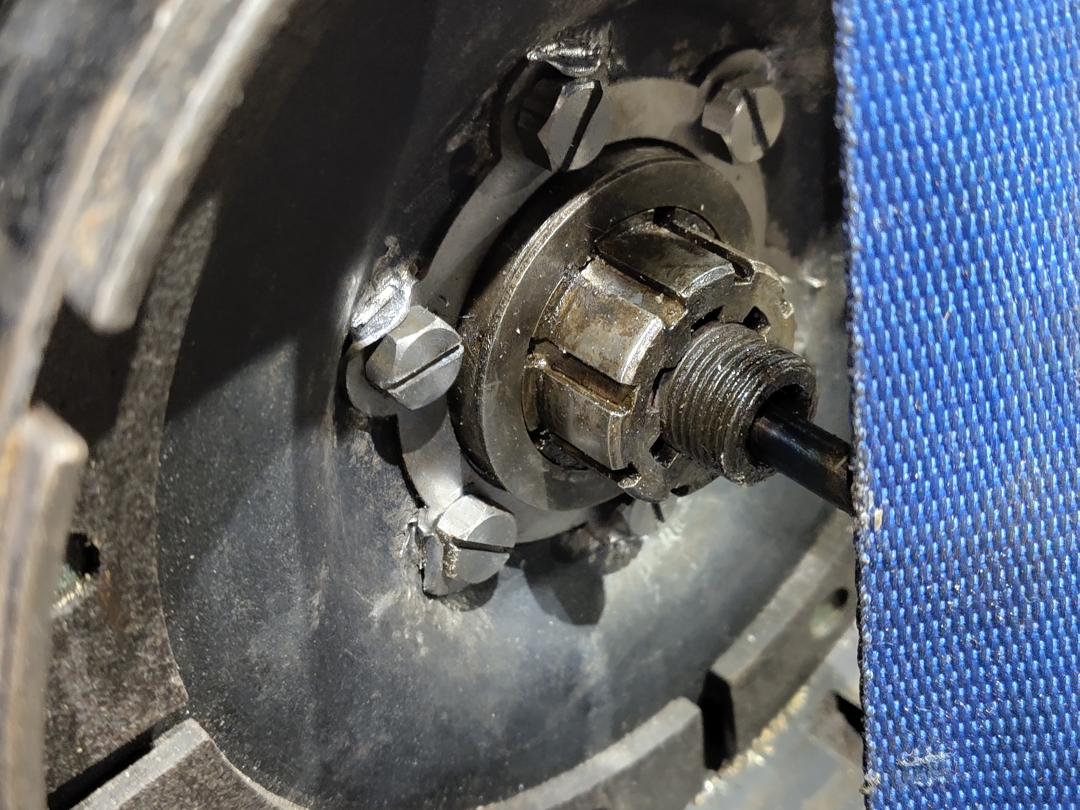

Having watched your video, I can see that the nut appears to be jammed on the thread, and is not fully tightened. See picture.
The end float of the shaft should be minimal. Mine is 1/16 inch. The nut will have to come off to investigate.
- Posts: 1955
Re: Vh500 clutch
The correct nut has a recess to allow it run all the way the the end of the thread on the mainshaft, unless your nut has been modified it won't have that. If in doubt by the correct parts from the club or Draganfly!

Re: Vh500 clutch

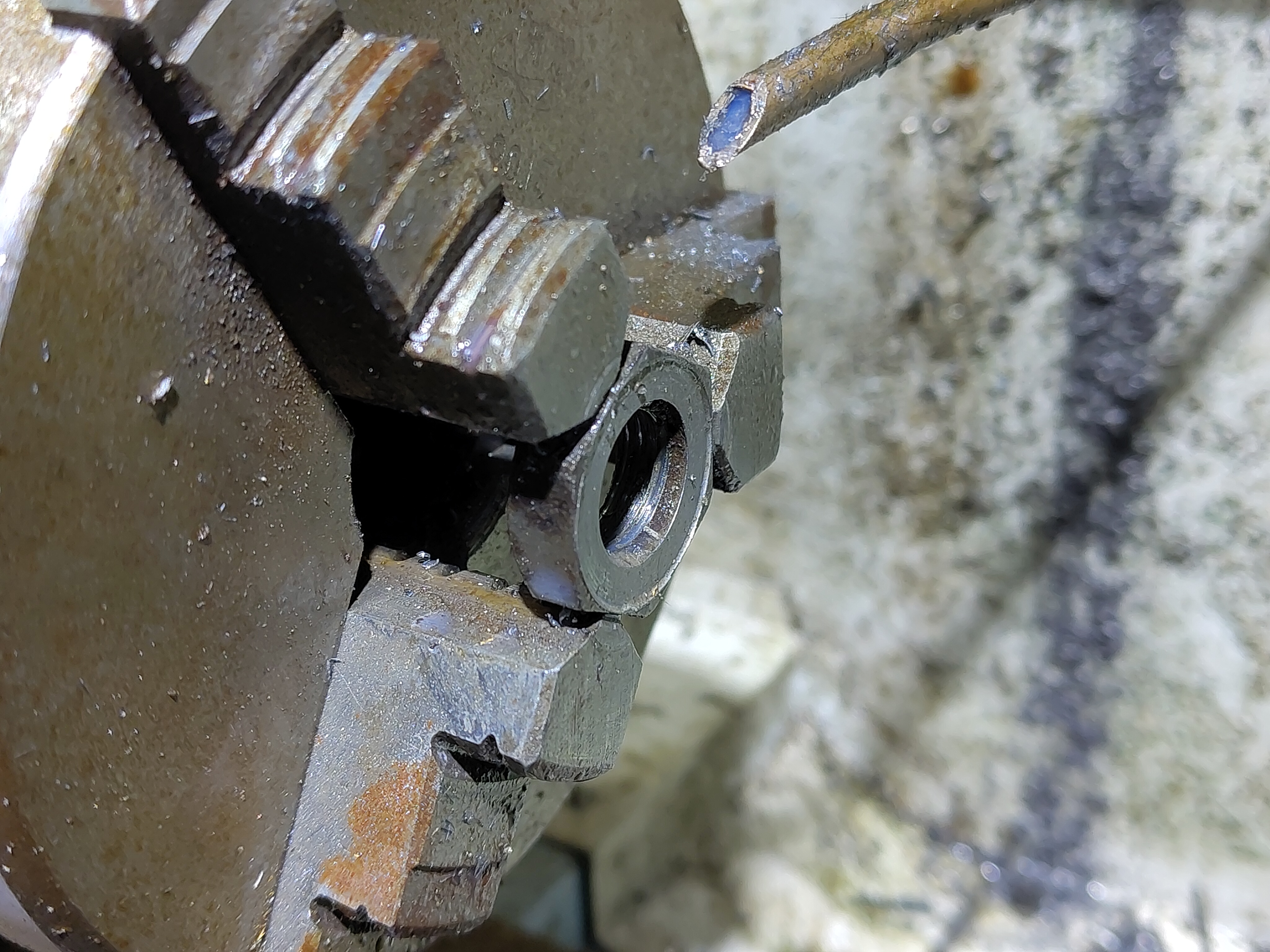

Thanks for that Roger. I've just removed my nut and found no recess; which explains my slightly excessive 1/16 inch end float.
Now where is my lathe. Cheers Chris.

Should be just the first 2 threads bored out to the nominal diameter of the thread, Although what Simes has done would work, however I would make the recess with a smaller OD.

Here is mine after fettling. When I refitted it,I found that the gears were very stiff to turn and there was no end float. It took a while to realise that the inner end of the ratchet spring had somehow become lodged between the ratchet pinion bush and the ball bearings inner race.
All sorted now, with Loctite, and a much better 1/32 inch end float. Sadly I'd already done it before I saw Rogers last post.
