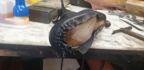

Stretch the upper over the last, with pins holding in place before glueing

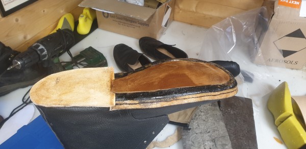

Finshed glueing onto the last before sewing the welt

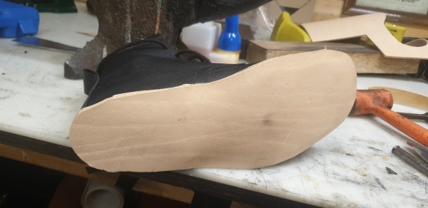

I've stuck the outer sole on now have to sew through the welt into the outer sole

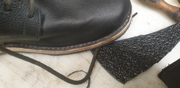

Row of stitching through the welt into the outer leather sole

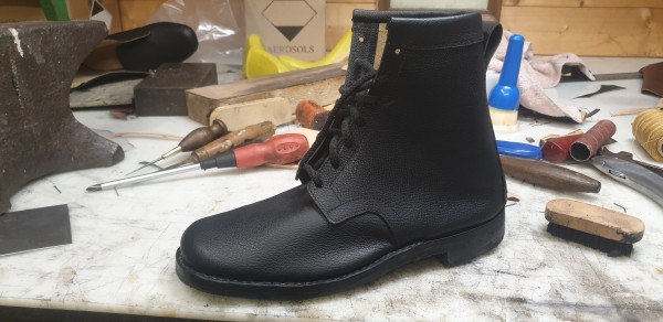

Then I stuck some 6mm rubber on the sole and then stacked up leather to form a heel. That to is topped off with 6mm rubber
Finshed
Finshed
