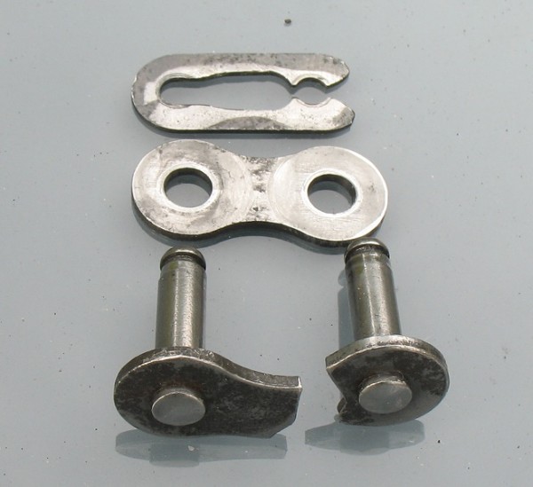

I've only had one chain break on me...rear chain on a Matchless. It broke on the solid side of the split link (below). I hadn't realized that it had broken until I got home and investigate the occasional nasty noise coming from the back as it sometimes caught a tooth on the rear sprocket.
I spoke to John and Jane at Sprockets Unlimited and they said they always break there as its the weakest point of any chain with a split link. The solid side is always flexing slightly because the other side is not rigid. Makes sense.
Paul

if the loose side link is tight on the pins ,there will be no flexing.....so regular replacement of the link with a new quality part will obviate the failures.....the problem with bicycle chain size is most of whats sold is cheap rubbish ,suitable only for kids bikes,and its quite difficult to obtain a quality chain .

IF there's any friction in the pins (and there usually is under load,) the link will only take that load on the fixed side. I've always thought of it as only a tension issue but that's not the case. The ARIEL set up has a less than ideal number of teeth, which accentuates the problem.. Generally it's up to the job, but the later Matchless/AJS chain would be an improve. Nev

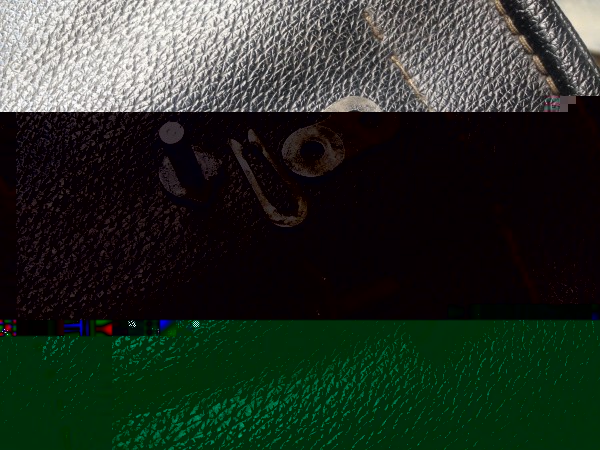

Snapped split link Galore !
At the BOM rally this year
