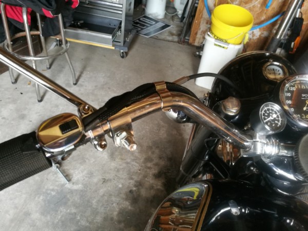

And today the first run down the road and back. Everything seems fine. Had to adjust the position of brake clutch levers on the handlebars as well as the lever for the gear change. The speedo is not working quite right, as if it’s a bit stuck - needle moves but snags and sometimes stays stuck in one place. The clutch was slipping a bit so had to pull the cover off to tighten the springs, which meant the whole battery and tray had to come off first, the exhaust and the foot rest and the foot brake. Everything so full on this bike that nothing is easily accessible. Probably have to wait for next weekend for another try.
Gui

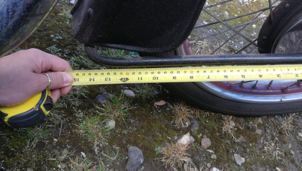

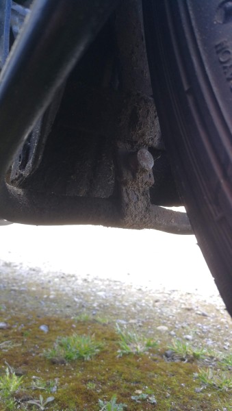

Gui,Gui.dorey wrote:Got it.
There was a fibre washer already under there, but I added a second one just to try it out.
The front stays measure about 29mm from the fastener‘s centres. Here‘s a pic of the front stand‘s attachment. However the angle of the mudguard is set by the center stay between the fork legs isn‘t it?
I got your PM, and measured my front stays, which are 27 cm centre to centre. The centre stay is the same as yours - 10 cm from the rolled edge of the guard to the stud centres. Incidentally, I measured my front stand too:
Also, I took this one:
This shows the tab on the front stand is bolted to the rear of the mudguard bracket - I can't quite make out how yours is fitted, maybe the other way round?
Hope you find this useful.
Re: Square Four MkI restoration complete - almost....
Hi Simes,
Thanks very much indeed. I gave you the measurements in mm but it should be cm of course.
I do seem to have something wrong. The central bracket is then correct, and the front stand is attached like yours. However my front stand is shorter than yours - 34cm - and the front stays are longer - 29.5cm.
