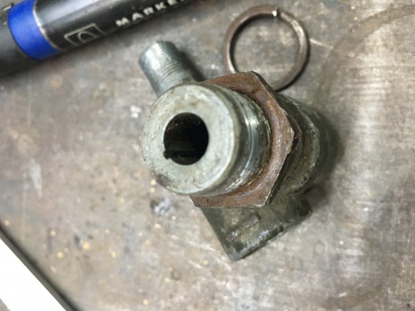

Re: Speedo gearbox question
Reviving an old topic to help me understand what I have (rather what I have missing).
So I’ve got myself a nice WD Smiths speedo for the WNG, had it serviced by Russell and now I’m itching to get it on the bike and see it working as it should.
My problem now lies with the speedo drive gearbox,
I’ve got the 43T on the drum and was missing the 14T drive sprocket which I now have too.
Now I notice I’m missing the shaft (???) that the 14T sprocket rides on. Don’t know what it’s called as it looks part of the gearbox on my parts list book.
Can anyone tell me what this missing part is called please so I know what to look for.
Better still, can anyone suggest where I might find one??
Thanks

- Posts: 5576
