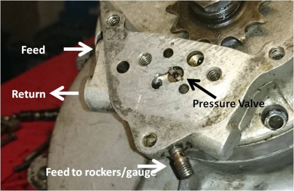

Mark..If you have a read through this post :
http://forum.arielownersmcc.com/viewt ... lve#p24338
it should explain what you have / should have
The image below shows the case you have and the valve in question is circled. As discussed earlier my understanding is that its purpose is to provide pressure in the oil gallery which feeds to the gauge (and the rockers when they are fed from the pressure side of the pump).

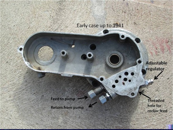

Mark, does this make it any clearer?
This is the earlier case:
Timing case up to 1941
This is the case you have, 1941 onwards
Timing case 1941 onwards
The pressure valve is a press fit in the hole in the case, there are no threads. It consists of a spring, a ball bearing and the seat which presses into the hole. The parts required are on the Draganfly page quoted in my previous post.
Your gauge supply stud should have a hole down the centre of the stud and two holes across the stud at the point where it is relieved. Drags can supply this, it is listed on the linked page
I am a bit confused as to your rocker feed pipe, the one with the tap / valve on it. I thought you previously said the rockers had grease nipples ?
Hopefully someone more knowledgeable will chime in but I think this pipe may be a feed for the valve guides as your photo shows it leading into a union on the top of the head.
Alan
