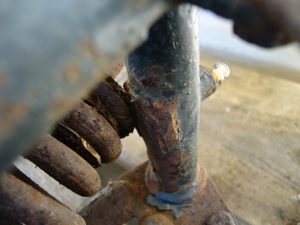

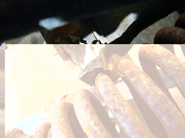

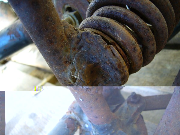

ismohautala wrote:Someone has changed spring position from expanding to compressing
Wrong, the factory did this.
ismohautala
Posts: 55
Joined: Tue May 15, 2012 2:36 pm
Location: Finland
Re: Ariel 1929 F
Post by ismohautala »
Hi Adrie
I think these cut offs and weldings are not factory made ;)
Ismo

adrie.degraaff
Posts: 3309
Location: Holland
Re: Ariel 1929 F
Post by adrie.degraaff »
Your right offcourse, this is a bad conversion.
In 1930 - 1931 the factory sold Ariel's with connections for both springs, there are peaple who are grinding these off thinking it's wrong.
