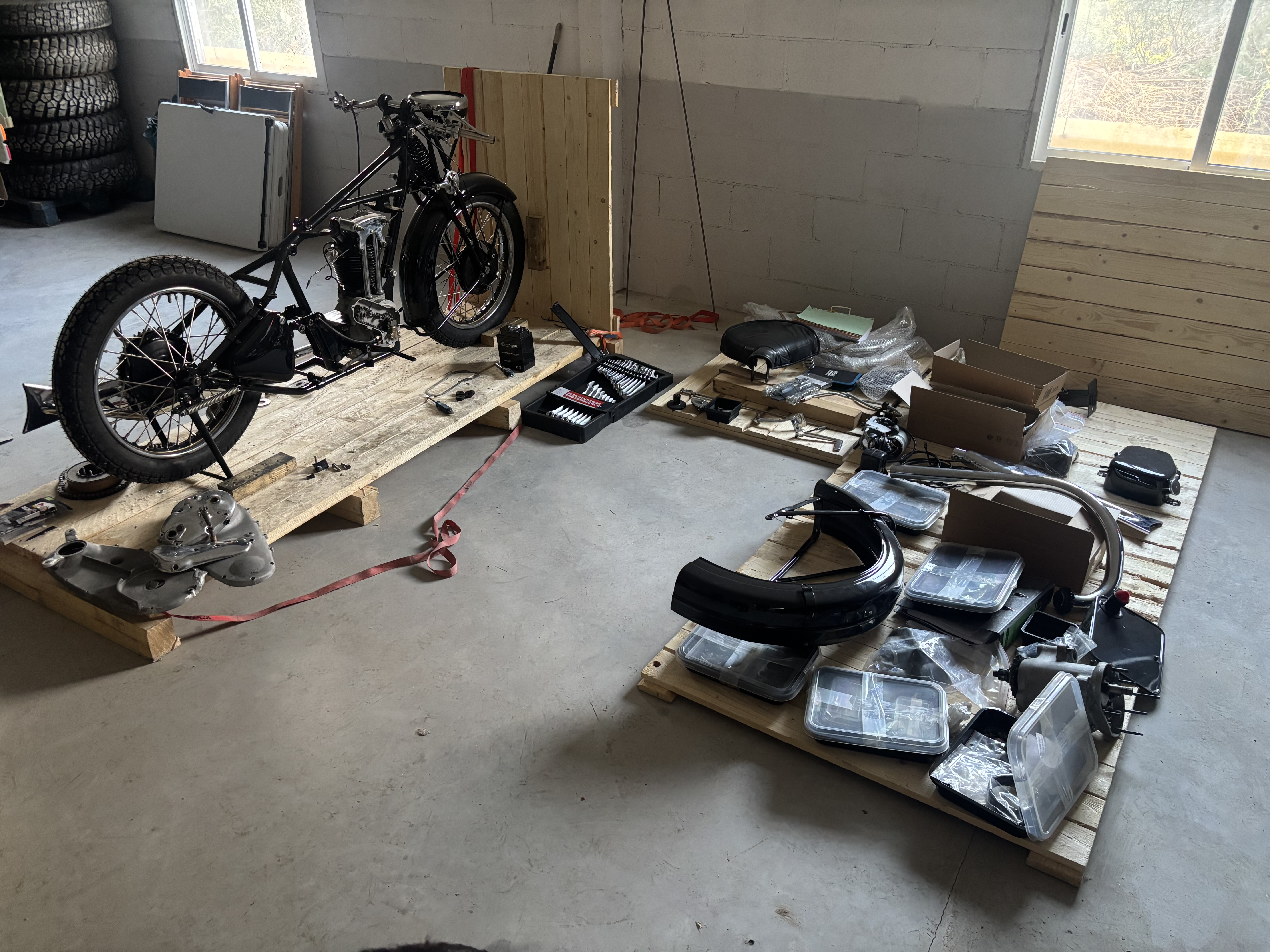

Hi all, today we stripped down most of the mechanical stuff. I won't be disassembling the engine block any further as it has been refurbished by some professionals already from the previous owner, oil pump upgraded, so looks really promising.
I will next have a look at the gearbox and all the rest of independent components.

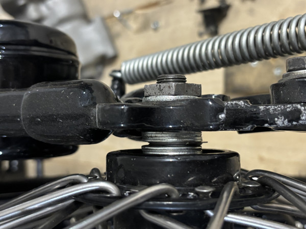

There's a few things on the bike which im not sure how to finish off.
One of which is the rear wheel bushings. The previous owner placed these washers to get it to place, but any recommendations on getting the final bushings done?
I have an old lathe in the workshop, so I think i can machine something, but just wanna make sure i'm not missing anything out here.
