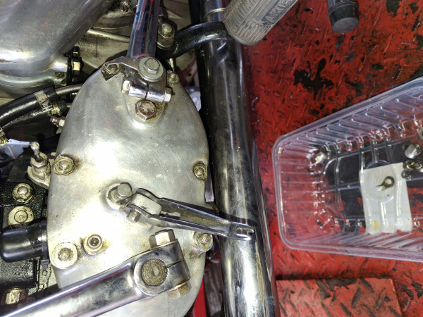

That doesn't look like the right main shaft nut to me, and it certainly shouldn't be moving like that.
The picture below is not particularly brilliant but if you zoom right in you can see how the main shaft (this is the BA on my Square Four) protrudes beyond the nut.
What I would do now is gingerly remove that, and get on the phone to AOMCC gearbox spares and see if we have a new one.
Did you check the clutch centre nut?
