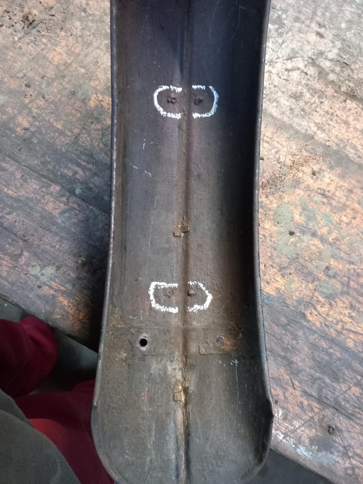

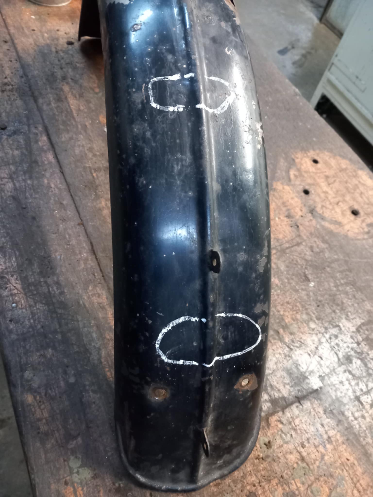

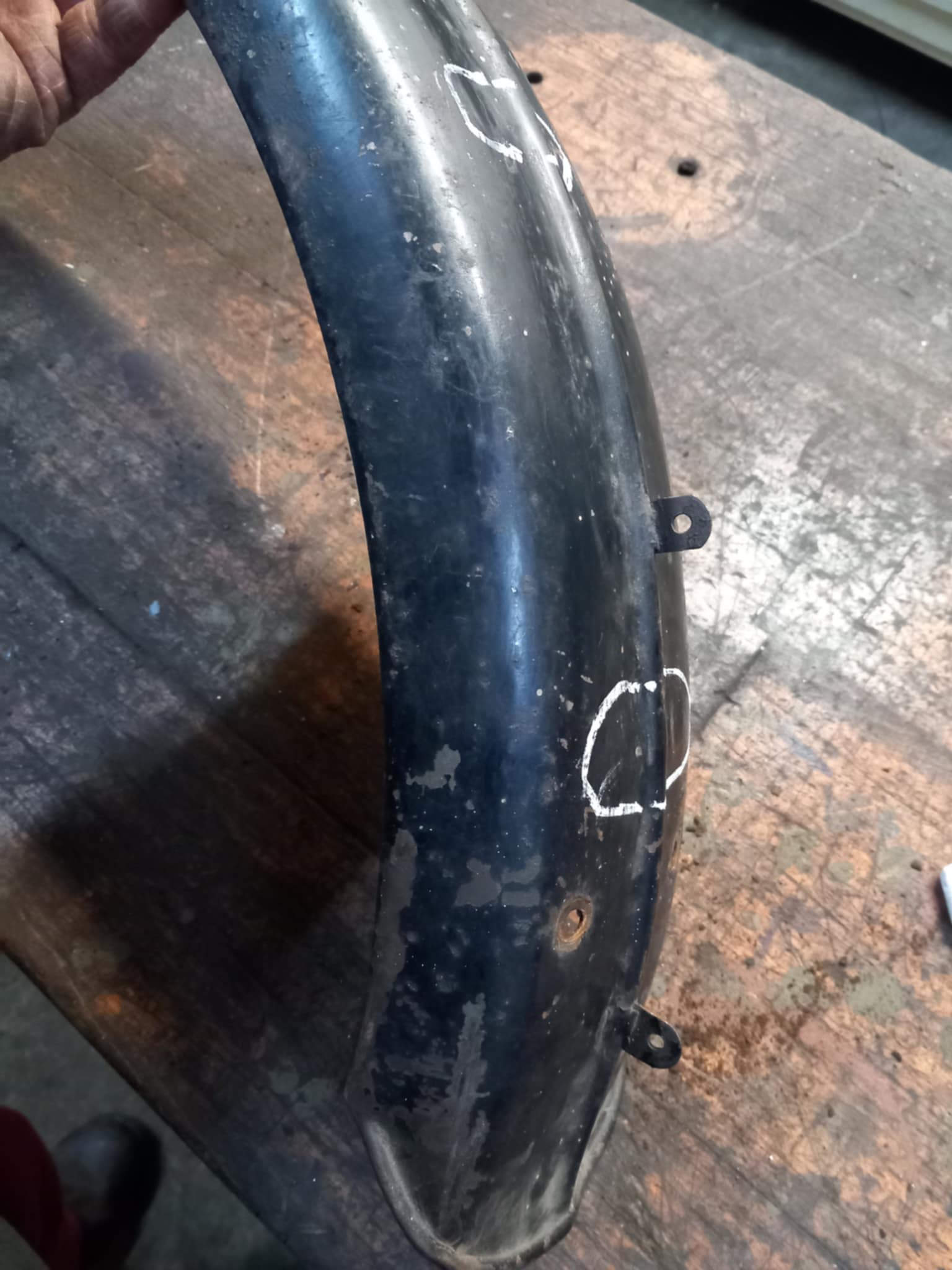

On the front fender, on the outside, there are license plate brackets.
Inside, other holes have been filled.
My question: which part is still usable? The existing brackets? The four filled holes? Or neither?
