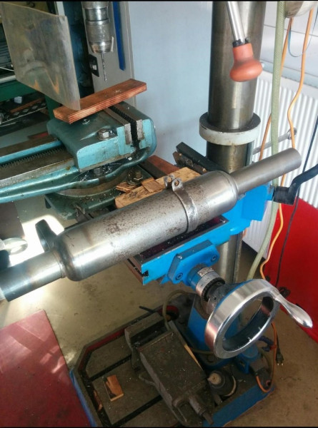

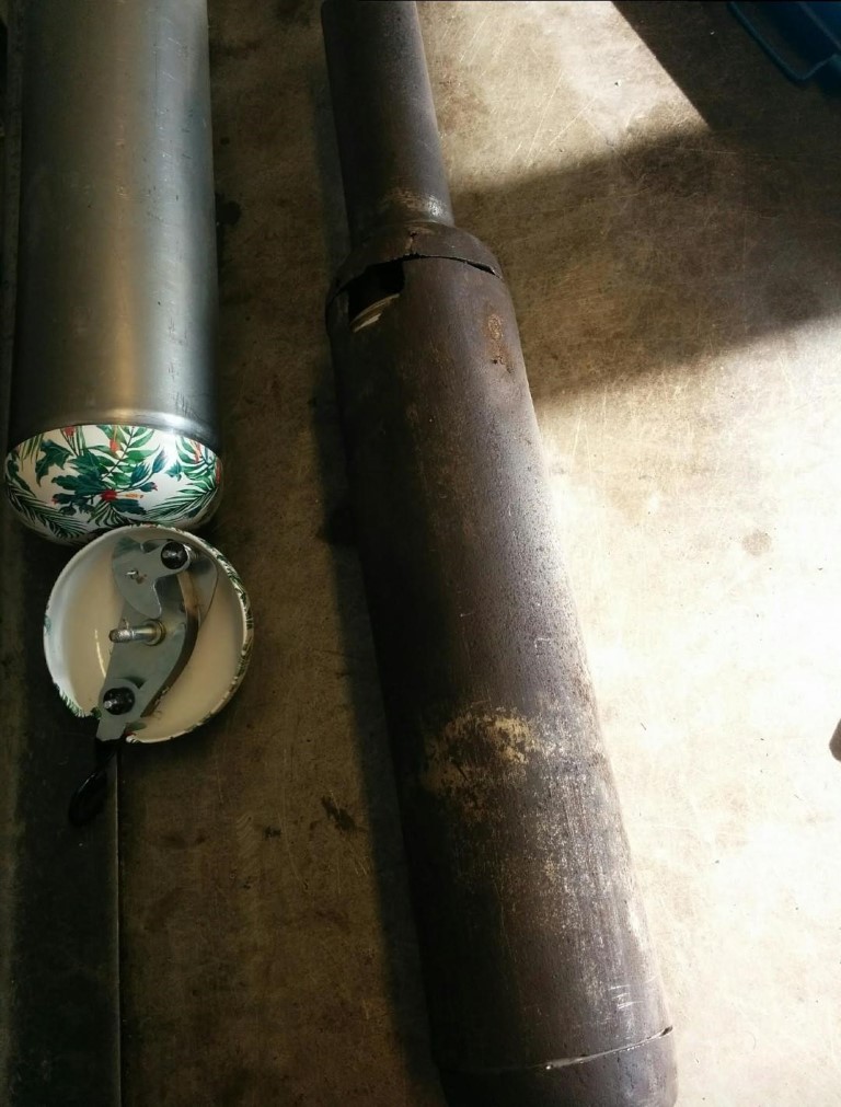

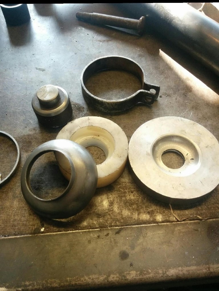

The muffler is something interesting. As much as I don't like the way the previous owner restored the bike. I have to say that they did a great job on the muffler. Its handmade using a press and a bicycle bell. It looks good, but pressurewise it might be a problem, any way to check this? My girl knows when to put coffee on the table 5 minutes before I arrive, it's loud!

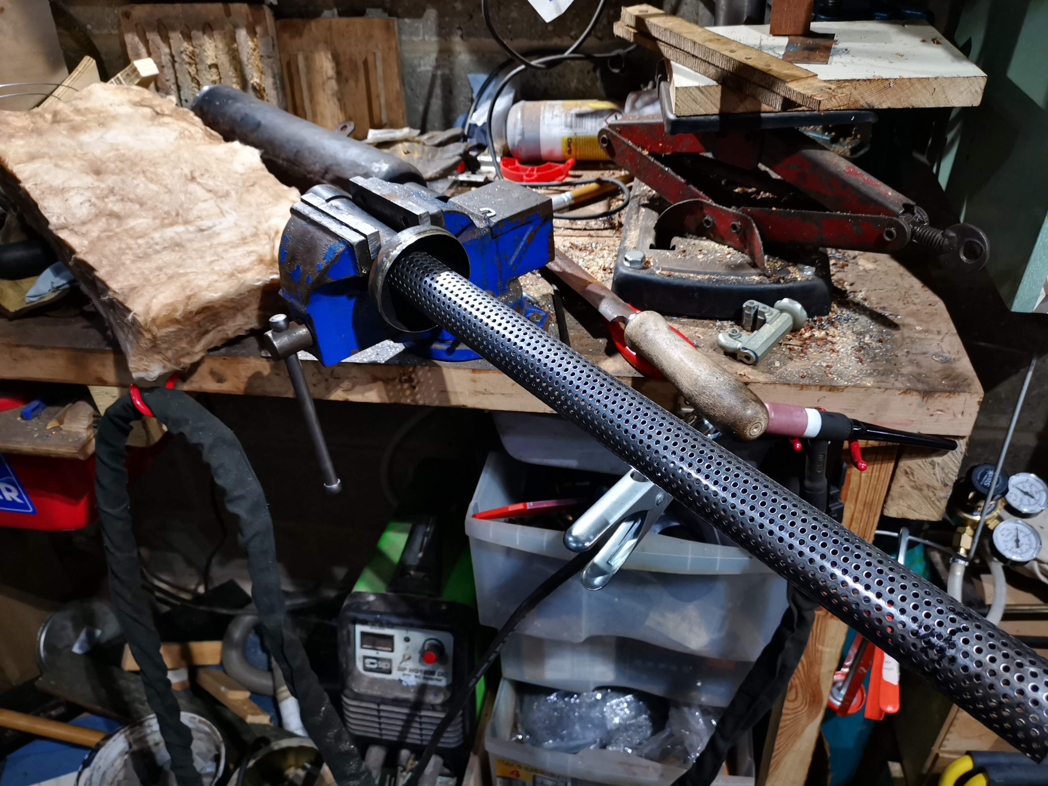

There shouldn't be any back pressure - it's an absorbtion silencer, there are no baffles. Basically a long piece of perforated tube wrapped with a blanket to absorb some of the pressure pulses. They do work!
