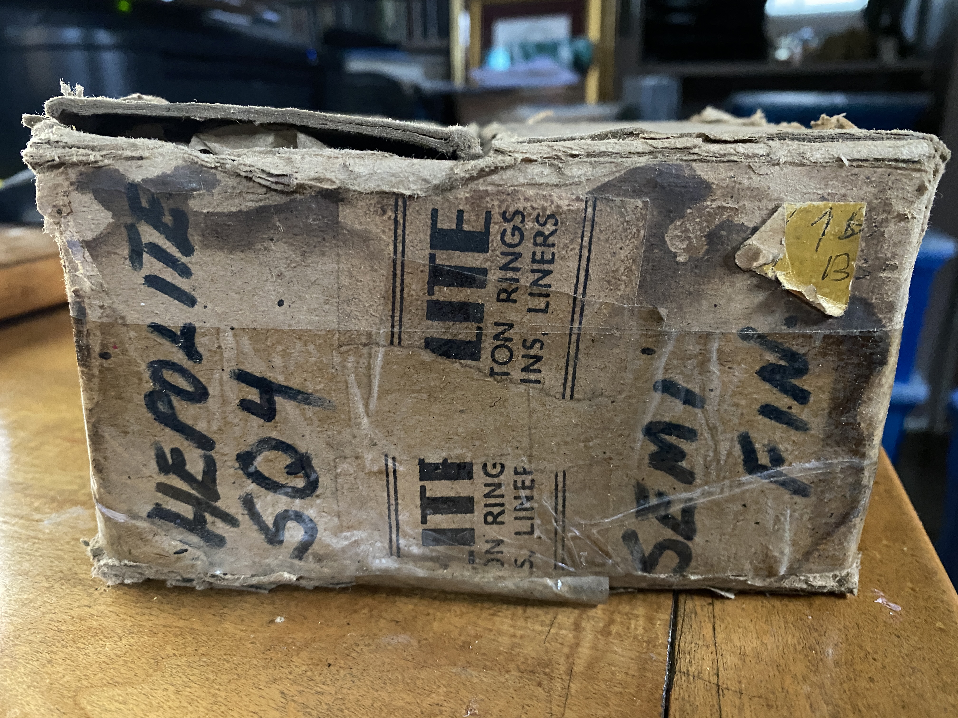

I am now getting to the point where I am starting to think about doing a prebuild with all the parts I have accumulated for my 1948 Sq4 project so I can identify what I have got, not got, and what I have got, but which is either wrong, questionable, or not useable. I have a set of barrels (with only one broken fin :shock: ) that are marked '+30' that likely need boring. I also have a set of new low compression pistons that are marked as 'semi finished' and 2.650. I have not come across semi finished pistons before - any advice regarding their use would be welcome.
Posts: 2113
Re: 1948 Sq4 basket job - help!
I have seen but never used semi-finished pistons but they are what they say are! They will need to be oval and taper ground to size before use. I think you will find that they are presently round and parallel.
