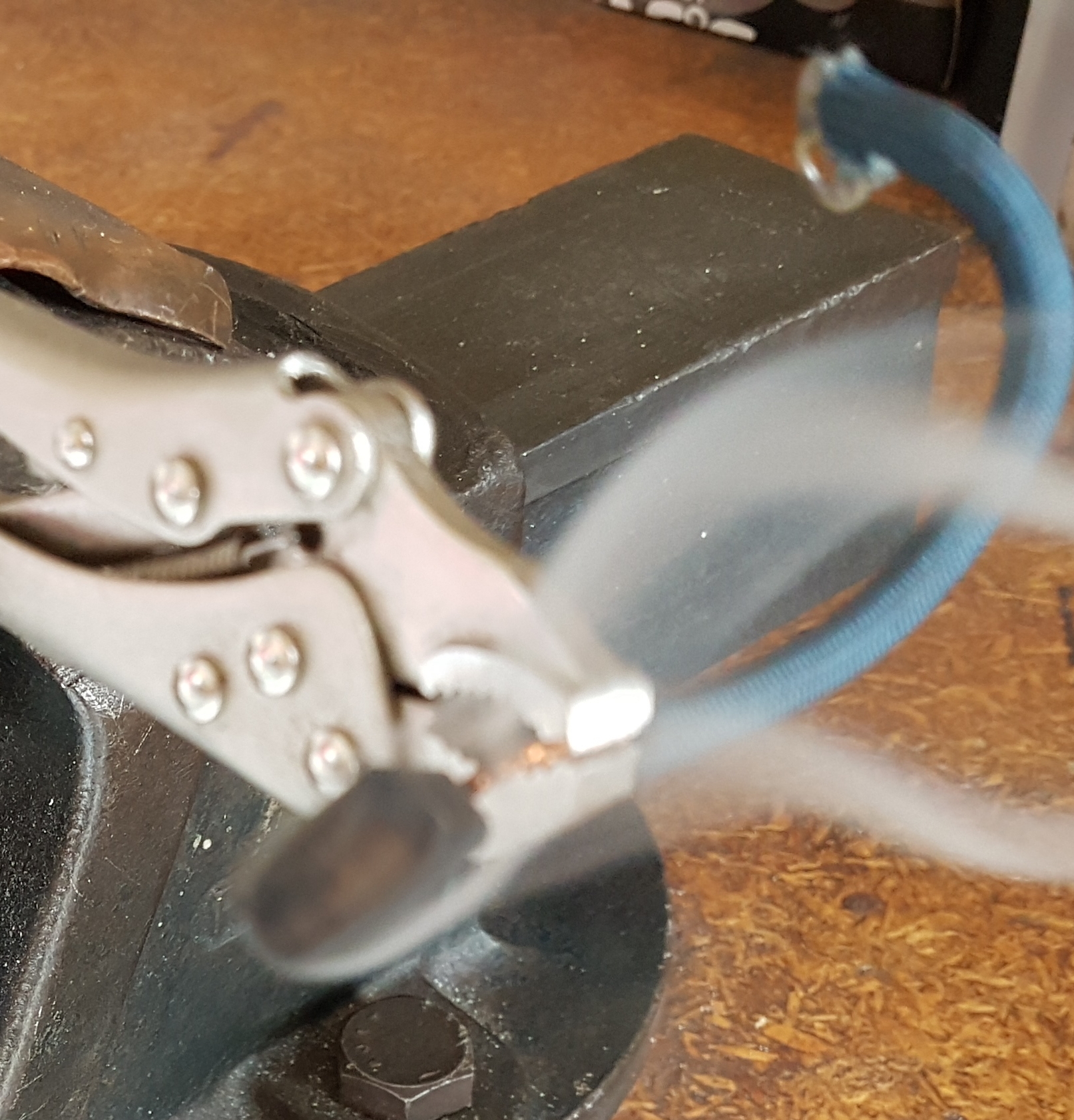

Well, you were certainly right Chris. When hit with a propane torch, they bubbled, smoked, then caught fire briefly ! Didn't manage to capture the flame, but you can get the idea from the picture.
