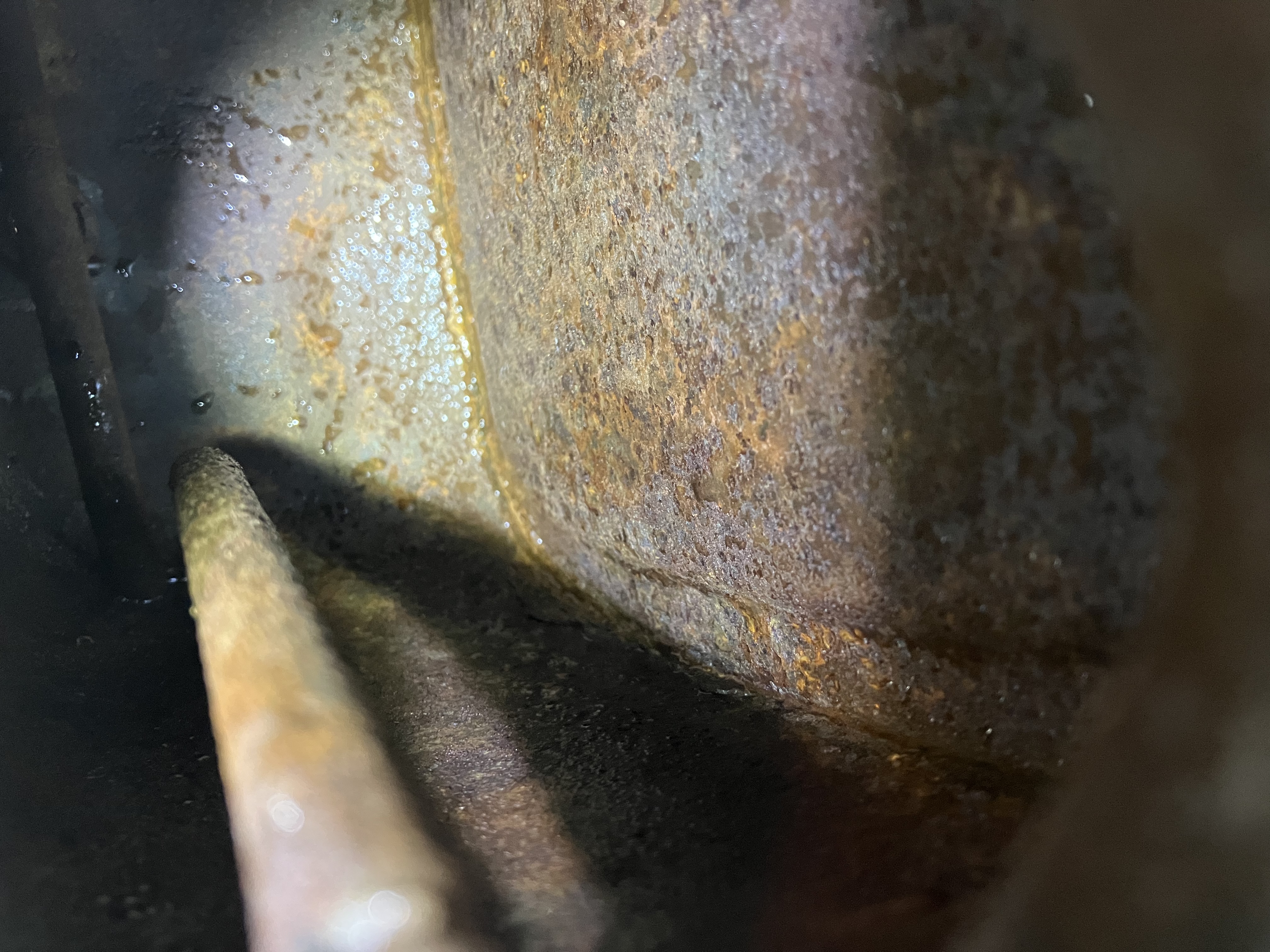

I’m going to throw a couple of handfuls of screws inside the tank along with the vinegar and start shaking her to try and get out what I can. Hoping that should remove what’s left. Then I’ll need to work on the oil lines to ensure they are spotless.

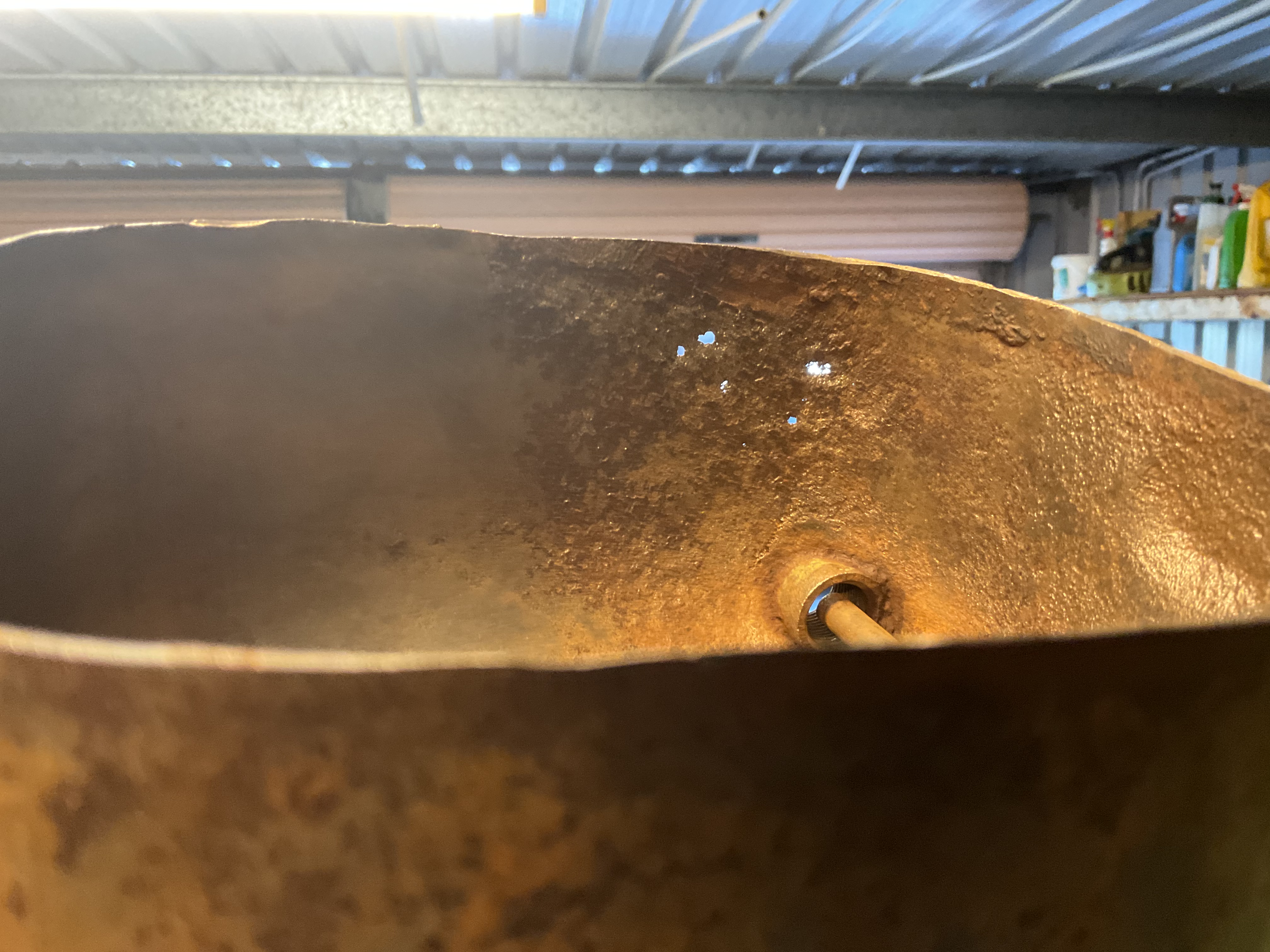

This is the inside of the tank after I descaled it prior to starting with vinegar.

Pitting from the inside is pretty common.The water is more dense than oil and stays on the bottom under the muck. Old oil has acids in it that combine with water. Nev

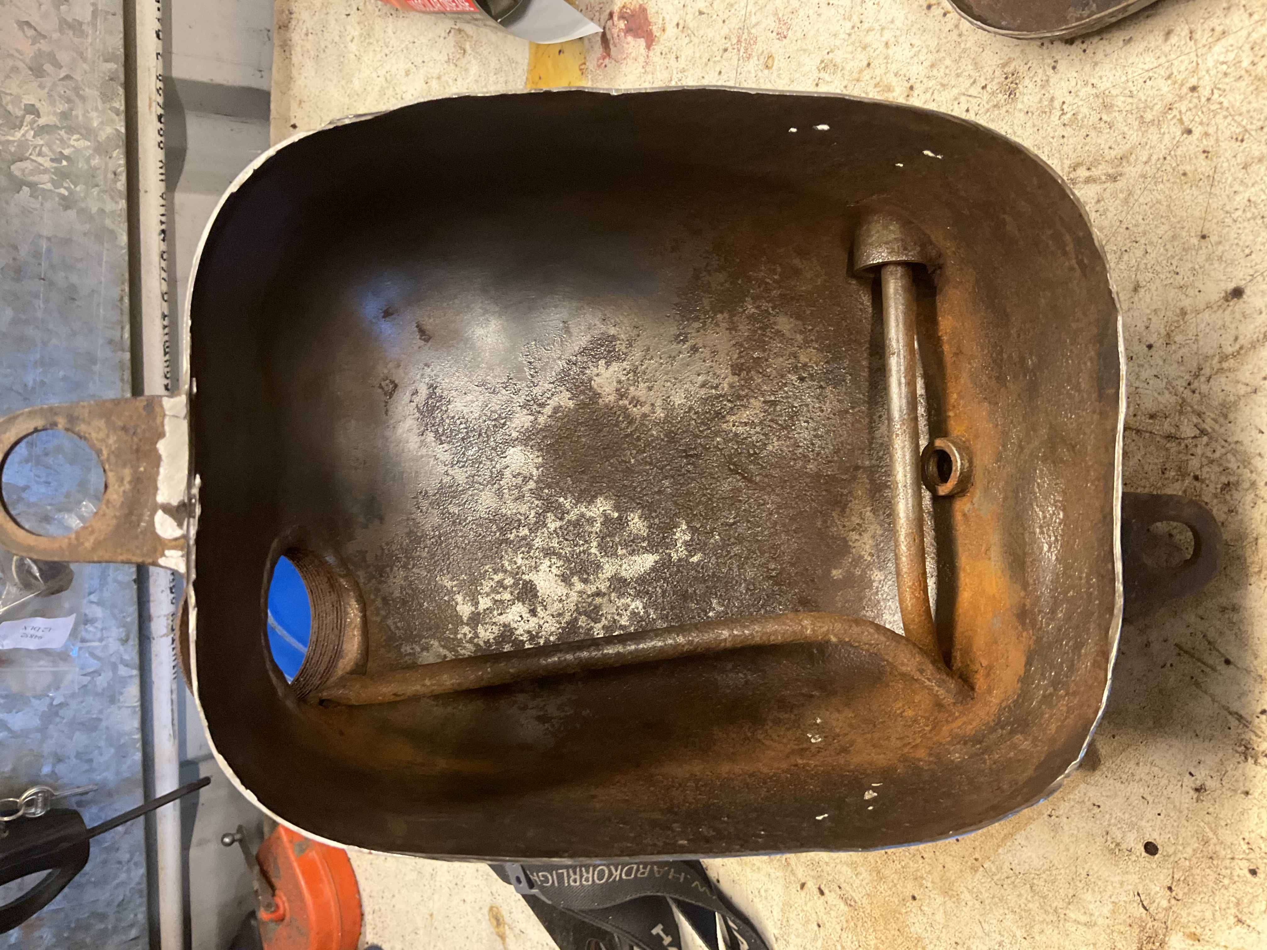

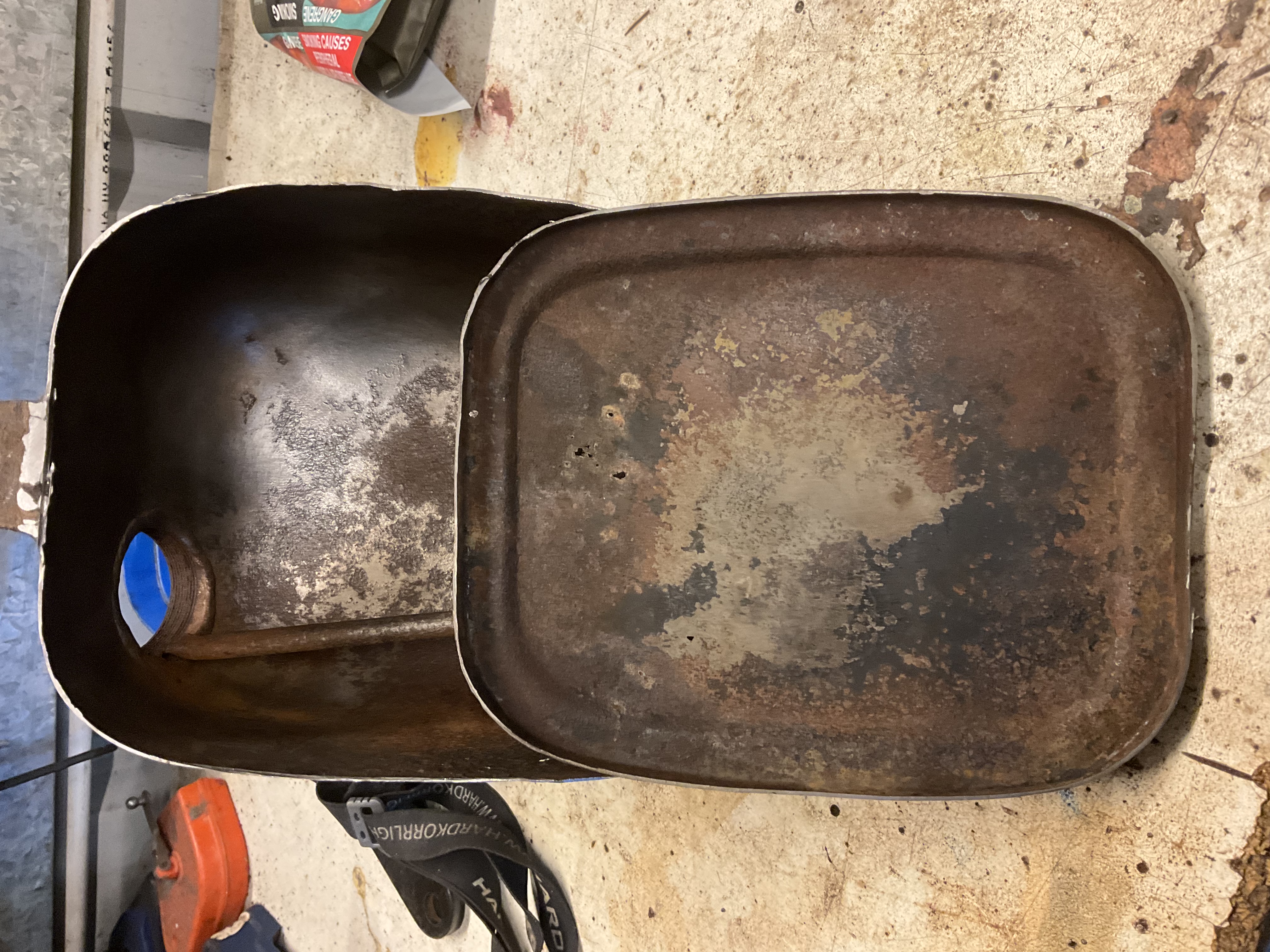

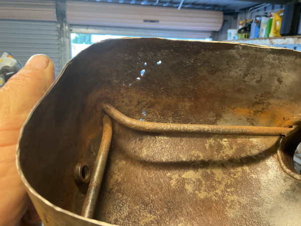

Thanks for the suggestions guys but I think my tank will become a shed hanger. Whilst I had it soaking in vinegar I added a few handfuls of screws/nuts and bolts and every hour or so I would pull it out, give it a good shaking for 5 minutes and then throw her back in the vinegar.
During this time more and more holes appeared, majority of them on the sides with a couple on the back. I’d seen in another post on here that by gently grinding down the brazing you can seperate the back plate from the remainder of the tank.
So I got to work and gently ground down the welds with a flappy disc, doesn’t need a lot and once you get down through the weld the two seams become visible. Worked my way around and then slowly and gently prised it apart. It came apart relatively easy and if wasn’t rusted would have been even easier, definitely not a difficult thing to do and could be brazed back on again without issue.
So I got her split and am sad to say that my tanks days are done, top half’s pretty good however the lower half is toast. So I’m going to give her one last hit with some rust converter, give it a good coat of metal primer inside and out and she will spend her days watching over me in the shed..bugger!
