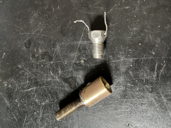

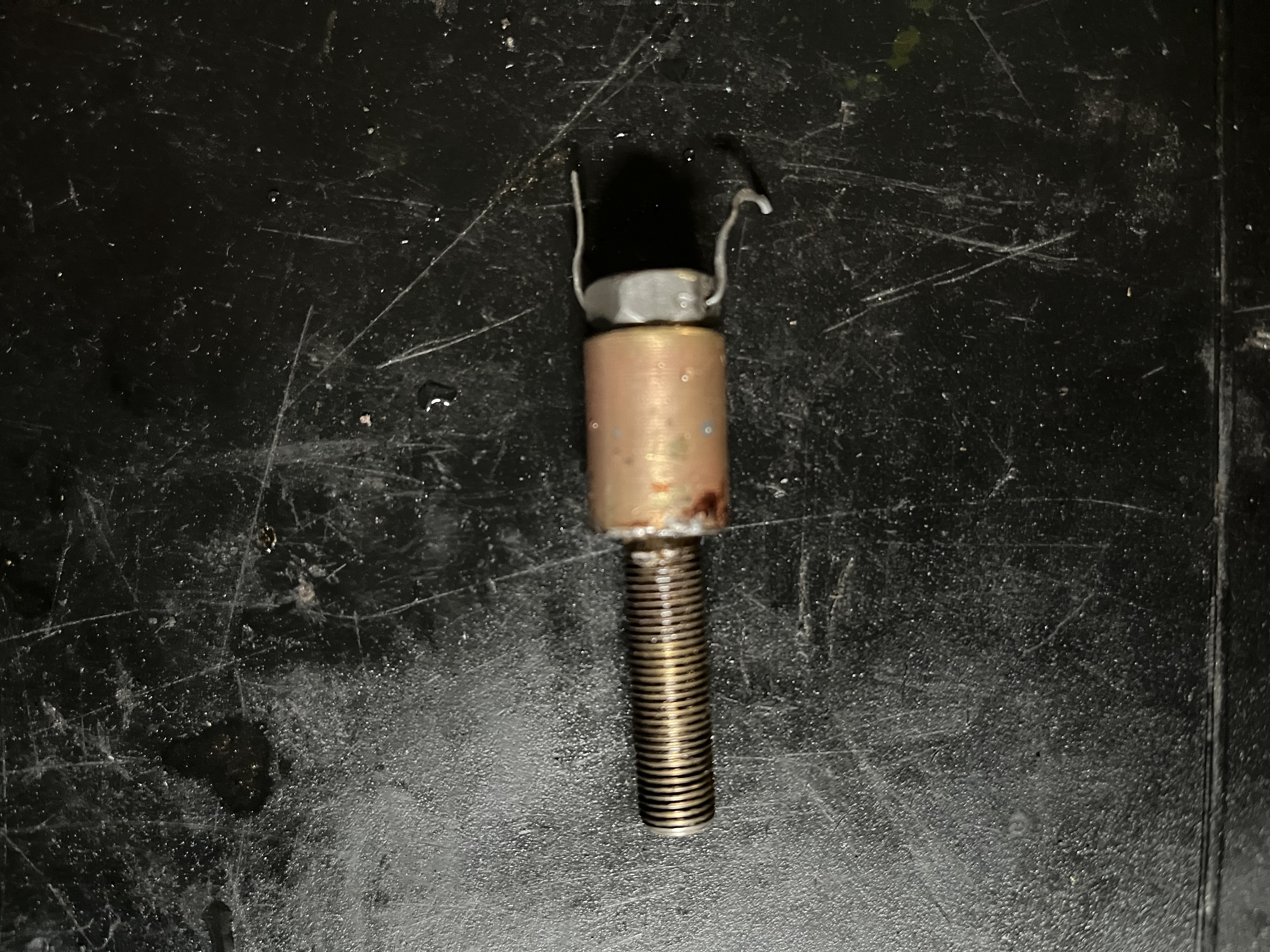

I’ve built my own high tech relief valve testing device and it could be I found the problem.
I used my equally high tech bicycle pump which has a gauge and at first I was happy seeing the pressure go up very fast with the first two pumps. However as soon as I stopped, the pressure came steadily down to zero. Also tested in a bowl of water to make sure there were no other leaks somewhere.
It seems my pressure valve opens straight away and doesn’t close/seal again. The ball isn’t sealing properly. All three parts - housing, ball and spring - are new. I can’t see anything wrong with it, even hit the ball on its seat, but to no avail. It doesn’t seal.
So I suppose part of my wet sumping comes from the incontinent valve and as the oil became more fluid with temperature, it just flowed through the valve and didn’t hold up pressure and flow to the big ends. Sounds about right?
If that is indeed the fault, I’m glad I found the cause, but still don’t know what the problem with the valve itself is. Bad machining on the housing? A wrong or bad ball? Maybe this is a test Draganfly should do before delivering new relief valves to customers.

That sounds exactly like the faulty valve which I had, although mine was a genuine Ariel original. Like you, I changed spring and ball, hit the ball onto the seat then fitted a new ball, etc. all to no avail. Like you, I could see absolutely nothing wrong with the seat. I test all these valves before fitting now.
