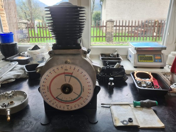

I put together a few parts again. We made a new camshaft and it seems that its timing fit perfectly. I was afraid of minor deviations, but my worries were unnecessary. The timing is based exactly on the E model manual.

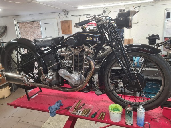

For model E, rollers were used to transmit motion from the camshaft. I had to use classic jacks from model C or D I couldn't find the original pieces of rollers. I hope it doesn't cause me problems at high speeds. The same jacks were used by my mechanic on the C model and everything is fine there
