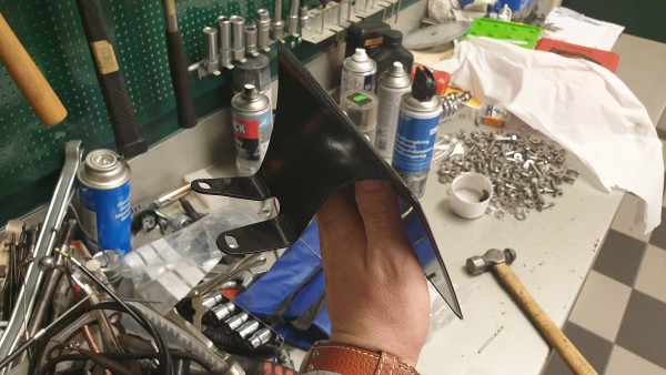

A day of cosmetic finishing touches today - norwegian front registration number plate UK style. Rear end will have to be black on white, to be legit.
Rear registration number plate in the making, trying the letters for size and position before painting. It has now got the mudguard bracket welded on, and has been painted black and white. Letter/numbers to be alu-rivetted on as soon as all dries up.

very nice number plates i like the rivets did you make the numbers and letters and the bike is looking good 8-) :)

Not too bad, had to touch up the border between white and black a little (crappy masking tape!), and try to polish it a bit when properly dry. But hey, it's a reg. number plate already. Legit too.
