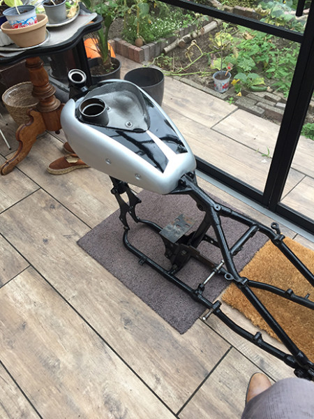

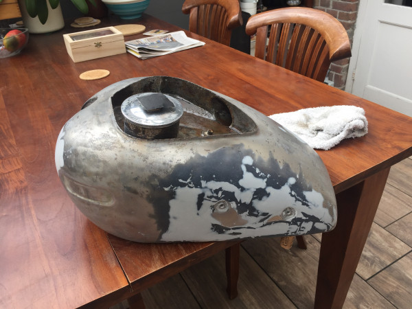

Again some progress on the Ariel NG Project... Compared with other Ariel projects in the past, this one is a less straight foreward job. When I mounted the crankcases into the frame I came aware there where some serious problems concerning straightness! As you can see on the photograph the engine plates where all over the place. It took some time to straighten the frame but all is now solved. The petrol tank was another major challenge because it was totaly shot en rusted through. At the end I managed to get it ''leak-free'' and tested it with 10% ethanol petrol.
As you can see on this moment I'am busy with some panel beating
to be continued
Best regards!

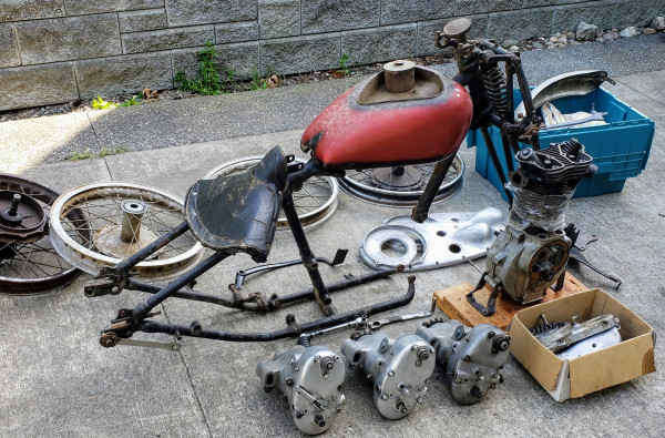

Paul, Very nice work - it's inspiring me to get started on mine - which is a twin to yours.
Mine was also delivered 29 Dec. 1945 to the Netherlands Relief, but it has the low frame (yours appears to be WNG ground clearance frame).
This one is Frame BP2356 with NG1 engine BK12??. Bennett wouldn't give me the last 2 digits as AOMCC is afraid that people will go stamping their own numbers.
What is your frame number and engine number?
I will probably build this with a VH engine as I have most of the parts and crankcase CK4230 - that is the path of least resistance, but would love to find the original engine. It's always interesting to know the history of the original. Somehow this frame ended up in California, but have no idea where the engine is. Or the CP gearbox.
Here's mine with a few weird parts... Still looking for rear engine plates.

Hello Doan,
you have 3 BA gearboxes, some would be happy with only one!
So when looking for a CP box you have some nice swap material.
Given the value of NG Ariels I dont think one has to worry about fakes by engine or framenumber.
Engine number is on the crankcase twice, second stamping you find on the left hand side case between top and first down tie bolt holes on the front.
When mounted in the frame this second number is almost not visible because it's behind the left hand front engine plate.
When the engine plate tin covers are on the bike you can't see them at all.
On your picture I see the right hand side rear engine plate, the one with the magneto platform, so that one you have.
Succes and keep us posted! you have some work to do but these 350's are very worthwhile to get back on the road again, lovely machines.

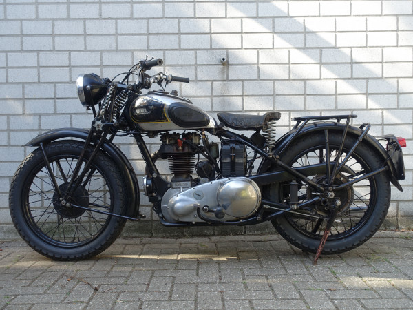

pictures show my Netherlands Relief NG from November 1945

Re: 1946 Ariel NG Project
Interesting stuff! It's even more international - the Belfast crankcase I got from a Canadian in Vancouver.
Nice looking bike Vincent - love the pictures. This will be built as a VH so the plan is to use a BA gearbox. One of those boxes is pre-1946 Sq4 (old Burman numbering) but feels a bit light so some gears are probably missing! I will build 1 'box with the best parts and trade the others.
And yes, there are rear engine plates but they are a wreck! Fixable, but wonder if it's worth it...
The tank is a PA style, but will probably fit a 1951? style non-panel tank.
