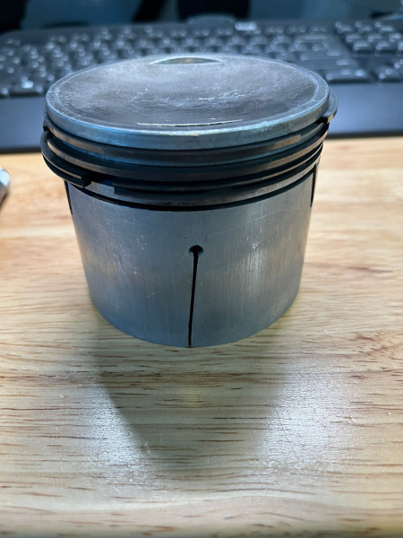

Re: Which pistons are available for my ariel
I have a 1946 VG 500 single and in the process of its restoration and riding it for its second trip around my back yard, it heat seized. After an hour, I was able to turn it over aging with the kick start. I had originally assembled the engine in 1987 with the parts I had, and not checking cylinder or piston clearances as I assumed the clearances were correct, and I did not have access to an inside and outside micrometer at that time. Today, I do have these tools and after I disassembled the engine to see what was happening, I discovered very minor areas on and around the Gudgeon pin indicate signs of wear and zero markings in the cylinder barrel.
I have measured my diameters: BORE 3.2703"/83.066mm PISTON 3.2667"/82.974mm and calculated clearances and have a mere 0.0036", insufficient according to what I see on Dragonfly's Piston web page. When looking at a replacement piston and ring set, I noticed that my piston, which has convex top and a slit in the skirt, the replacement is domed.
Can someone tell me what piston I have (attached photo), and will the VH500 replacement (Piston, complete, 7.5:1, 81.8mm +.040) work in my application?
Inside my piston are molded lettering as follows:
D54
HEPLEX
11497 BA
413
PatNo 616320
D54
HEPLEX
11497 BA
413
PatNo 616320
1946 VG 500
- Posts: 2048
11497 is the 5.6:1 'dished' (concave) piston (originally used for the trials bikes, I believe). At one time they were the only ones still commonly available.
There's an extract from the 1955 Hepolite catalogue - with Ariel piston info - in the online library (if you've not found it already!):
https://www.arielownersmcc.com/members_ ... /ariel.pdf
The 7.5:1 (10503 equivalent) will work fine as long as you can get the clearances sorted out. It looks like a JP, which some of us are a bit uncomfortable with - however I've seen it posted somewhere that they've now changed some of the piston specs to make them less prone to tightening up.
Hope that helps
Hope that helps
- Posts: 2141
The expansion rates of the material that JP have always used are almost identical to those quoted by Hepworth and Grandage, the only real criticism of the JP pistons is the extra weight caused by using a parallel bored pin, rather than a tapered one. My advice is to use an old pin if a good one is available.
A split skirt piston should use .002/.004 clearance and a solid skirt one .005/.007. So you will need to have the bore honed out to suit the new piston or clean up the one you have and put it back. That is an odd place to seize.
