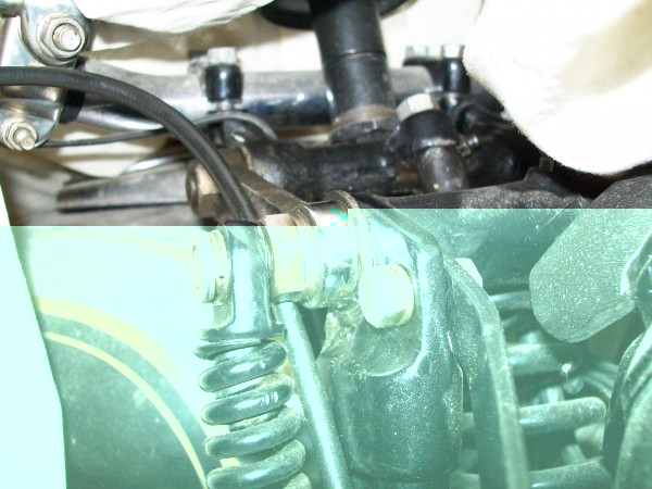

paul.wirdnam wrote: So it looks like I have the correct original washers for '39 type girder forks with auxiliary springs but I haven't found any other photos on the internet of bikes with these washers. As expected, these 1/8" washers are also listed in the W/NG Parts Book, but can I find a photo of a W/NG with them....no!
I cannot work out what they are for. Are they there just to cover up excess thread on the spindle? In my case, I have (old and new) half depth nuts, and without this thick washer, quite a number of threads are visible on the spindle, which means the auxiliary spring mounting could slide across and damage the threads. But with the washer, the mounting would only rub against the face of the nut. Many W/NG I've looked at have full depth nuts and there would not be room for this 1/8" thick washers.
Hello Paul,
I`m far from being an expert so I can`t tell you much about the purpose of those washers other than to say that everything seems to go together well when the washers are on the insides of the nuts as per Waller.

Many thanks Chris. Other than mine, yours is the first bike I've seen with these washers Image

Done a big check up, Neither of the two 39 forks still here have the washers fitted. I've looked up the W/NG maintenance manual Book No.101/A1,3B and they are where you have fitted them. I cannot see what purpose they serve, though The nut is quite thin and a wider nut would seem to be a better idea BUT there you are. Waller is right as usual. and the New Old stock set are the same . I just made a phone call to the lucky owner to confirm.. Nev
