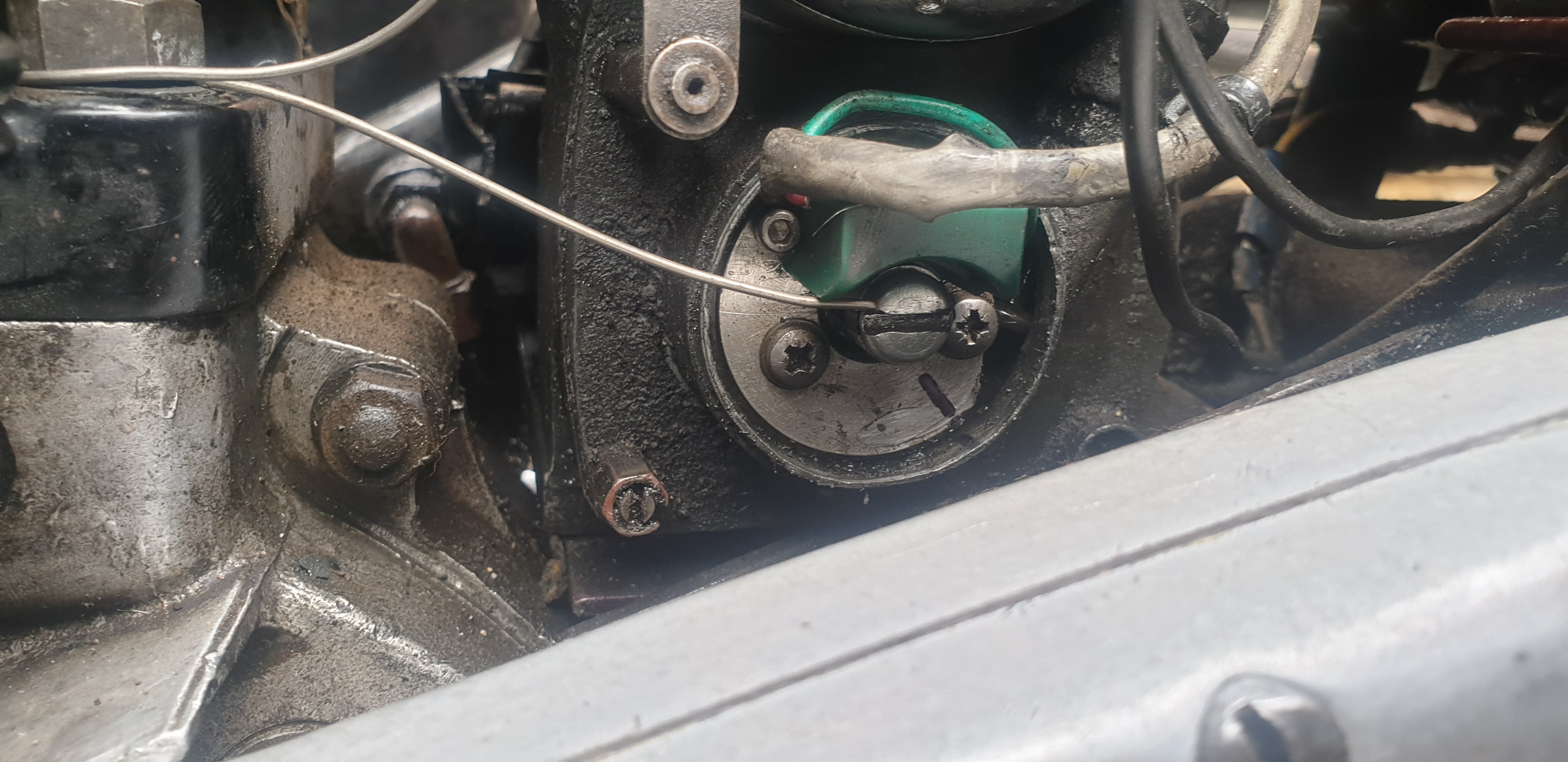

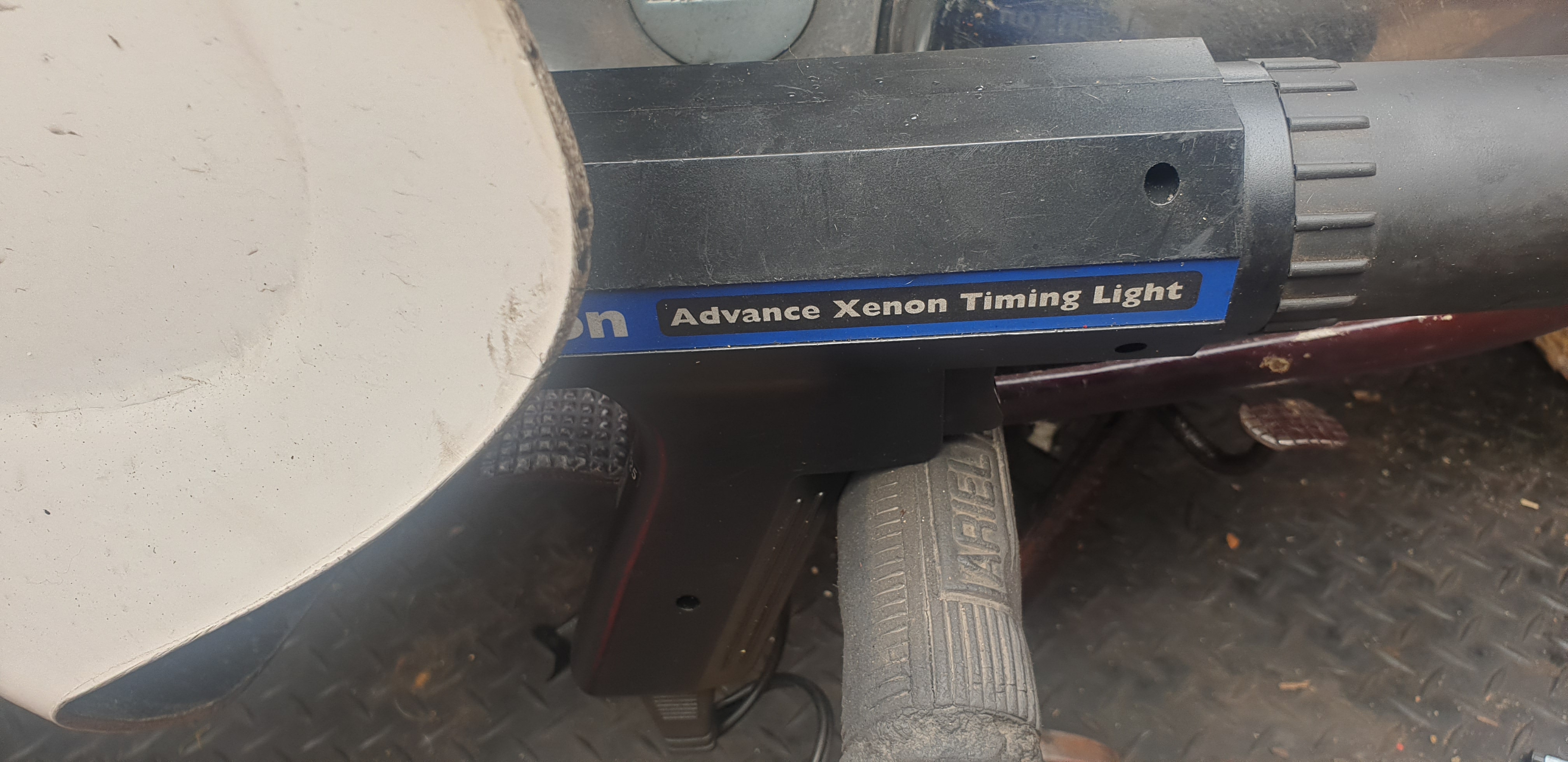

Done it, not sure how accurate I've been though but I've done my best,, I've gone for a tad over 1/2 BTDC. I used my timing gun on the screw that holds the magnet.

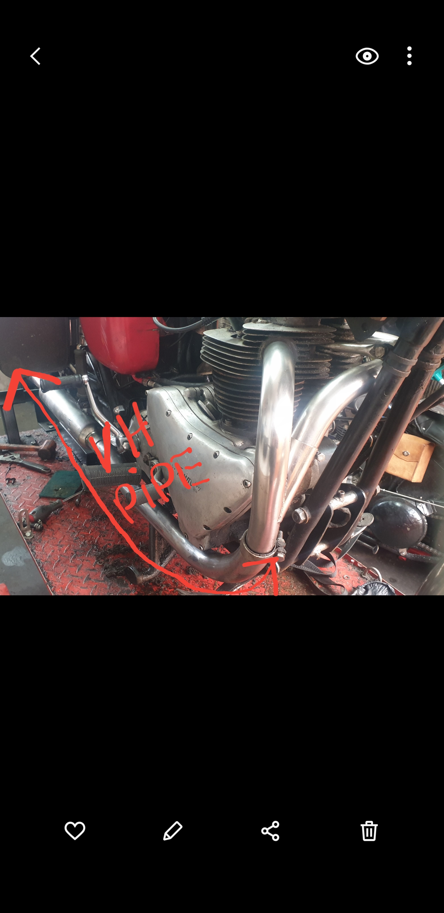

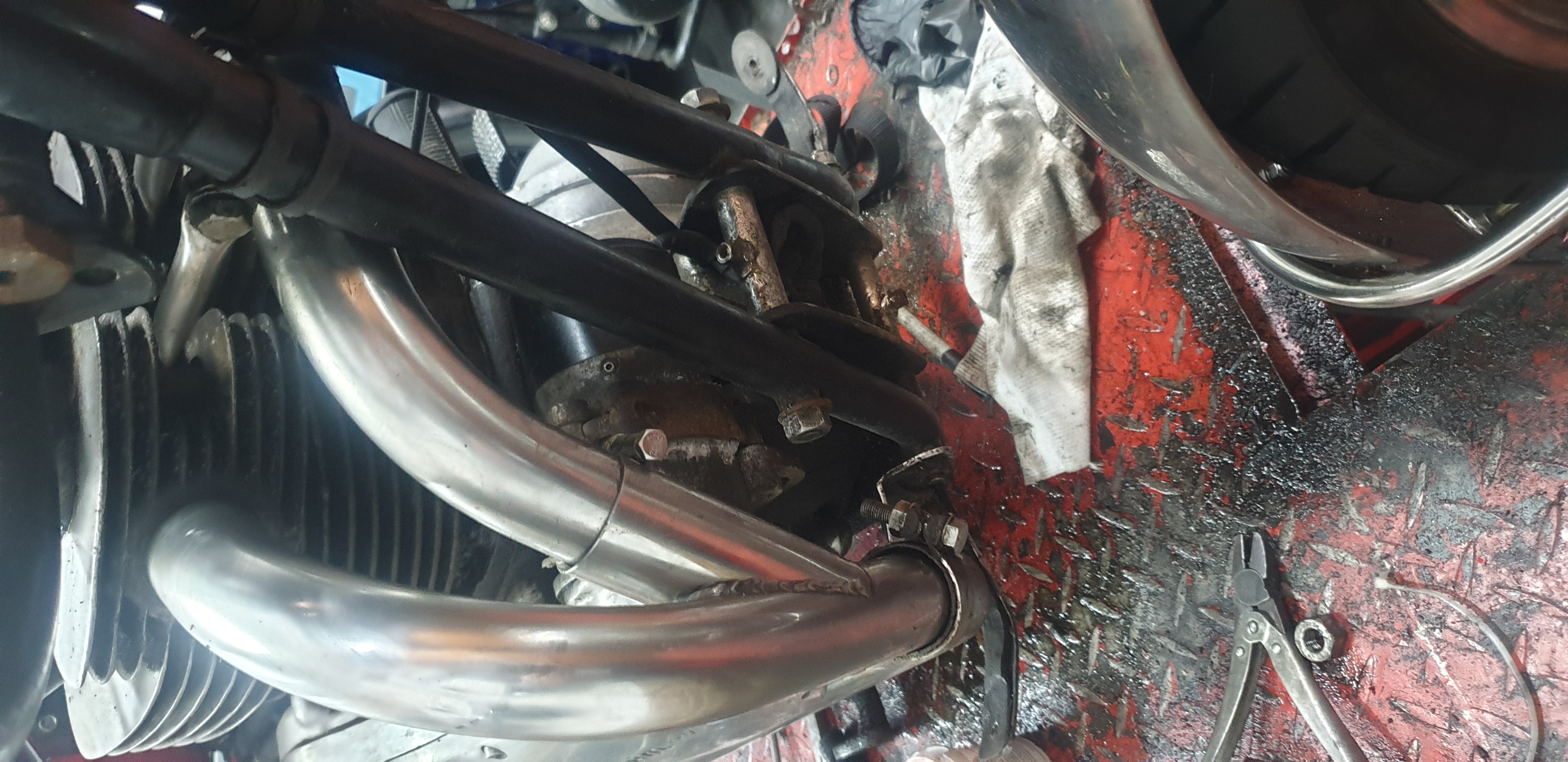

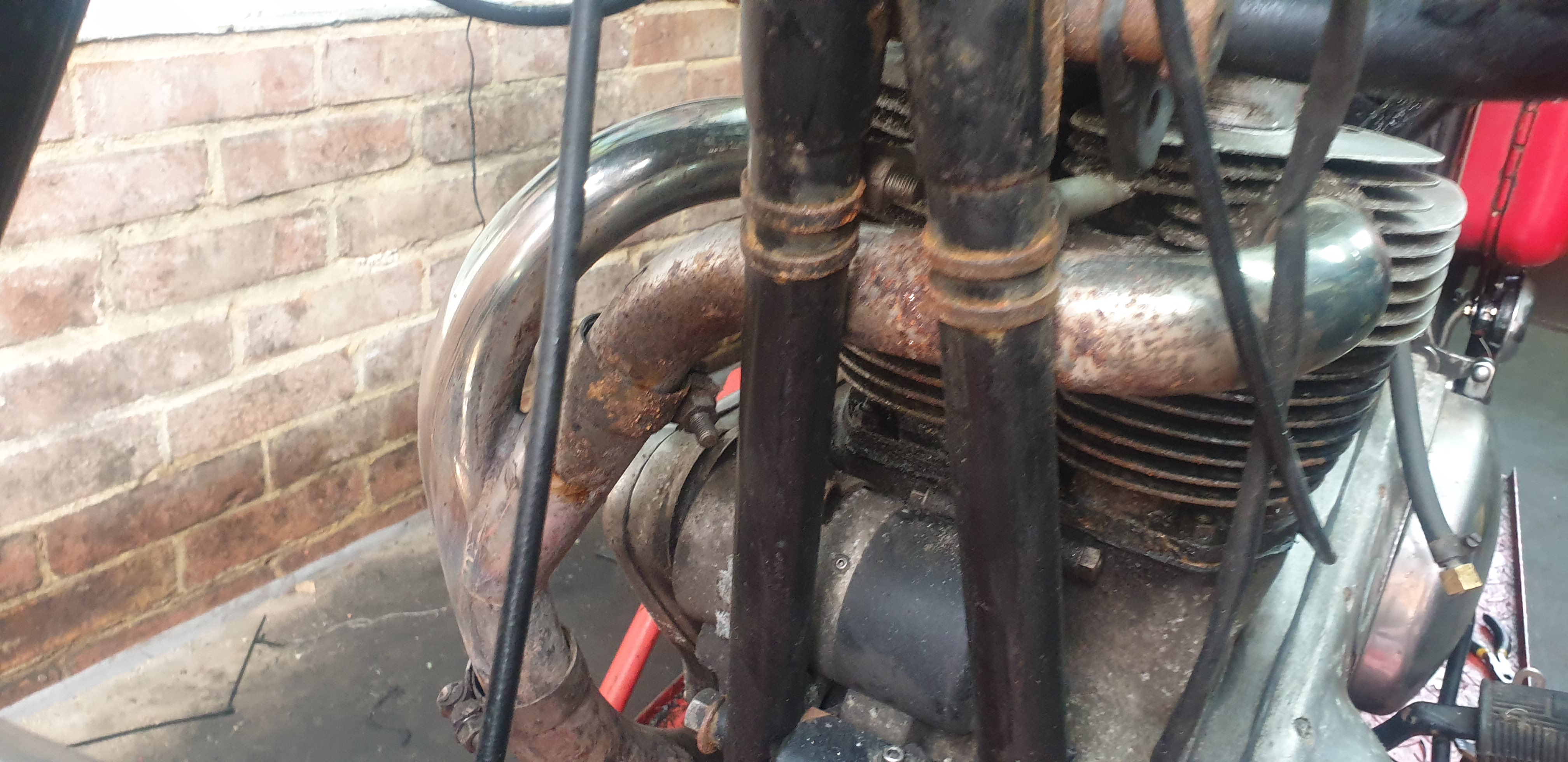

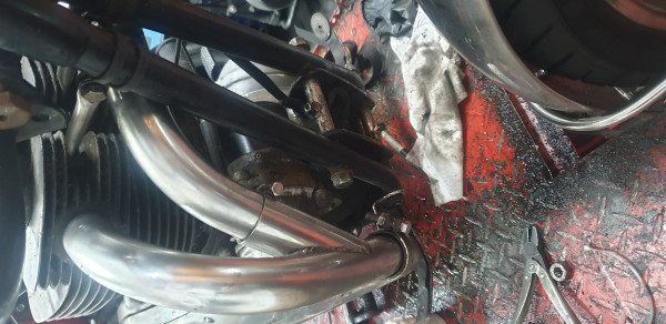

Finally got at fitting my new stainless siamese exhaust, the old one has rusted through in a few places.
New one fitted

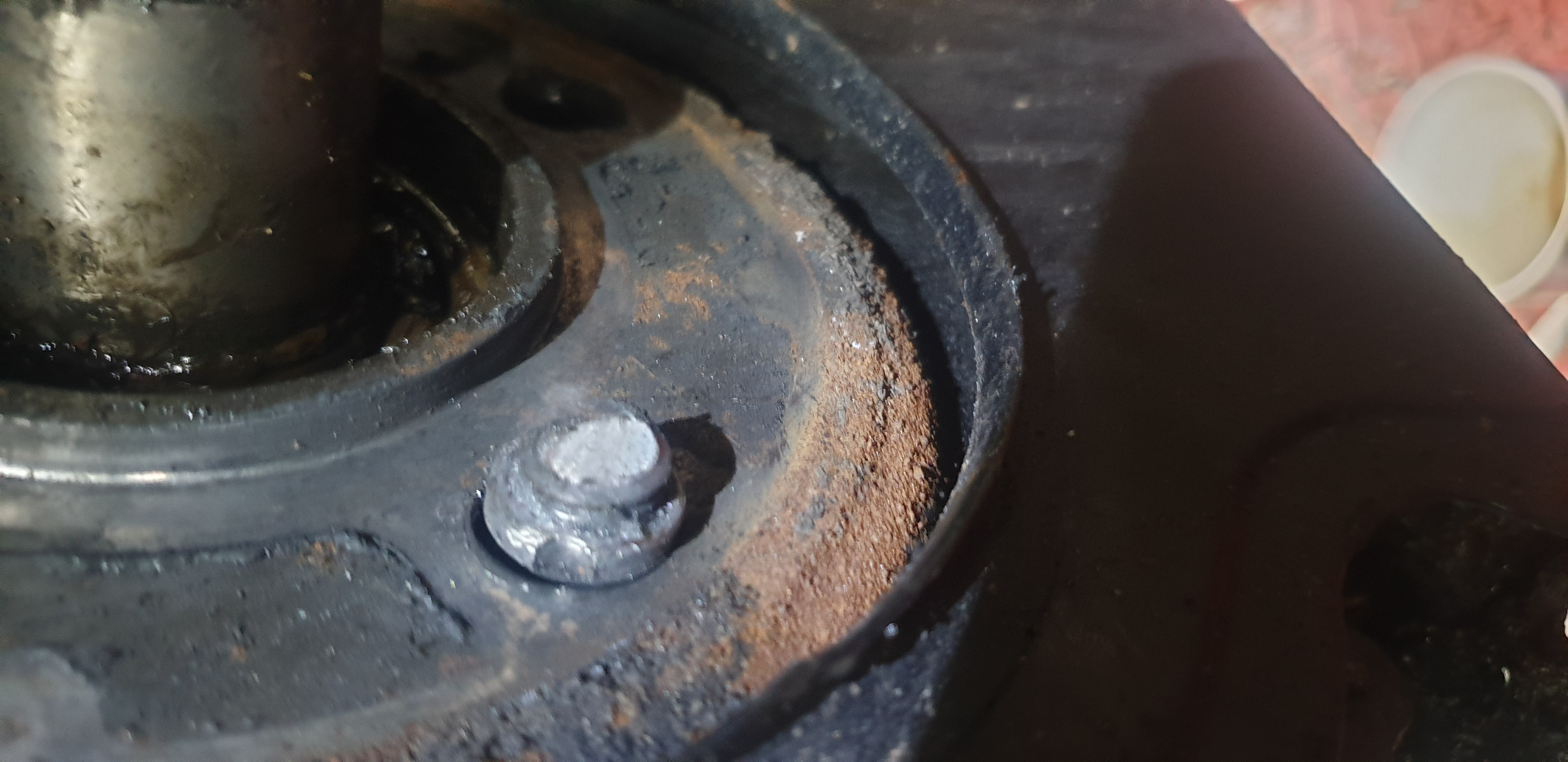

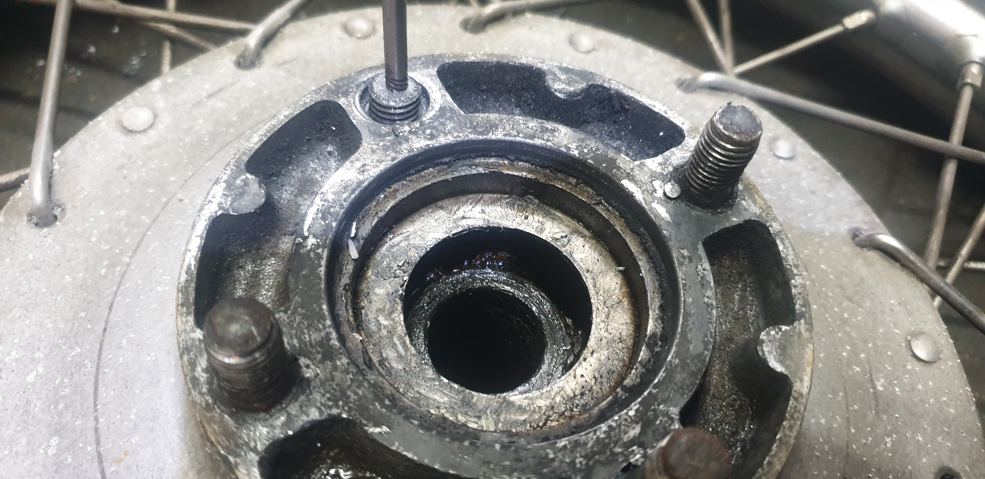

That all went OK but whilst I was at things maybe a check of the drive chain and wheel nuts would be a good idea. Three were fine but ohh dear the forth,:oops:
One of the studs had snapped, lucky one of those easy outs came to my rescue and unscrewed easily
The other half with the wheel nut was stuck on the sprocket, hacksaw got that removed

Very nice exhaust, a work of Art!
Feked?
Steven.Carter
Posts: 4311
Post by Steven.Carter »
Vincent.vanGinneke wrote: Sun Mar 19, 2023 6:04 am Very nice exhaust, a work of Art!
Feked?
I was after fitting it :D
I bought it from Armours, I only use the bits that go into the head, the rear part and silencer is from a VH which fits over the the front part
