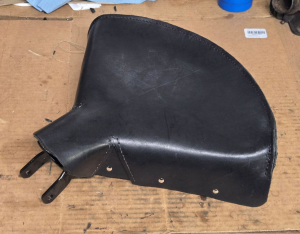

Here's a couple more pictures of the seat work. the first shows the stitching at the "darts" and the second the fit on the bike. I got the dart too wide on the left and the nose of the leather sits higher on that side so I later pulled and re-stitched to get it to lay down better. I'm happy with the way it turned out because it looks similar to an original cover but should be much tougher.
