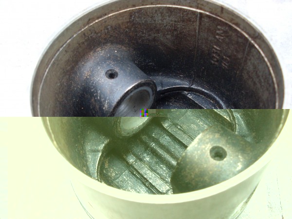

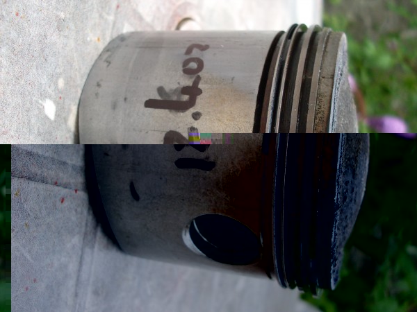

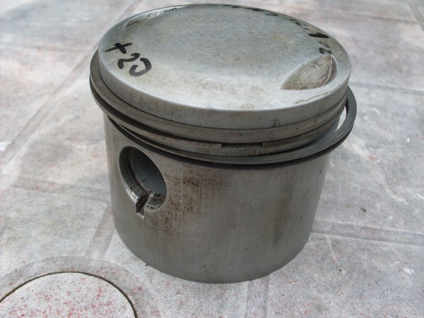

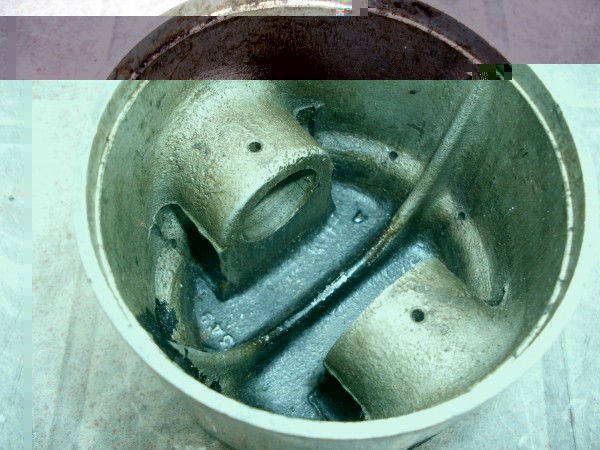

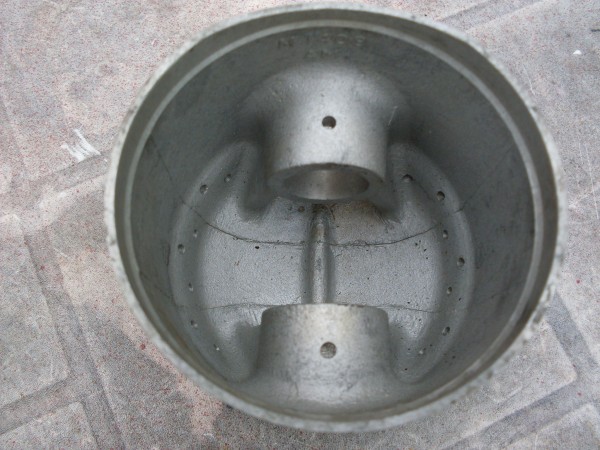

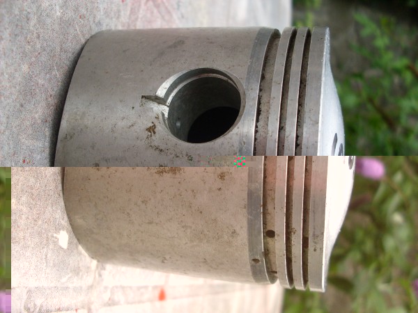

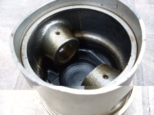

As there's been some discussion of piston weights, to go with Greg's comprehensive details of the Hepolite 9:1 I've weighed some of the ones I've accumulated.
My scales aren't massively accurate and I used imperial (oz) which it only attempts to 1 decimal place, but I weighed each item several times to check I got the same reading each time. As Greg used grams I've done a (rounded) calculation to for the equivalents of my imperial units.
Set of Hepolite +020 piston rings (2 compression, 1 oil) 1oz (28g)
Gudgeon pin 2.8oz ((79g)
6.2 Hepolite 10793 (number cast inside) standard bore split-skirt 12.5oz (354g) (with rings, no pin) 6.2 Brico ('Ariel Brico' cast inside) standard bore, oval ground 10.3oz (293g) (no rings, no pin)
- Posts: 1999
Re: Which pistons are available for my ariel
6.2 non-Hepolite (unknown make, has radially deeper rings than Hepolite, may or may not be GPM), +020, oval ground 12.4oz (352g) (with rings, and carbon! - no pin)
7.5 Hepolite 10503, +020, oval ground 12.9oz (366g) (with rings, no pin)
- Posts: 1999
7.5 Hepolite 3-compression ring +020 oval ground 11.7oz (333g) (no rings, no pin)
When I looked at the decimal point ounce differences I thought they were big, looking at the gram equivalents I'm not so sure!
Depending on how many decimal places you want to work to these could all seem quite close, except maybe that strangely light Brico.
HTH

Since some of your weights are without pins or rings I weighed the ones from my +0.040" Heplex 10793 using a scale for which I have calibration weights and is accurate to +/-0.01 g.Simon.Gardiner wrote:As there's been some discussion of piston weights,
pin only 96.12 g
rings 27.13 g
(2) circlips 1.90 g
On a different calibrated scale (with a higher range than used for the above) that is accurate to +/-0.5 g the complete piston (with pin, rings and circlips) is 467.0 g
I gave some weights for rings and pin at the start of the posts - your +40 rings are pretty close to my +020 but your pin is some 17g heavier - I wonder if that's production tolerances?
The +040 10793 comes out slightly heavier than my standard 10793, which would be expected. (And assuming they're both the same split-skirt design.)
Given the density of steel (~8 gm/cc) that difference is quite a bit. It represents your pin "missing" the equivalent of an additional cube of steel ~1.3 cm on a side.Simon.Gardiner wrote: your pin is some 17g heavier - I wonder if that's production tolerances?
The OD (0.810") and length (2.684") of the pin are pretty much fixed (in principle, my pin could be 0.040" longer than a stock one) so there are only two possible sources for the difference: the bore of the pin, or a measurement error. In my case I've confirmed the weight I quoted previously by repeating the measurement today on the 0.01 g scale as well as, to less accuracy, on the 0.5 g scale.
My pin has an ID of 0.614" at either end, slowly tapering to 0.498" in the center. Call that ~0.55" ID on average (a more accurate average could be calculated based on the weight and other dimensions, but I won't take the time to do that). Converting to metric, and rounding:
OD 2.06 cm
ID 1.40 cm
length 6.82 cm
(volume 12.23 cc)
To remove 2 cc from the volume would require the ID to be increased to 1.54 cm (0.606") on average. That increase of average dia. by 0.056" certainly seems possible, but you'll have to check your pin to see if that, or a measurement error, is responsible for the 17 g difference. If the ID of your pin is larger, the difference is large enough that it would seem to be more of a "design difference" than a "production error."
Selection of 4 VH gudgeon pins, 2 used, 2 NOS (in a box of NOS pins, not from pistons), weights (oz) 2.5, 2.8, 2.9, 3.0.
ODs not very accurate, lets say 0.811 with half a thou each way (sometimes each way in the same pin - in my experience what went out as 'spares' is sometimes a little off-standard). Lengths - two at 2.685 and two at 2.690. They're all taper-bored, I can't get accurate measurements for the IDs but three are 0.7 at the outside edge and one is 0.685. The last one is the heaviest one.....
- cmfalco
- Posts: 550
- Location: U.S.
Very interesting. Thanks for posting those figures. That's a big range, but mine is heavier still at 3.4 oz. The additional weight of mine comes from it having a smaller ID of ~0.61", hence more steel and thus heavier weight.Simon.Gardiner wrote: weights (oz) 2.5, 2.8, 2.9, 3.0. ... three are 0.7 at the outside edge and one is 0.685. The last one is the heaviest one.....
Makes the idea of setting the balance factor to the nearest gram interesting when the uncertainty in total weight could be an ounce...
