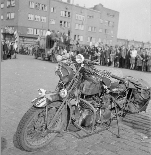

LuisPaz
Posts: 320
Location: Argentina
Re: Field stands
Post by LuisPaz »
Hi fellows
It is clear that the stand was made for off road use... but stone street seems to be good too
Canadese_militairen_tijdens_de_bevrijding2C_Berlagebrug-Amsteldijk2C_Amsterdam_288_mei_194529.jpg
Luis, from Argentina
1944 Ariel WNG
Posts: 2048
Re: Field stands
Post by Simon.Gardiner »
Blimey - how do you power all those lights from an E3 dynamo??
Would have been better off removing the blackout mask! :D
(Off topic - apologies)
