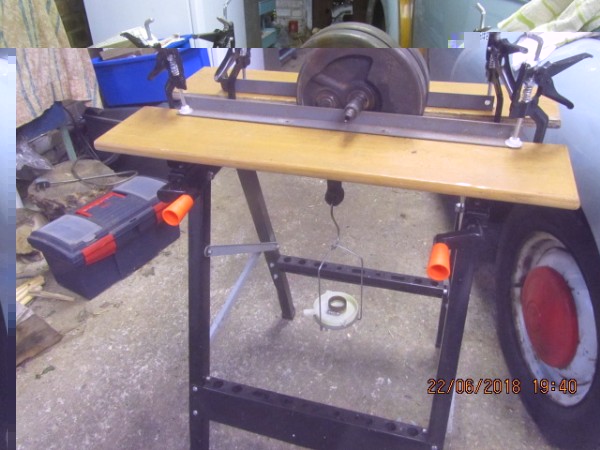

Inspired by Brian Walker's original post I thought I'd have a go. The method seems crude (so skilled and exacting engineers such as Messrs Whiting and Falco should perhaps look away now) but with care you can get a good idea of where you are - and just as importantly http://forum.arielownersmcc.com/downl ... w&id=17620 - a good idea of where you aren't. Here's my kit below.
The angle irons are clamped to a simple work bench and its feet and the end of the irons are packed with card etc to get the irons as level as I can using normal DIY spirit levels. (No hope here of getting only 3thou runout in 12inch run that Mr Whiting recommends.) The balance weights were measured either side of the big end to try and allow for lack of level in the irons.
The split skirt +20thou piston inc pin and circlips weighs 596g, the conrod small end is 207g and the balance weight is 563g therefore giving a Balance Factor of 58%.
Regards from MikeN.
