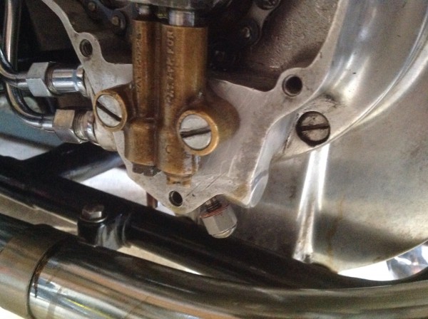

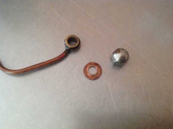

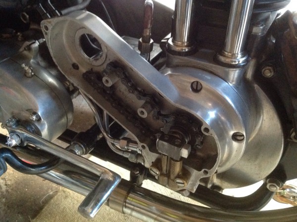

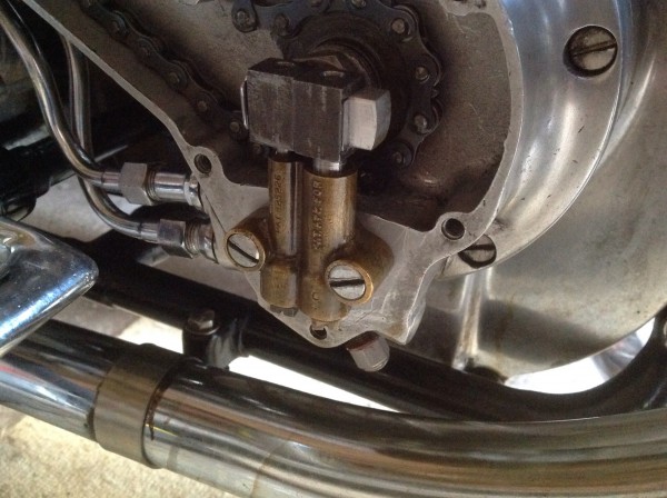

mark.scott
- Posts: 51
- Joined: Tue Dec 23, 2014 3:56 am
Re: Oil Pressure
Hi Everyone here are some pictures of my set up the banjo? union obviously isn't attached. Thanks Mark
- alan.moore
- Posts: 1461
- Location: Leicestershire UK
Re: Oil Pressure
As Paul says it looks as though you have a 1941 onwards timing cover fitted. There is a supplement to the earlier models in the AOMCC document repository which states that from 1941 onwards the oil pressure valve is located behind the pump in the oil feed to the crankshaft. It is not adjustable but it works on the same principle as the earlier one i.e. it has a seat and a spring loaded ball bearing and is there to produce pressure in the oil gallery feeding the . It may be a case that the spring has lost it's tension, the seat is leaking or the valve has not been fitted. You would need to remove the pump to check if it is there and in good condition.
