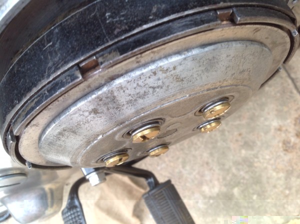

Hi just stripped the clutch plates down (easy really) and cleaned them up. Couldn't get the clutch centre off as I don't have a spanner that big but the splines look OK see pic. When should the cork clutch plates be replaced ? Put it all back together seems slightly better but still grinds when trying to engage first. Just topped the box up with grease and will try a bit more on the cable adjustment. Not sure after that. Many thanks for your help. Mark

I would expect your problem is that the clutch springs are not allowing the pressure plate to rise squarely , causing clutch drag. Ideally use a clock gauge or just a indicator arm to show which part is lifting higher than the rest and reset the springs individually so it lifts squarely.

Your splines look good!
As Ian says, look at the pressure plate whilst you turn the engine over, and while it is turning, lift the clutch. It's pretty obvious if it is not lifting squarely.

Ah - Wondered how you tell if the clutch is lifting squarely. I was going on the distance of the spring retainers. I'll try it with the engine running. Just worried if I'm causing any damage with the crunching.

If it is very bad, you'll see it just turning it over on the kickstart.
Put it in neutral; lift the clutch; turn the clutch with the kickstart.
