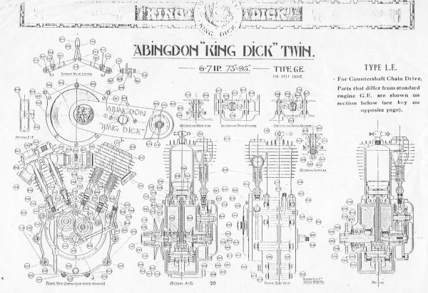

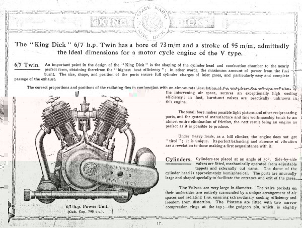

I've been back into history and dug out my AKD file. Not too much relevant to Ariels, but I'll attach the pages that describe the V twin motor. It shows the odd flywheels and the double bearings of the chain drive motor nicely.

1915 Abingdon page 20

1915 Abingdon page 17

And if you are really interested, a high resolution copy of page 20 so you can read the little numbers!
Leon
1915 Abingdon page 20 - high resolution

Hi Leon, These pages are a great help thanks very much. I have the parts lists but they don't show the detail that these diagrams do. I can see the different sized flywheels clearly in the AKD drawings.
