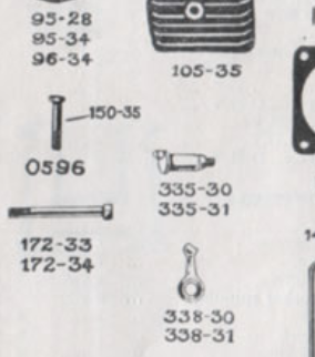

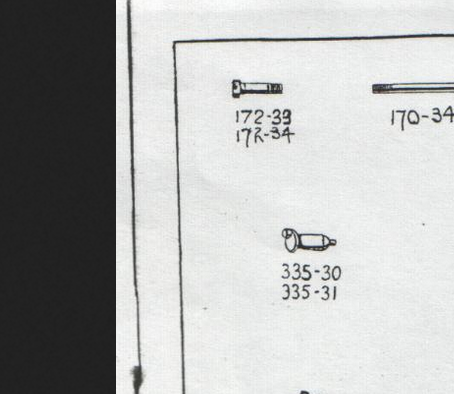

Sorry to be nit-pickey but the b*** parts books for both '33/'34 and '37 list the two varieties of lifter spindle for the SV and OHV
Simon's head is a '33 prior to the aluminium cast box of '34

That's not being nit-picky that is correcting someone who ought to know better and stands corrected. Still learning...
