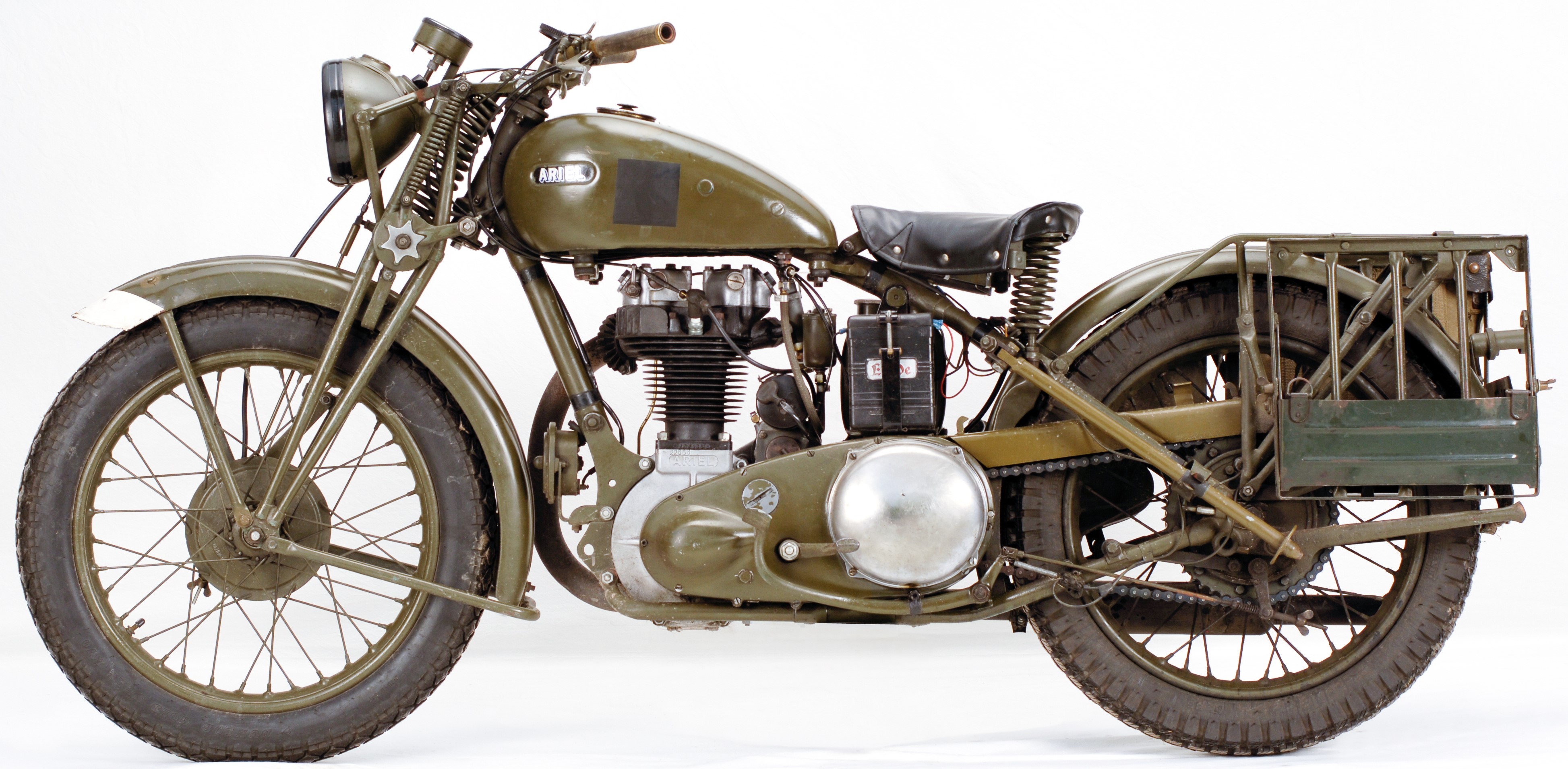

This example from contract number C11,464, was delivered in September 1941 and in spite of the current finish and tank number it was one of 750 built for the RAF. By the time it was built the knee grip rubbers and both number plates had been deleted. Some parts that are usually bright chrome plated should be in dull chrome instead - push rod tubes, exhaust system, handlebar controls, clutch dome and gearbox levers. Although the parts books indicate that engine plate covers were not fitted it would appear that it means they would not be supplied as a spare part, but were fitted when new. Although tank badges were never listed in the parts books there is evidence to show that they were fitted to the early contracts but later the bar that the badges were screwed to was deleted and plain transfers used. Missing lower chainguard.

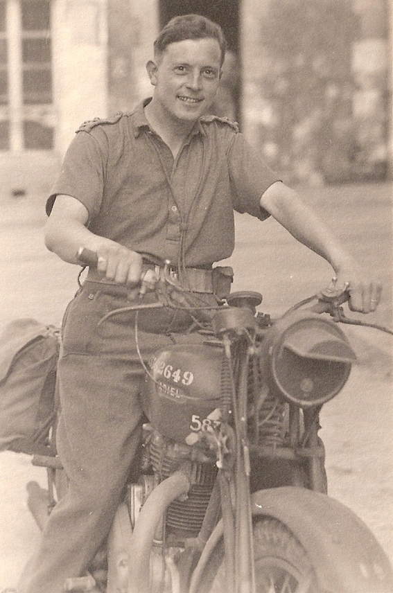

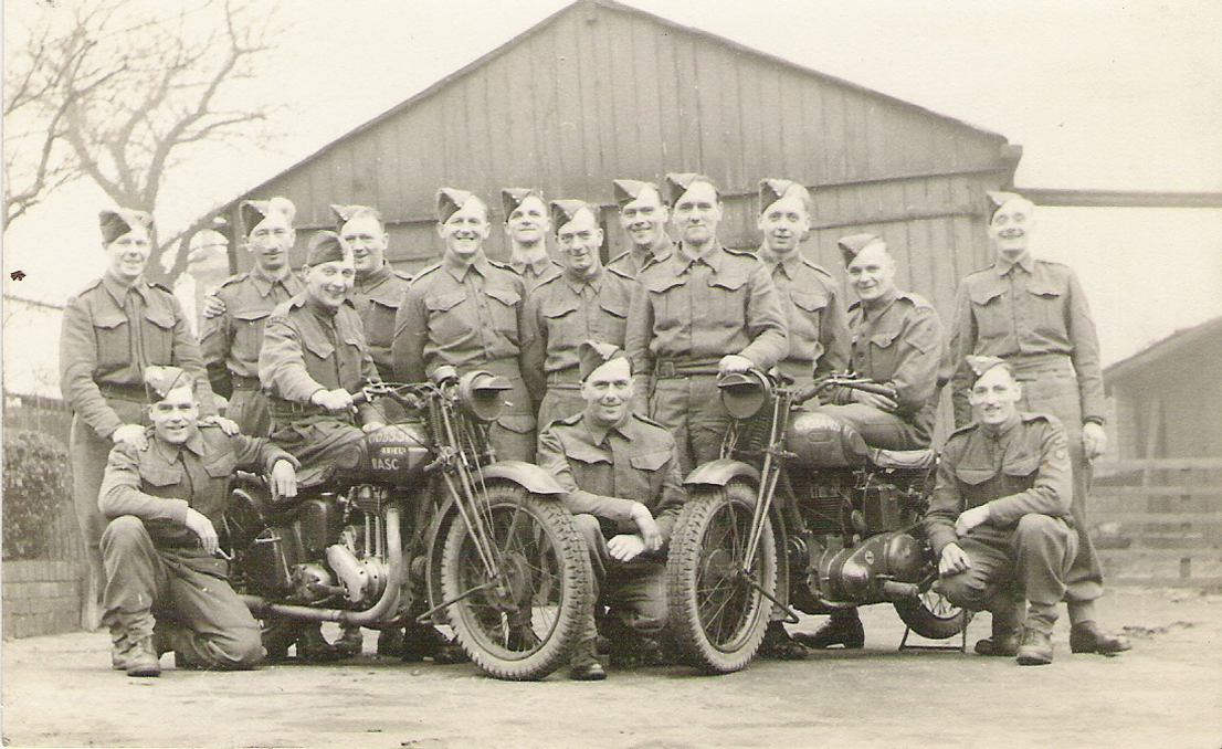

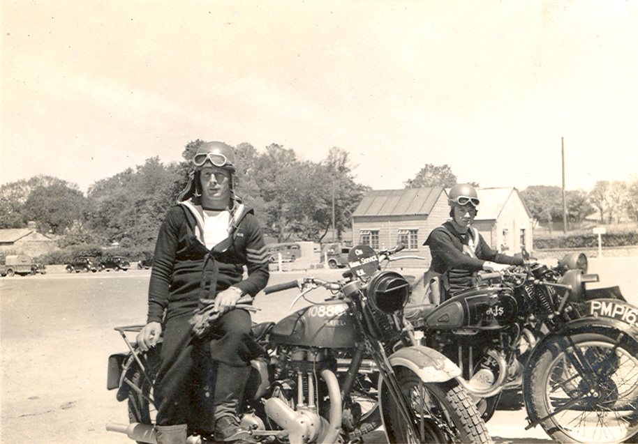

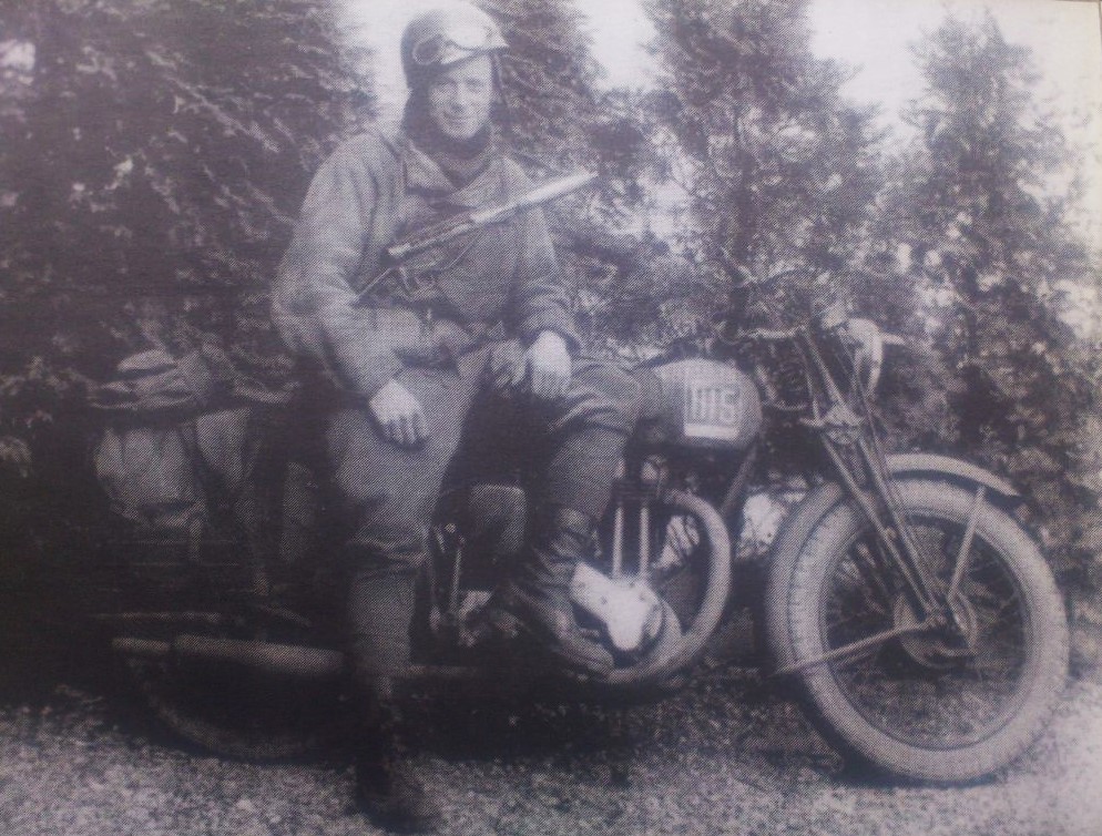

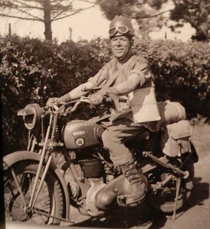

WHAT did you say ;
Original photos of Ariel are not easy to find
you get me started, just a few.... :lol:
