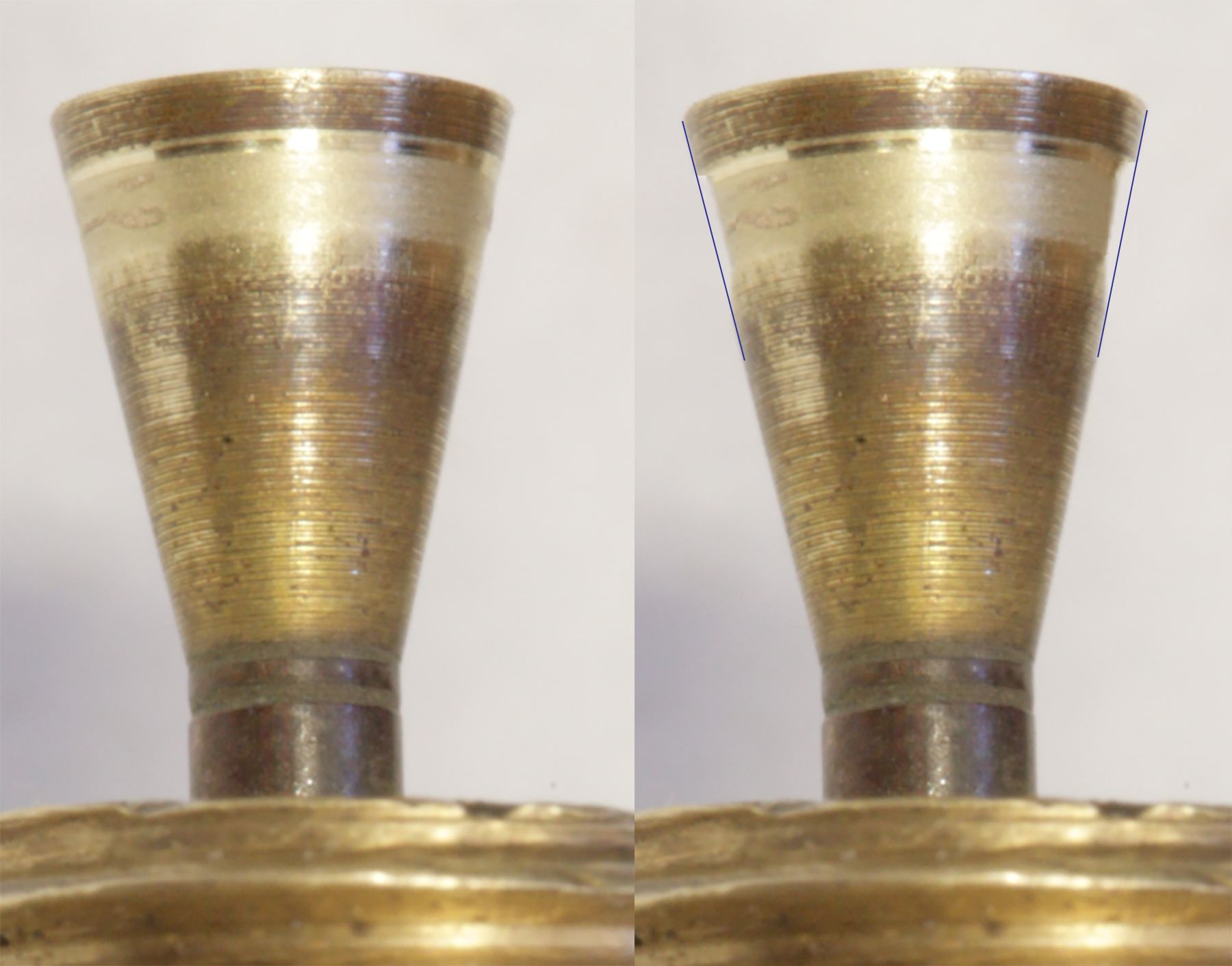

Lapping my float needle completely cured the problem for me. But, use very fine paste and limit how much you lap because, to some extent, lapping results in the effect shown at the right, exaggerated here for visibility.
I would be reluctant to try to improve things by tapping, since it will be extremely difficult to have the needle and seat precisely perpendicular to each other when you tap it, which only will make things worse. Actually, there's a good chance tapping will make it irreparable. If lapping alone doesn't cure the leaking it already may be beyond salvaging, since some previous owner might already have distorted the seat and/or needle by tapping.

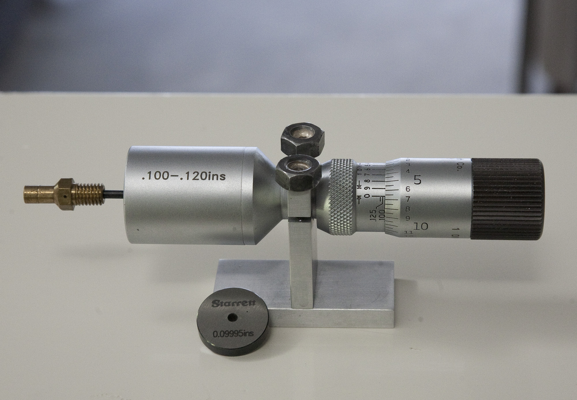

This sounds very much like the symptoms of a worn needle jet, since most riding is done at fairly low throttle settings where the taper on the needle doesn't even come into play, nor does the size of the main jet make much of a difference. The needle itself is a less likely suspect but, as noted by others, the needle jet is a wear item. Ones on my Gold Star Catalina only last ~1200 miles before they are completely worn out (enlarged by 0.0005").[*]
[*] several years ago I measured 22 NOS Amal needle jets ("original" Amal, not Burlen) and found 77% of them were fine. However, two were more than a full size smaller than marked, and three were a full size larger. A half size (0.0005") changes the fuel flow by over 6%, which is enough to cause a bike to run very lean or very rich. Anyway, I have a special micrometer I use to measure the diameter of needle jets when I install them, and record the values so that I can later check on their "progress."

Some fine metrology going on here. Mind, this is a VB, so as long as there is a hole in the jet then who cares :D
