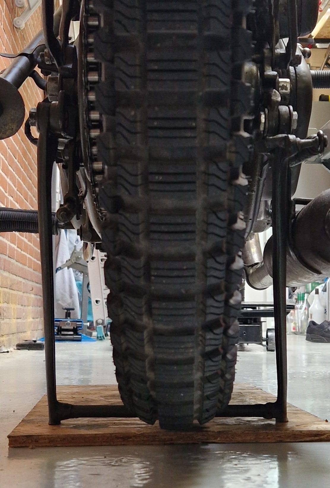

Furthermore I noticed my rear stand is fitted with regular metric nuts and bolts, wich ofcourse come loose when using the stand. So I have to look into that as well. I also have the feeling the stand isn't original, both sides seem to be straight the one in my parts book seems the be bend on one side to make room for the exhaust.

It might be an original stand that someone has straightened, thinking that both sides should be the same.
If it is original the side forgings will be quite malleable and can be re-bent.

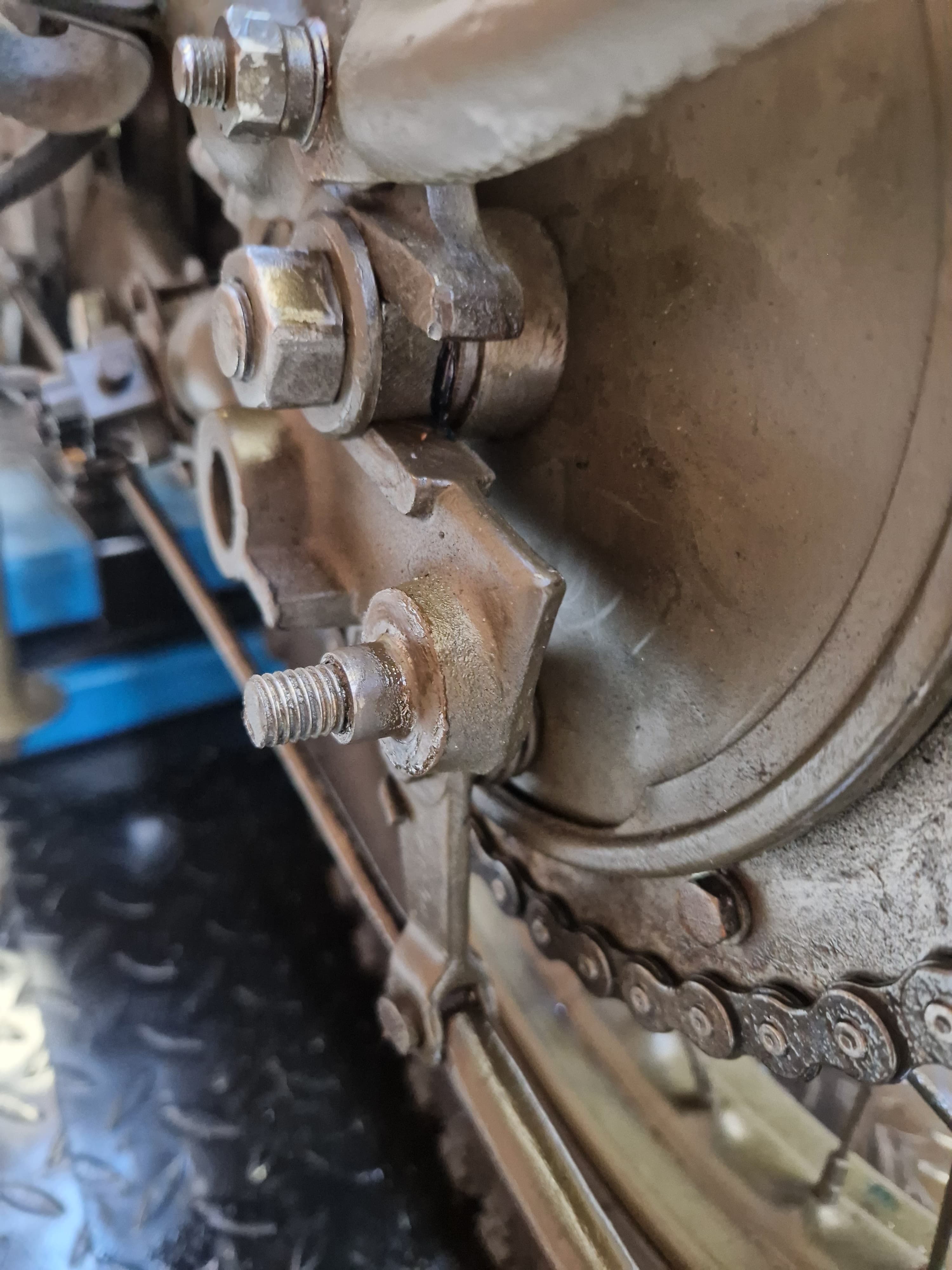

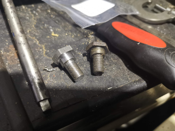

The stand bolts are not ordinary bolts - they are stepped and screw into the frame, part number E1/58 or 5505-26, like this:

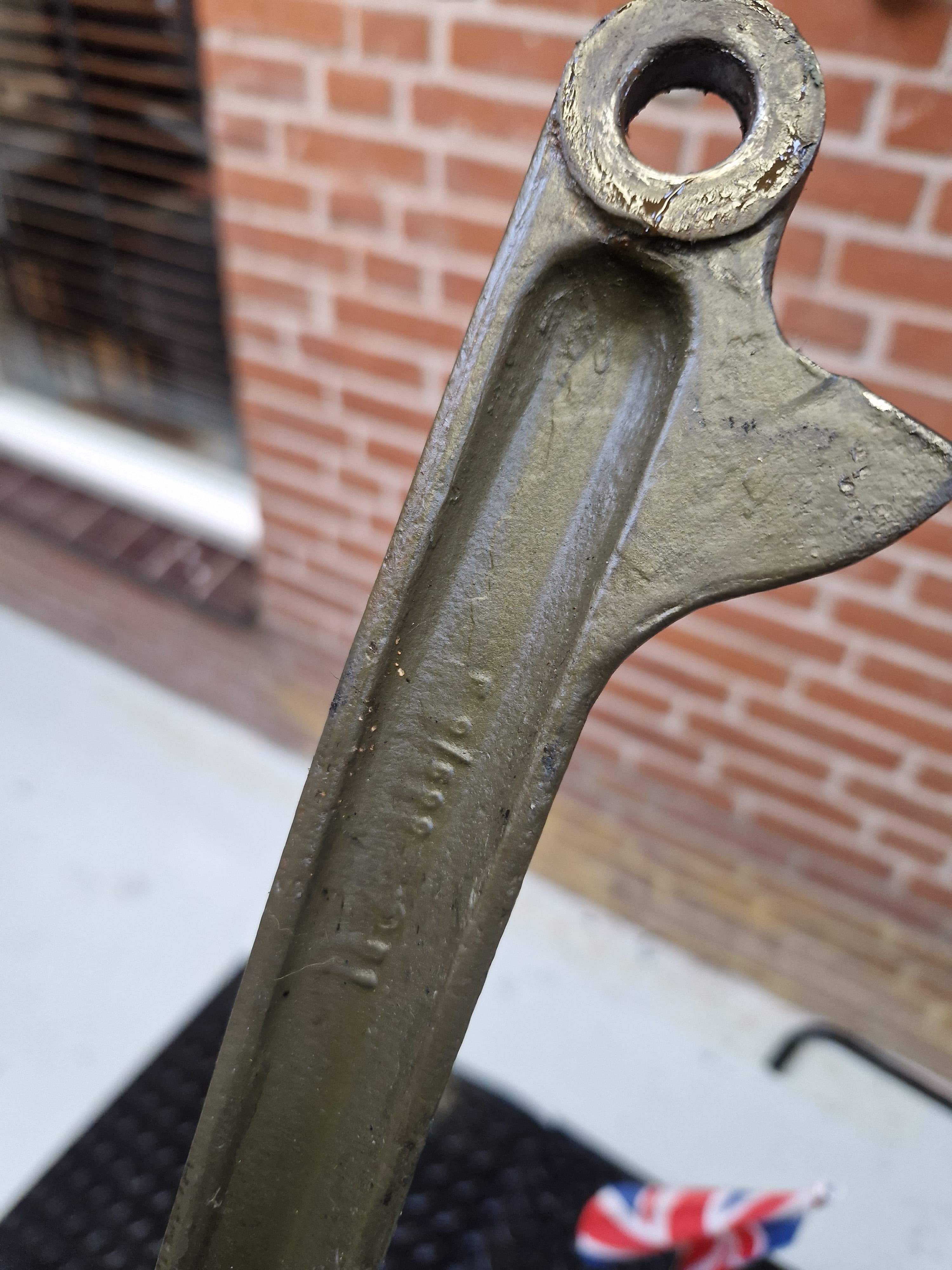

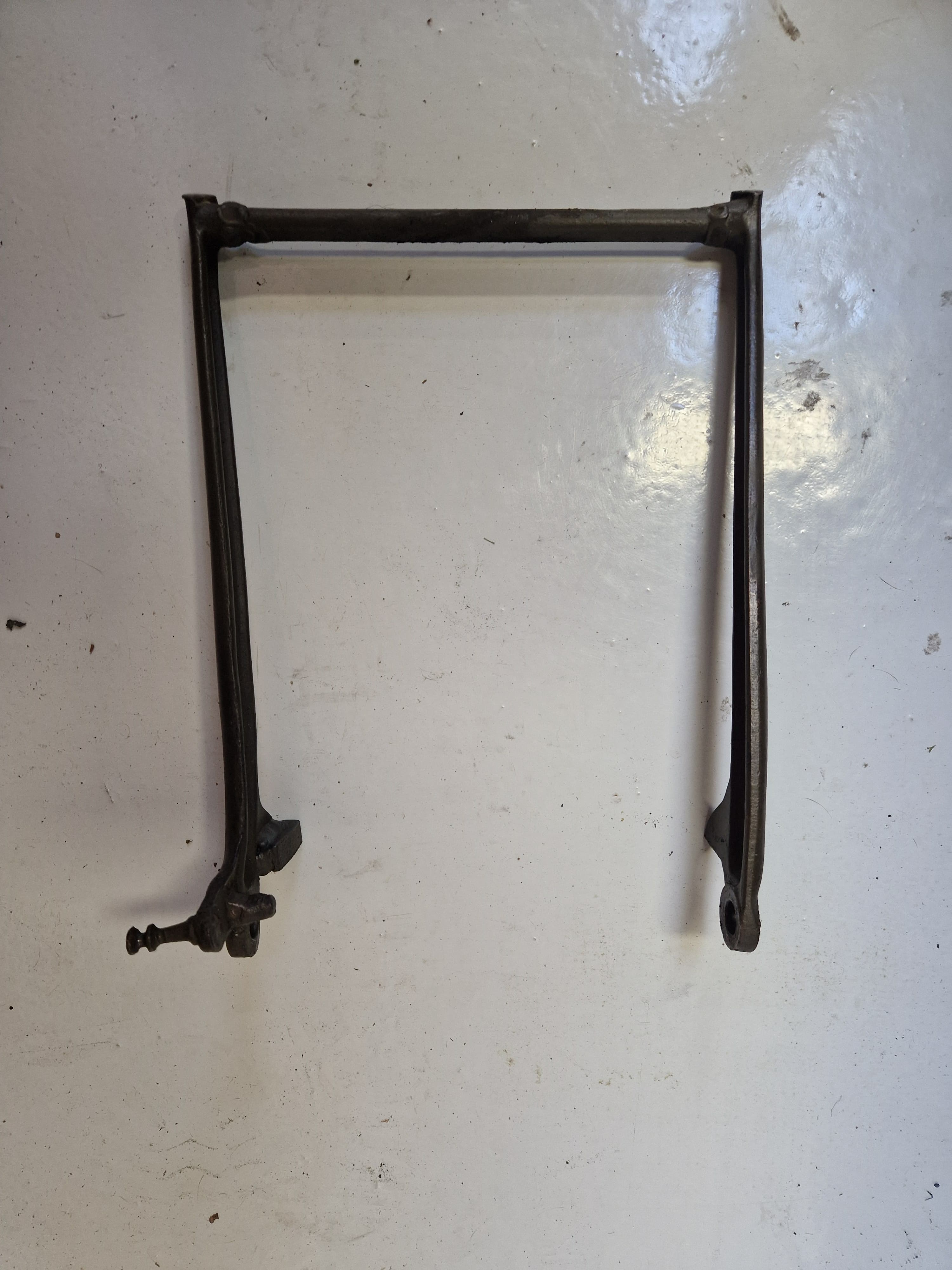

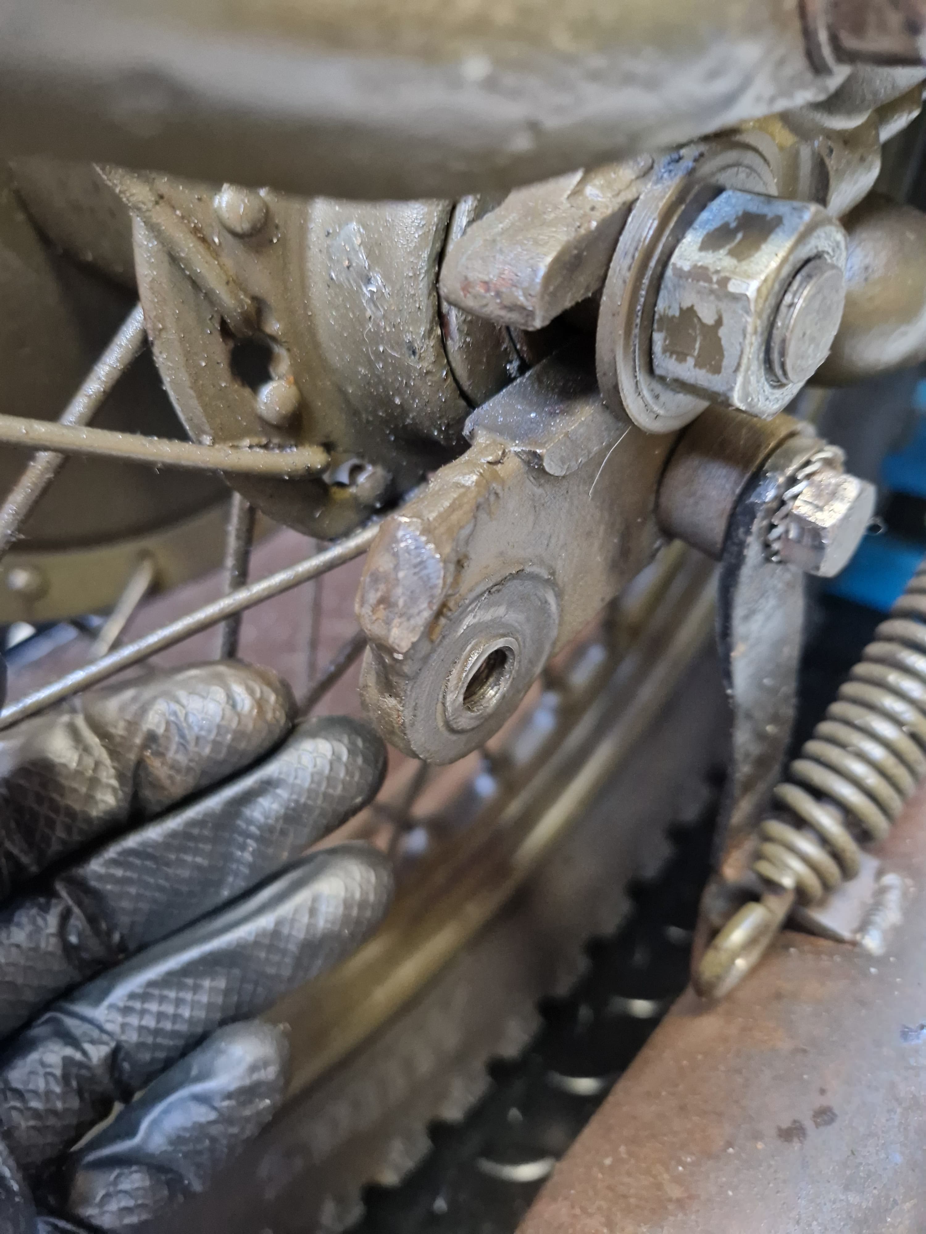

I took the stand off this morning before work, I was curious. It seems to be original, it has a casting number, startin with E9, can't read the rest (maybe E9/699?). My partsbook only specifies the 5500-36 not the E9 number. So it might indeed be bent straight in the past. I'll try to bend it back a little, is that possible by just putting some heath in it?
One side of the frame still has the support for the stand, here they've put a metrich bolt through which was made flat wit a grinder. On the other side the support on the frame is gone, they mounted it with a piece of tube and some metric nuts and bolts on this side.

You might not even need heat, just some big levers!
(There doesn't seem to be a part number - which would probably be the number on the stand - given for the rigid frame stand, even though there is for the equivalent spring frame stand.)

A word on E numbers - as far as I can tell, Ariel changed their approach to part numbering in the early 1930's. You can often find E numbers cross referencing the later style part numbers in the parts books.

I have 3 parts books. I got the proper one from Draganfly, according to the contractnumber etc. And indeed a lot of parts are cross referenced. Just not the rearstand.
I'll try to bend it without heating, might save the paint.

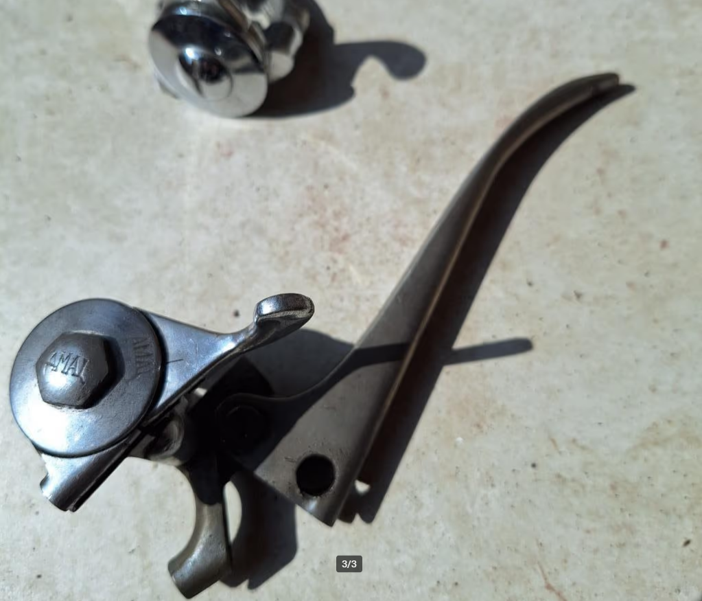

This saturday I'll pick up a combined clutch/magneto lever. Found an AMAL set on the secondhand website in the Netherlands. I know it's not time correct, but my ariel is fitted with an AMAL exhaust lifter trigger. And besides that I now have a separate clutch lever and a separate magneto lever. The magneto lever is even a right hand side lever so it looks terrible. And to be honest, I kinda like the brass trigger lever.
I found different stories about the levers on an Ariel. I read that since '56 they've started to use the trigger lever for the exhaustlifter. But also a story about them putting these on late war. At least they will be both AMAL so that looks good on the new handlebar.

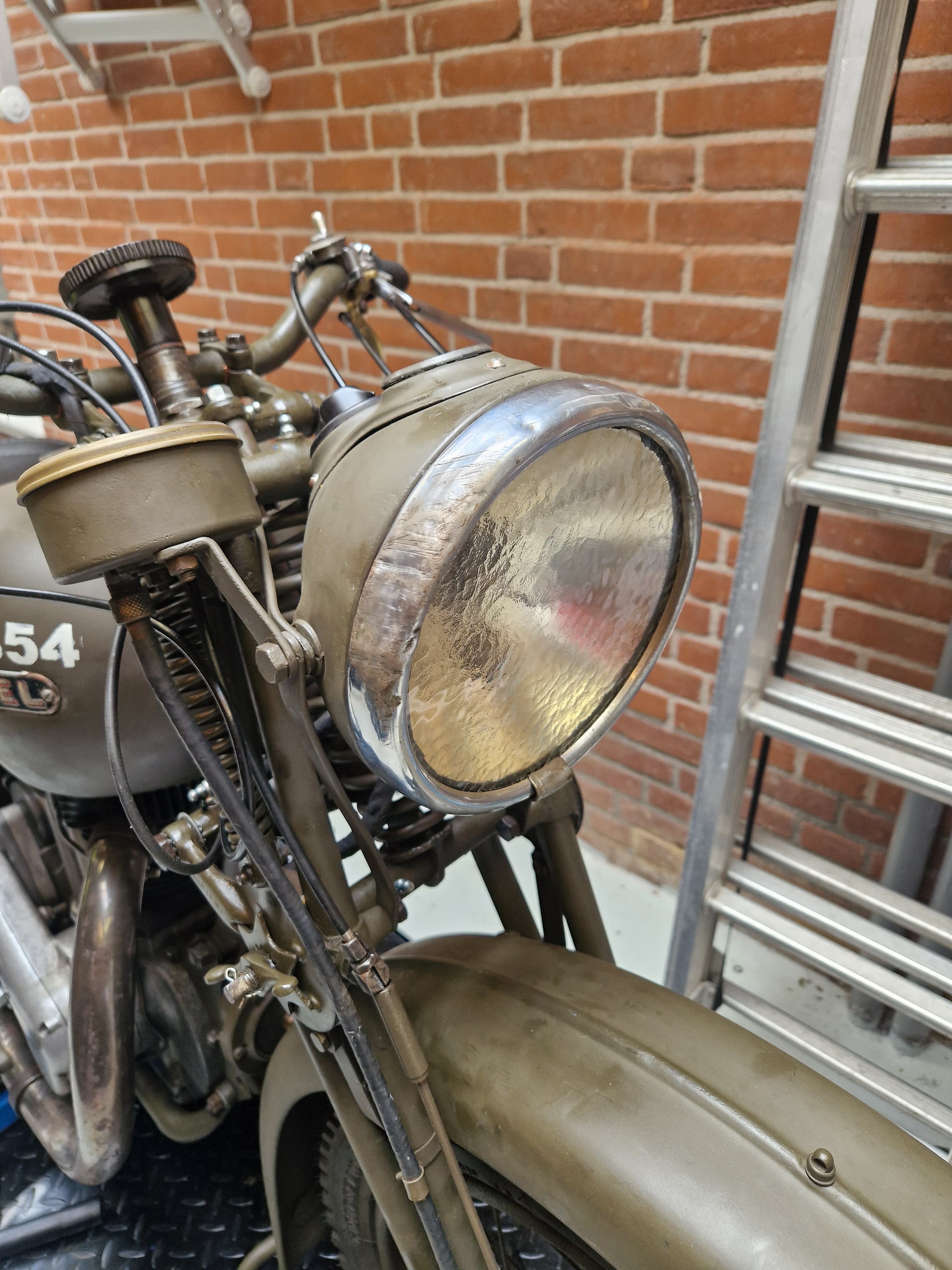

Oh and I orderd a piece of old cathedral flat glass for my headlight at a local window suplier. I love the outcome.
