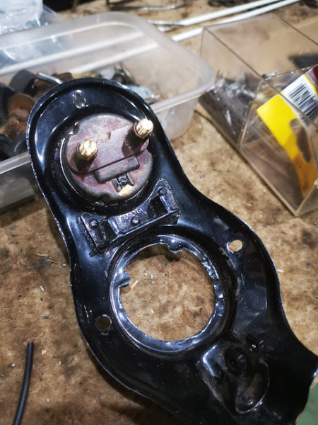

A couple more useful pictures

simon.holyfield wrote: Mon Oct 09, 2023 12:16 pm
Here you go. That's a repro ammeter - original ones don't have the clamp bracket, but are retained by tabs on the rim as has been said.
Yes that looks like mine (or at least the subpanel shape looks correct. On mine it doesn't look like a separate panel but, like you say, it might have been painted fully assembled. I'd like to keep it that way without breaking the paint so might be a bit fiddly to sort out. Not sure if my ammeter is 6v or 12v but I'll take it out of circuit and just connect a multimeter into the circuit and it'll tell me what's going on when I put a load on the circuit or start the bike. What's the ideal charging voltage for a 6v system? I can put a power supply onto the bike ammeter to see if it works under 6volt and if not I'll try it on 12v. I'll just put a couple of Amps through it. I should be able to do that with the ammeter in situ if I rig up some leads for the regulated power supply. The link looks quite useful. I suspect one of those wiring diagrams is the right one for my bike.

Right I've just had another look at it in better light and the sub-panel can be unscrewed from the main headlight housing. However, It can't be pulled out from beneath the yoke and headlight unless I unbolt the headlight and drop the loom down. However, as I'm not messing with the light switch it may be better to just take the light unit out and and work inside the headlight housing instead and then I don't have to reset the headlight beam.
I can confirm that the ammeter is the peened over tab type so I'd rather leave it in place (disconnect one side and put a test meter across to see what's going on) and test it in situ until I can confirm it is actually dead or wrong type. Looking at the circuit diagrams you linked to and, if I'm understanding it, the fact I'm seeing more than battery voltage at the battery means the regulator is working and passing a charging current across the ammeter without the needle deflecting. Without the ammeter in circuit the regulator wouldn't charge the battery. Does that sound right?
