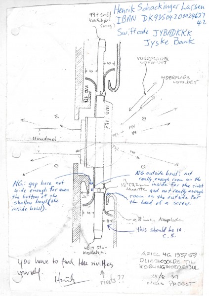

Hello David,
Thank you for posting. It seems like I might have to try to fit those discs again next time I have the primary apart on my NG. With a bit of digging I found the drawing supplied by Henrik Schackinger Larsen, a friend of the originator of the mod Niels Probst, and with it some notes as to why I figured the discs would not fit. Anybody else out there have problems fitting the discs to a single?
Regards, Chris
