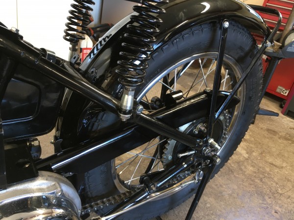

An update on fitting the upper chain guard.
The after market one I had from India had the top rear mounting captive nut in the wrong place for my bike.
It was close to the curved pump clip. Quite a way from where the mounting tab is on my rear mud guard stay.
Had a new nut tigged on and the now unused mounting hole tigged up. Some fettling/filing and painting later all mounts okay but the relief for the diagonal frame tube doesn't quite line up with the chain guard. I can live with that because if means I don't have any more tin work to deal with.
I am reluctant to say "I hate Tin Work".
Gary
Upper Guard on  Chain on and adjusted

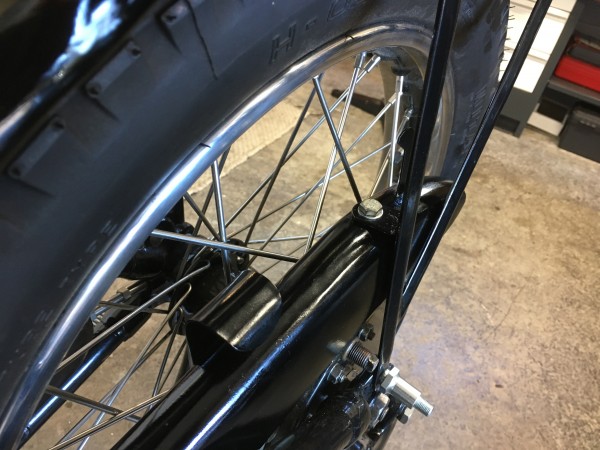

closer look at the rear mounting bolt.  CEI of course!

sorry, Picture description are reversed.

Glad you got it sorted, Gary!
