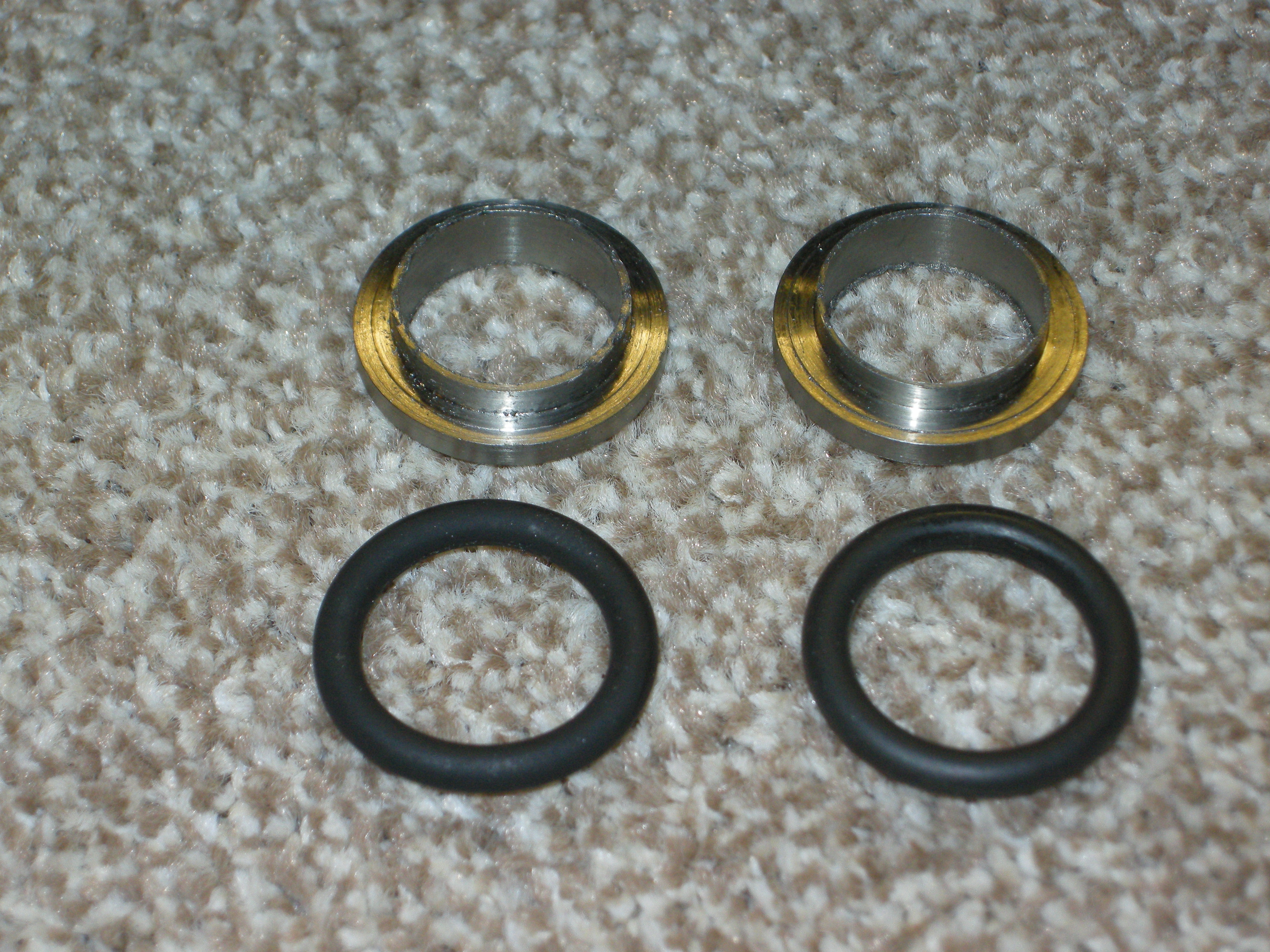

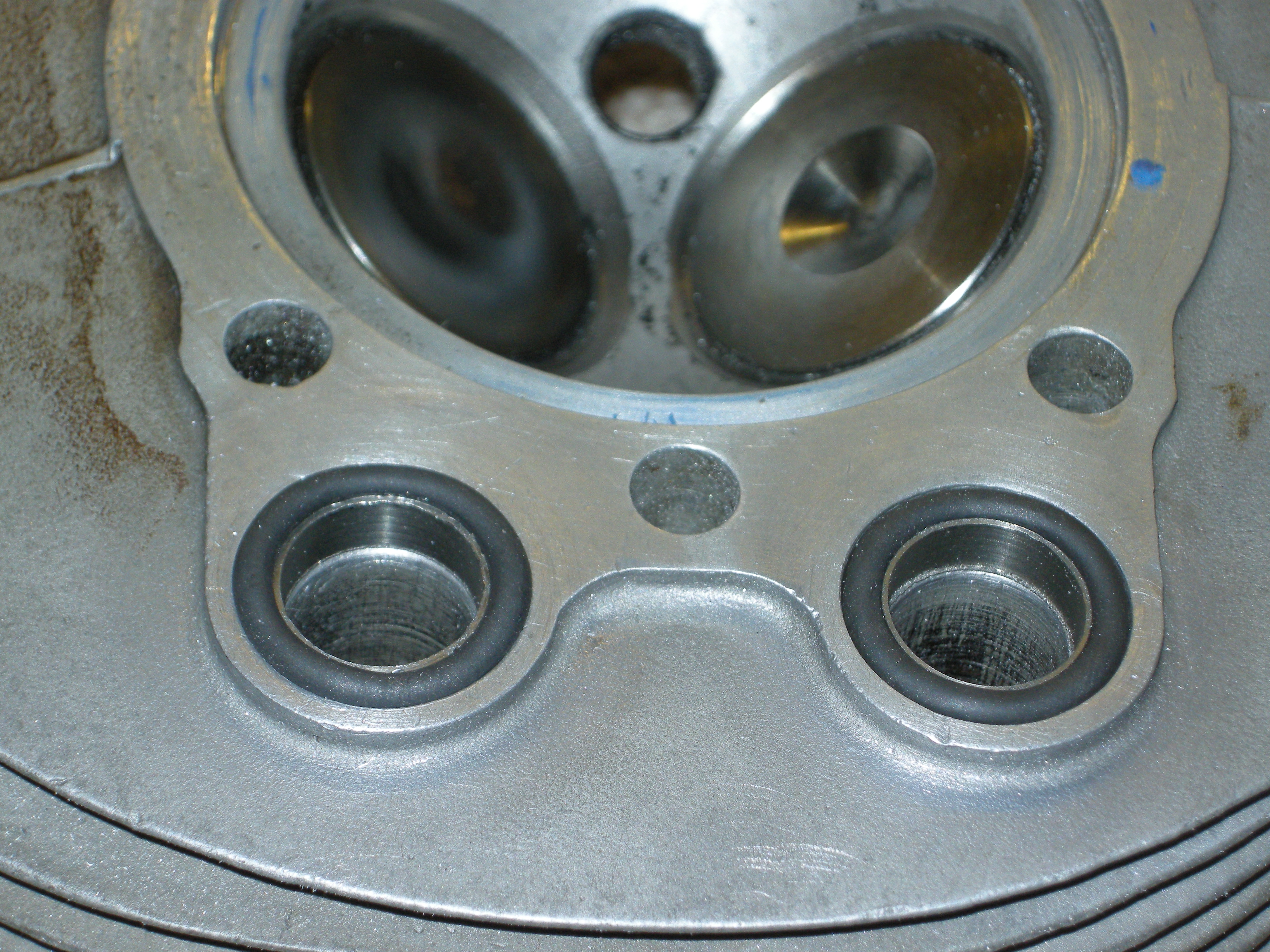

The rocker boxes drain down the pushrod tubes. I suppose one of the rubbers
could be the cause but I can't think how at the moment. On the later engines
with enclosed pushrod tubes I've had real problems with oversize rubbers
further swelling and crippling the pushrods as well as flooding the top end. Grrr
@will_currie - Sorry to be a bit 'off topic' but have you seen this mod for the later motors ??
I have done this and it appears to work for my '58 VH with an aftermarket alloy barrel !
