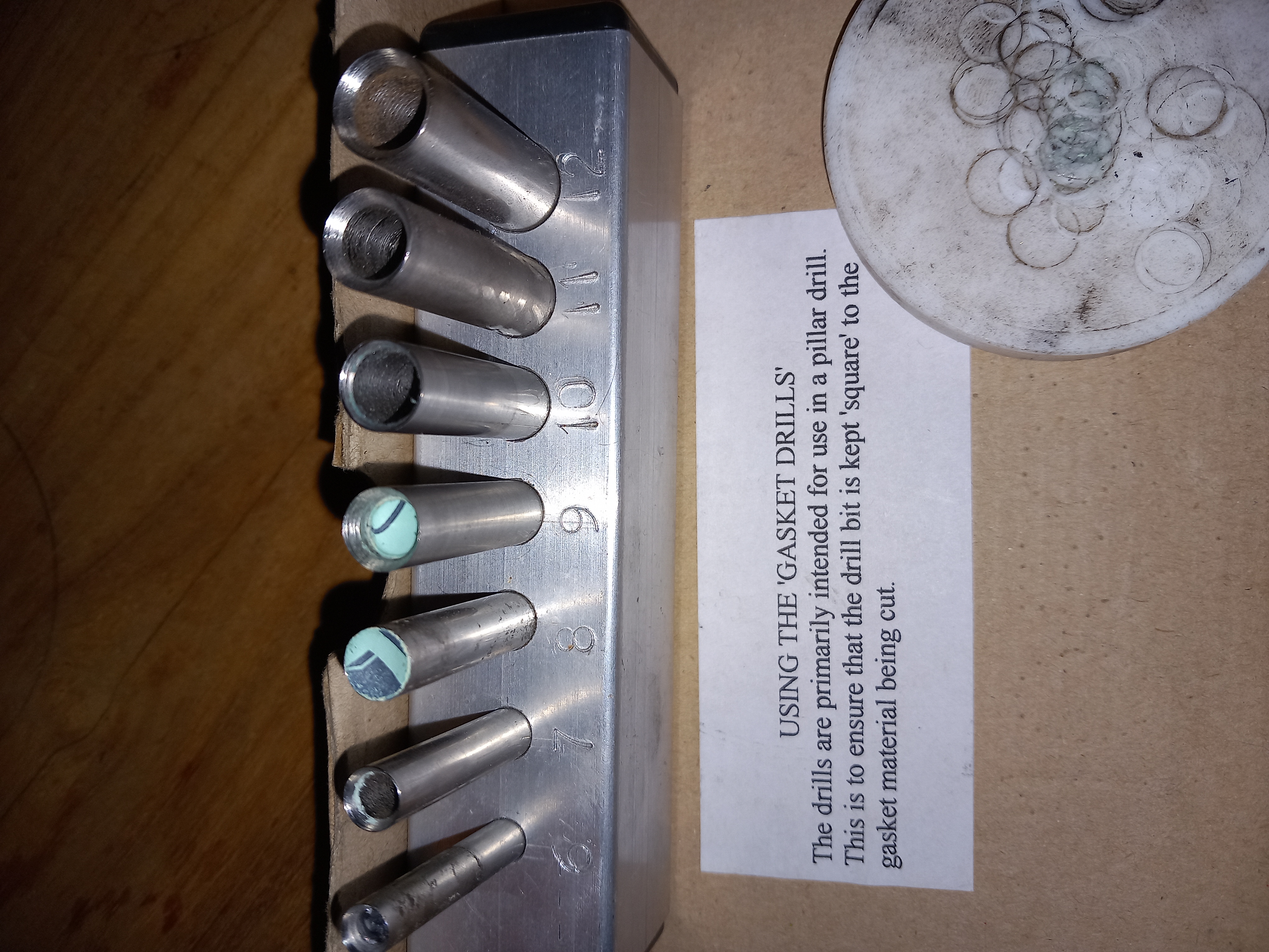

Post by daveleek »
Adam , rather than using a hole punch which tends to push the material outwards and split especially composite cork , I use gasket drills and you can make your own out of any round tubing filed inside to an outside cutting edge , or if you have a lathe even better made of steel , they are best used in a pillar drill with some plastic material underneath . The kit I bought is no longer available unfortunately
