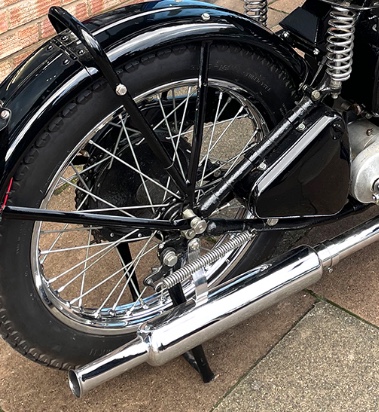

Can anyone identify the stud in the centre of the picture used for mudguard stays- is it 5654-31. Is it accompanied by 5656-41 ?
Does anyone know if it is still available anywhere, or its dimensions?
The bike I took the image from is being sold as a 1943.
Thanks
Steve

Available from Acme stainless.
Dave
Posts: 1941
Re: is this 5654-31?
I think you mean 5654-41. Draganfly have 5604-51 which is the same only slightly longer, the stainless one can be shortened without the need to re-plate.
