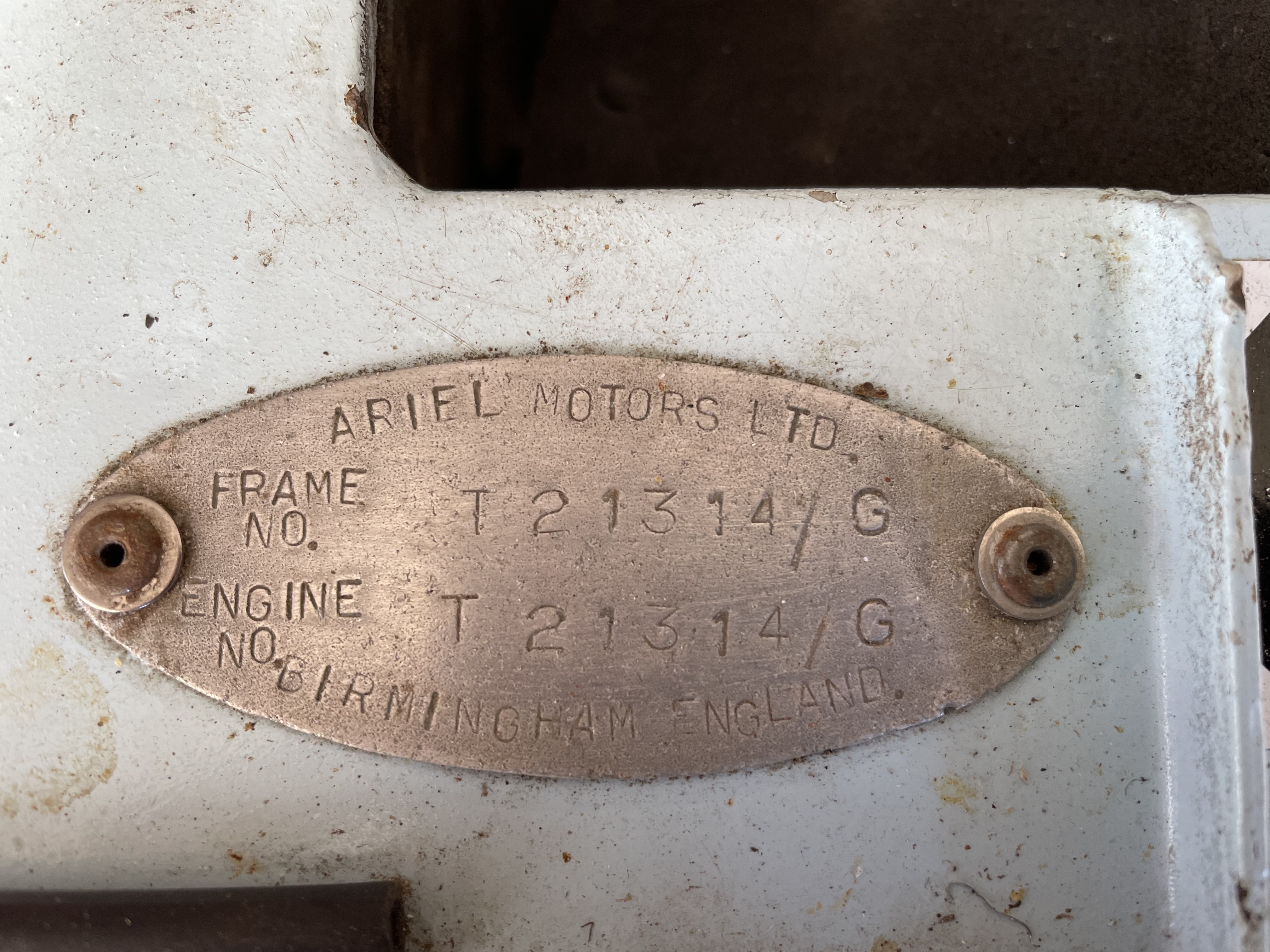

Having been caught with buying a arrow sports in boxes only to find out I had a Leader engine and Frame but a lot of Arrow part. So I did not give up and now own a complete 1961 Sports arrow which runs but needs a repaint and new silencers. All good so far I have a V5 with the same engine and chassis numbers T21314/G. Just started to take it apart only to find the frame looks like the leader one I have! The paintwork looks original and overall the bike is in good condition. So can anyone tell me if its correct or have again been done! See attached Photo

Mmm. I've never seen a VIN plate quite like that before, nor have I seen one
positioned where that one seems to be.

Thanks for your reply this is what I thought a bit fed up but trusted the V5 and vin numbers also the paint does look original so I assume Leaders were also finished in Admiralty Grey. It would be interesting to know the history of when and why the frame was changed, the Vin plate looks like its been there for some years and not a recent addition so all this may be 40 plus years ago!The photo gives a distorted view of the mudguard I have a good 2 inch gap but noticed a small crack on the Engine mounting lug of the frame which I will have a closer look at when I strip it down. At leased the engine looks original with a Amal 376 carb. And the chain guard is good. I would like to get it back as original as possible and unless I find another frame consider modifying the existing one.

The VIN plate is definitely home made
