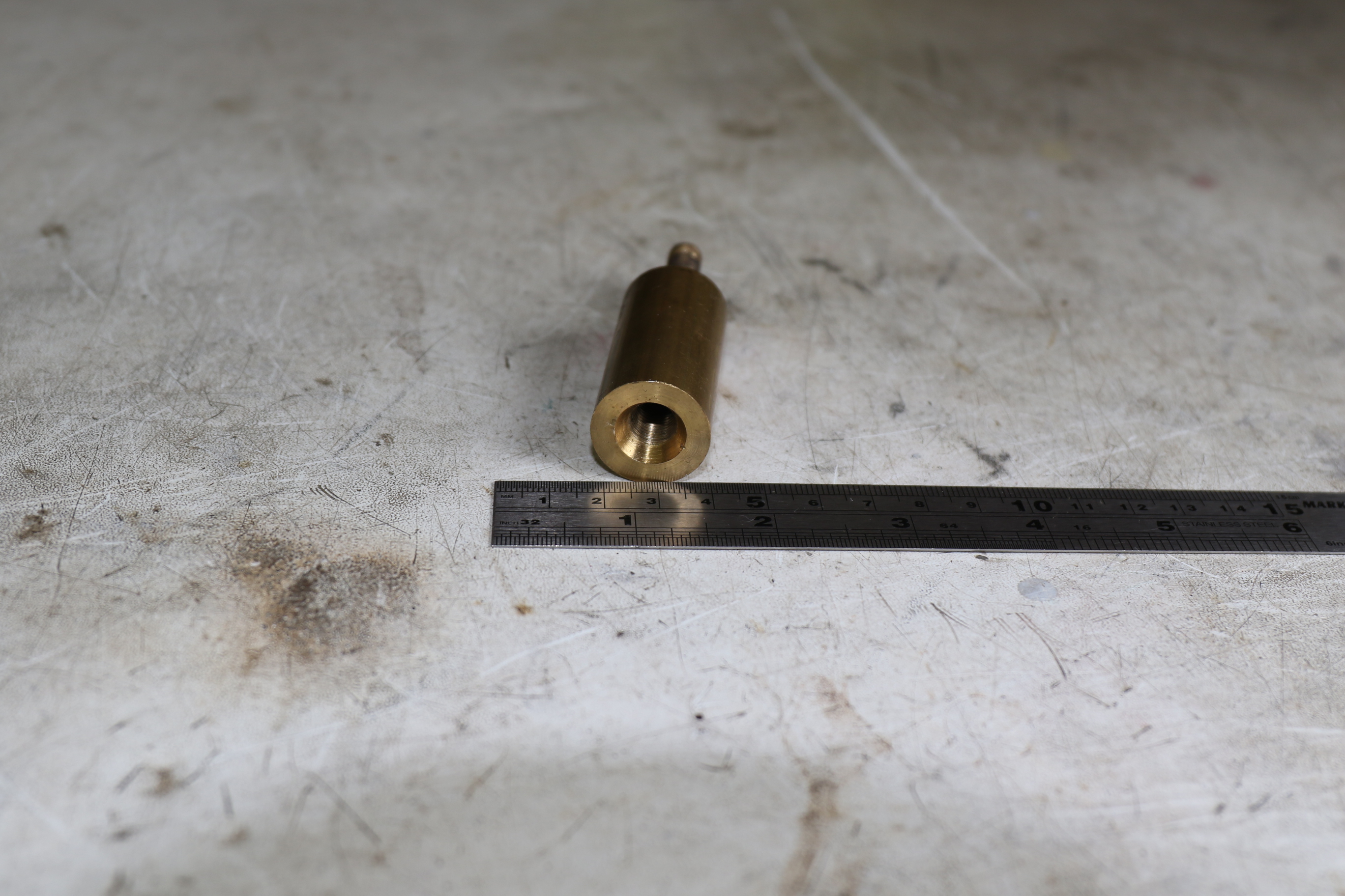

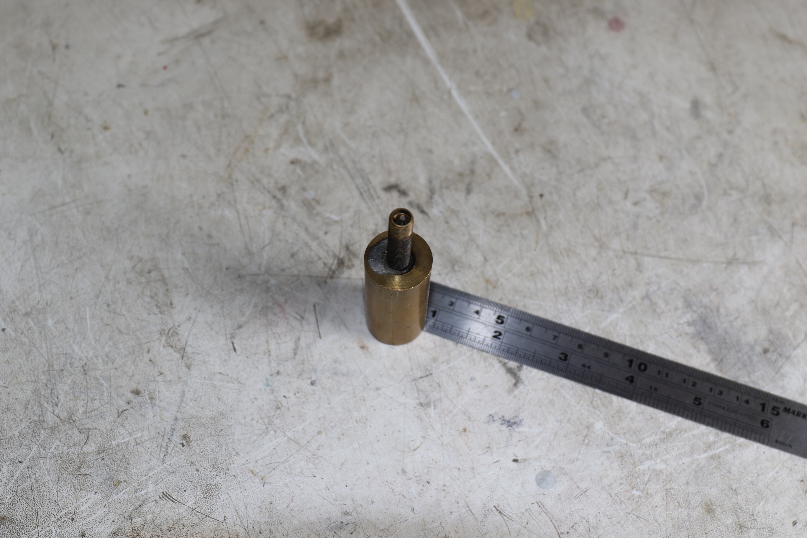

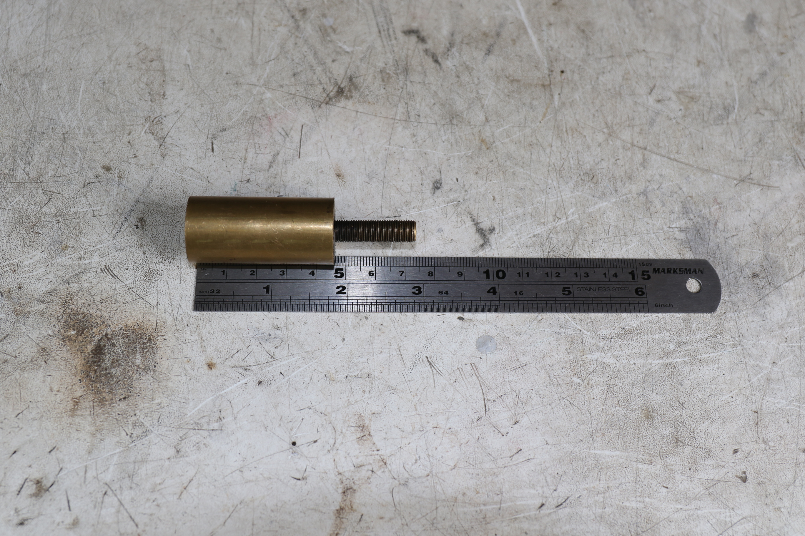

The test rig is a piece of 7/8" brass rod about 2" long with a hole down the middle. At one end the hole is widened out using a centre drill and tapped to take the pressure relief valve. At the other end I have soldered in a valve stem recovered from an old inner tube (with the valve removed during soldering, of course). The hole down the middle is the tapping drill diameter for the pressure relief valve for most of its length to maximise internal volume.
To use, I simply screw the pressure relief valve in the end and apply air to the tyre valve using the inflator on my compressor. You easily get a good idea of when the valve opens and also if it tends to have a constant leak. One of the old valves I had did seem to have a constant leak - it whistled at all pressures, most unlike the other valves I had and nothing cured that. I tried a new ball, a new spring, re-seating the ball, etc but nothing worked so I binned that valve.
