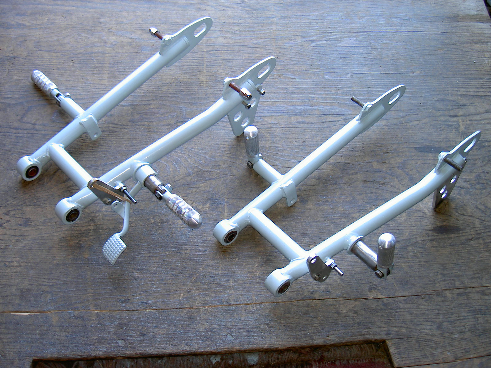

Simon, I do have a 'tame' swinging arm straightener, unfortunately having just spoken to him about straightening one for you, he can't, he cannot take on anymore work, he simply has too much on at the moment, he sends his apologies. The attached photo is of two Round type swinging arms that have been converted for rear set operation similar to how the Ariel Factory did it in 1961 for the Arrow Production racers that they made for Dealers who entered them in the long distance races, the Thruxton 500 miler and Silverstone 1000. As regards adding extra gussets, the most common way is to add a plate top and bottom of the front cross member, sometimes boxed in, the attached picture shows the style, this is a cardboard template that gives you an idea of what its like, note though this has an 18" wheel, the standard 16" wheel wont be so close. others add gussets down the sides also as per the third photo, perhaps not really needed but they are just making sure on their racer it wont twist. You will only be able to add the gussets at the front on a road bike if you are prepared to shorten the length of the inner mudguard, for a road bike go for a Round swinging arm and you should be o.k. Jess

The racing versions look good, may copy that but thinking it’s not so efficient to have feet on the moving suspension!
Think I might also angle the footrest pivots back to 45 degrees so they could fold up in the event of a spill...
I’m intrigues as to the purpose of the piece of Swiss cheese on the left side below the axle location?

To be honest Ivor I've never found it a problem or concern to be using the footrests on the swinging arm, only on very rough surfaces do you become aware of the swinging arm moving up and down and then its only slight, your knees tend to automatically pivot your lower legs. That said you are stuck with the height they are at, some riders prefer a higher footrest, others a lower footrest, some further forward others further back, that is something you can account for when making brackets that bolt onto the crankcase for the rear footrests. Regarding rear footrests, to pass scrutineering both race and parade bikes have to have fitted non folding footrests so that they don't fold up in the event of a spill, my Salt Arrow failed scrutineering first time around as I didnt know this with it having folding footrests got it passed when I was able to show them by tightening up the nut and bolt that it was sufficiently tight not to fold up. Regarding the alloy bracket plate at the rear of the swinging arm, again this is an A.C.U requirement when racing and parade riding to have one fitted, they are known as, a Sharks Fin and is there to stop your foot getting trapped between chain and rear sprocket in the event of a spill. This is the Sharks fin on my Cafe racer. No set design as long as they can be seen to be capable of doing the job. Jess
