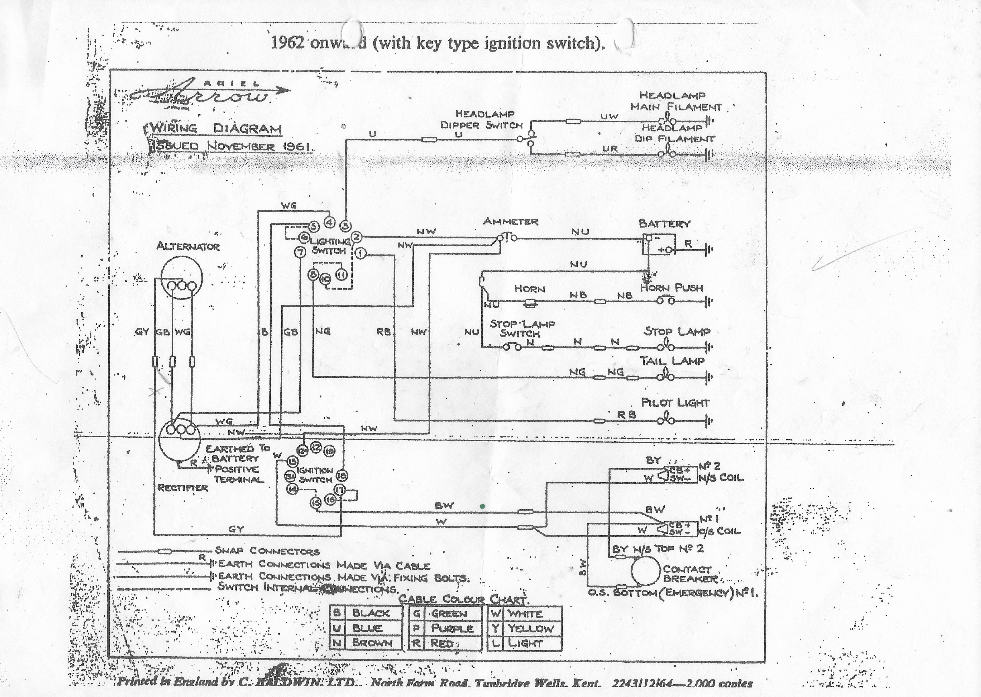

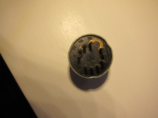

I seem to remember that the two different wiring diagrams show the hard links (brass tracks) between some of the pins on the back of the ignition switch. These hard links are different between the two types of ignition switches. You can use the wiring diagram to determine if the ignition switch links are correct. The ignition switch should be the key type for your year of bike.

Please see attached a photo of the back my spare ignition switch showing the brass tracks connecting pins 14 to 15 and 16 to 17.
This is shown on the attached wiring diagram as dotted lines between the switch pins.

Thanks for the wiring diagram. The switch you show in the picture is exactly the same as the one that came with the bike, which eventually stopped working. The new one I have fitted, is quite different. I intend to check my wiring against your diagram. I have limited time to work on the bike at the moment, which is making progress slow. Today I wanted to prove that when the head light was on there was a connection between the ignition switch and the head light switch. to make sure that when charging the head light would get the increase in power. On your diagram it would be between 5 and 10. Unfortunately there isn't much room for the wires and my hands in the head light shell and trying to test the switches I dislodged a wire, which prevented the whole system from working. I spent the rest of my time trying to trace the trouble. Still a little more work to do before i have solved it.
John
