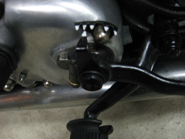

What I ended up doing I made a position indicator out of a bit of sheet metal as per attached photo. I got the exact position of each gear by moving the gear selector lever slowly by hand and carefully rocking the back wheel to make sure it was properly engaged. Once made and assembled I found when doing a test ride sometimes everything would select correctly but more often than not it was over-selecting as you suspect with yours so it had moved out of the detent on the selector shaft in the box to an unstable position. Mine would misbehave going from 4th to 3rd and the indicator showed it up immediately. Occasionally it would also mis-select 3rd to 2nd. You can make it mis-select with the bike on the stand and hand selecting. Try it moving it fast and also slowly. You will probably notice a difference and for sure you will see it fail to select correctly. It is as you suspect the wear on the spring box. It was a bit hard to work out how much it was worn and I had a couple of attempts at building it up before I got it correct. The good thing is you can do it in the bike.
Since my last repair it has been perfect. I left the indicator in place as it's sometimes handy to glance down to see where you are and to just check all is well.

BTW Murray, the selector indicator looks great - Worth keeping on the box even. I meant to ask what you built up, I assume the Alloy of the selector box? This looks like what we call Muck-metal, can it be built up? Graeme
