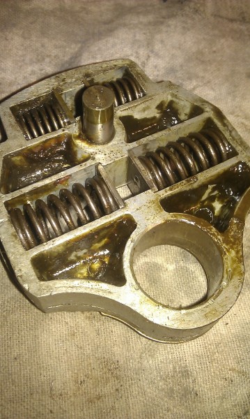

Re: BA gearbox not selecting 3rd very well
I've seen a few issues relating to the spring box:
1. Cracks in the casting - they do not appear to be very strong, and crack around the hole for the operating peg
2. Loose - rotation or rocking operating peg
3. Collapsed springs
4. The little plates the springs bear on - I have seen them stick in their slots due to burrs
I've also seen the three rivets in the quadrant assembly loose:
