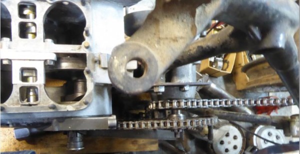

Well this has been interesting. Here is what I think/have found out so far
1. The Sprocket is as noted by Roger, dished such that teeth are canted towards the Engine by about 6mm but the boss of the Sprocket is about 3.5mm leaving a net dish-effect of about 2.5mm. I have looked on the net for a ½ inch pitch 26 tooth Sq sprocket but no luck. I looked to make the sprocket from a blank but the blanks here in NZ have a 70mm boss and you need at least 80mm on the boss to allow the non-boss side to be machined out to leave the raided boss and the offset teeth. I cannot locate a Duplex sprocket due to Covid created shortages but I think one could turn the boss-side teeth off and that would leave enough meat to provide for the dishing on the other side without weakening the sprocket.
2. I am going to use a SQ4 23 tooth sprocket and use a clutch sprocket minus 4 teeth to give me much the same ratio (Thanks to a kind benefactor in UK for the sprocket!)
3. If you do not have a Sq4 gearbox shell you need to remove 9.5mm from the Clutch side of the gearbox lug top and bottom and make a spacer for the other side of the lug to keep the box snug between the engine plates – I will try to attach a picture. I have screwed the spacer to the gearbox case to facilitate installation – I have not welding skills. Imis-measured the first time and removed 7.5mm from the lugs, made all the spaced only to find a needed another 2mm to align the chains. Of course the mainshaft if the 1/2inch longer version as well.
4. The Cush sleeve I have with the raised sprocket hub is Huntmaster. One can tune the raised hub off the end up with a Sq4 Sleeve. The Huntmaster sprocket/sleeve cannot be used as it has not enough dish effect but if you were making the sprocket then with some care it could be made to used the Huntmaster sleeve if a Sq4 sleeve cannot be found.
5. The cush Spring cap seems to be unique to the SQ4 – well it is not the Huntmaster shape or the shape of a Single but fortunately I now have one.
6. The cush spring seems to be shorter than any of the 5 or so that I have. All mine would require the spring to be considerably compressed in order to start the nut which given my experience with the VB and the Huntmaster seems not right.
7. My chains all align now, time to find some bearings and complete the gearbox.
Pics below of spaced our gearbox
