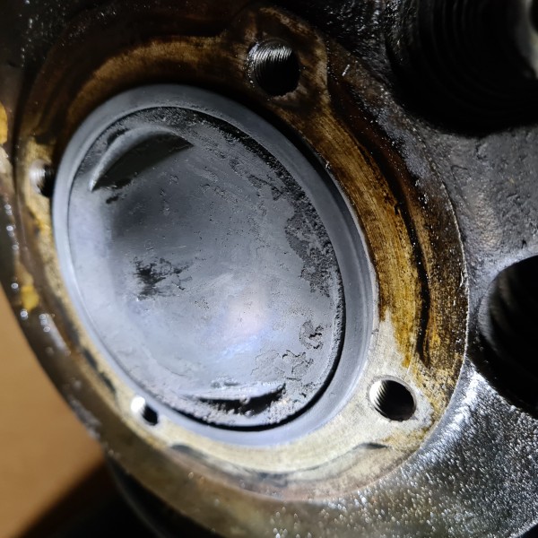

Newbie question again. I have the head off my NH to change the gasket. The bike was running very rich so the cylinder head and valves are a sooty mess (see pic). I'm thinking of taking the barrel off to paint it as it's showing some rust and otherwise check all is well underneath. It also occurs to me that the oil purifier bung will be easier to access from the top. The handbook advises against taking the barrel off when de carbonising as you will loose compression once reassembled as, I think the piston rings will not be quite as snug. The question then is it worth doing, is the loss of compression likely to be that bad? Could I mitigate the potential problem by acquiring new piston rings?

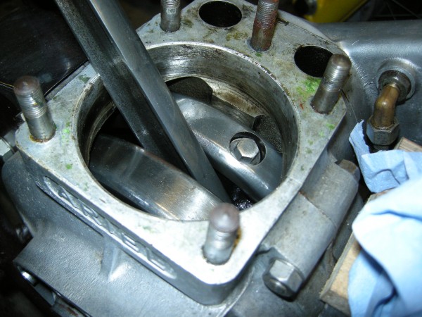

Many thanks! All went well but just to check the bolt in the centre of the pic below is the sludge trap? I got a socket on it without adjusting buy its very tight and don't want to damage the flywheel. Is it a standard thread?

Re: Barrel Off NH
Socket I'm using is 3/16 WW which seems to fit...
- Posts: 5147
Re: Barrel Off NH
Is it a six sided socket? If so, give it a go, that's the sludge trap. Pictures here:
http://ariel-square-four.blogspot.com/2 ... r.html?m=0
- chris.shearwood
- Posts: 703
Re: Barrel Off NH
As with many bolts like that (old Volkswagen wheel bolts come to mind) a sharp blow on the head of it will loosen the threads enough to allow unscrewing.MikeHenstock wrote: I got a socket on it without adjusting buy its very tight and don't want to damage the flywheel.
