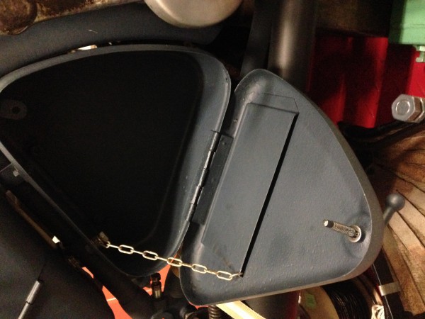

and one from Vincent:
Vincent's toolbox
Vincent's toolbox
Vincents toolbox doc holder.JPG (59.37 KiB) Viewed 20570 times

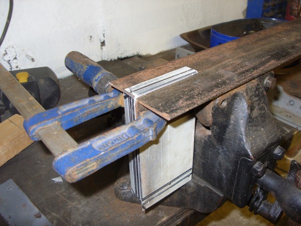

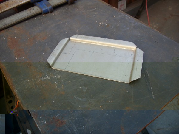

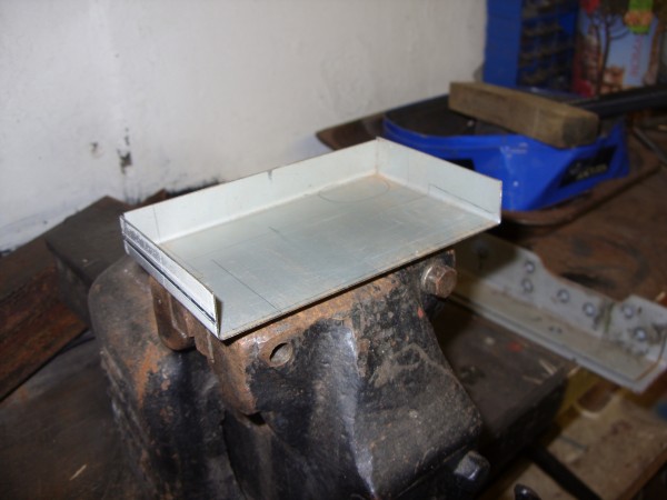

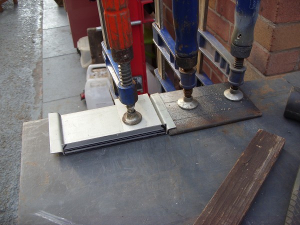

I made a cardboard template that fitted into the flat part of the lid and then, using my stock of old desktop computer cases, I made up the holder using a couple of lengths of angle iron to do the initial bends and some 1/4" plate to form the second bend.

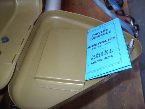

It was fixed to the lid with some very sticky, thin, foam, double sided tape.
I assume it was there to take the WNG 'Drivers handbook?'. I should have checked the size first!! as one I found on the internet said it was 144mm long and my 'slot' was only 125mm ;) . Still I've printed one off to fit :D .
